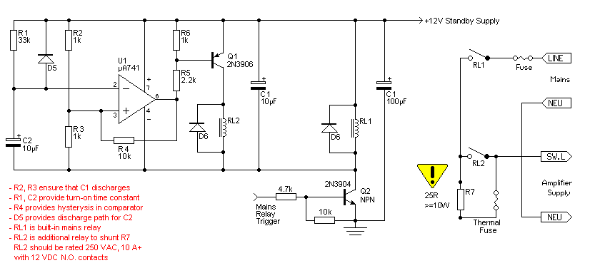

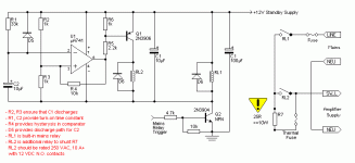

I have built soft-starts for my home theatre receivers using the circuit below. This is a modified version of one of the soft start circuits found on Rod Elliot's ESP pages. I modified it to use the existing 12V standby power supply and logic-level trigger signal in the receiver. I use a single ordinary 25 ohm, 10 W ceramic coffin resistor, which doesn't even get warm in use. I used R1=47K in my circuits, giving approx 0.8 second start time.
This is a more complicated circuit than many others, but it has important features great for toroids... it will dropout very quickly on a power blip, and the soft-start time is just as long following that as any other instance. An NTC thermistor, or the simple soft-starts that use a slowly charging capacitor on the secondary to power a relay, will not have either of those properties. That means that if your power "hiccups", your toroid will thud and draw a surge current just as if the soft-start wasn't there. The active circuit will however soft-start the toroid in this case, just as always.

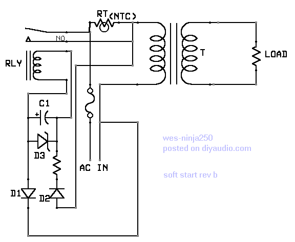

Hey, this may be an insane idea, but I thought I'd throw it out there anyway.
Comments? The goal is to have "hard wires" once the soft start procedure is complete (enough). And to have a circuit simple enough for me to understand!
Immediate flaw -- there will be a very small period of time (during the switchover) where there is no current supplied to the transformer. Hopefully capacitors down the line would absorb that. Or maybe use a "make before break" relay.
Obviously values for the components are somewhat critical.
BTW, I got the idea from my motorcycle's junction box... the headlight-on-only-after-start circuit.
Wes

Normally in a soft start circuit, the contacts only short out the thermistor or resistor. The AC is applied to the resistive element all the time with the contacts across the resistive element. No interrupton of current then. We would also use a fixed resistor, not a thermistor. That's entirely up to you.
-Chris

Hey Wes,
Nice to see you lurking around here. I'm "CapJohn" from the Ninja250.net forums.
I'm doing the layout for my power amp now. When that's done, I'll work on my soft-start board. Like Richieboy, I find the thermistor method too crude. My goal for soft-start is not only as soft-start but to reduce AC wiring (i.e. no AC wires to multiple devices and from back to front of case). Schematics done, no layout yet.

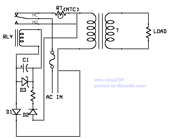

Chris --
Oh ho, of course! Short out the thermistor with the relay! See attached revision.
The NTC thermistor is critical here, as it allows a smooth voltage rise in the transformer; then when the voltage is high enough, the relay kicks in. Once the relay kicks in, the thermistor is out of the picture; the relay stays on by virtue of it being on. Very appealing in a self-excited sort of way. :D
I think this circuit would work if tuned properly; one concern I have is if the transformer's output voltage isn't linear during core saturation, the circuit will turn on prematurely.
CapJohn --
Hey, good to see a familiar face! Now you know why I haven't been posting much... to busy building my GainClone! I thought the amp part was going to be tricky; turns out the hard part is the freakin' chassis!! If I tap another freakin' crooked hole, or break another $4 drill bit, I think I'm gonna scream. :)
My (untested) dislike to the thermistor startup is about the same as Richie's -- I'm concerned that there will be a delay turning on full voltage when the amp has been idle, and that it will add extra noise or choo-choo-ing in the system.
My *like* for the thermistor startup is the symplicity, and zen-like nature: it's on when it needs to be on.
These are the two issues (aside from cost and part count) I tried to address in my circuit.
Wes

Now to simplifiy the circuit more and protect from other problems ....
The relay runs off the secondary DC supply. Resistor as required to limit the coil current. The best part is that if you have a short, the secondary voltage may drop enough to drop the relay out. The resistor then acts as a fuse and opens. Of course the relay can be opened with a protection circuit as well.
-Chris
