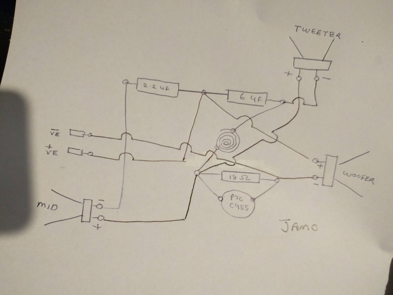

CliffR52 said:
Was my drawing accurate and did you find a polarity issue with the current wiring?
Your drawing was in accordance with your description in post #46. Also, the photos shown do not conflict with it even though we cannot see the drivers themselves.
The coil was in error, the drawing is now corrected.
Cliffs original drawing is the factory intended way to do this. It does make a difference. Changes should be for a good reason.

@ Cliff.
I would simply short out the protection circuit altogether by soldering a length of wire across the 18R//PTC combination.
The effective removal of the protection circuit will have no significant audible effect in relation to this simple crossover. If you don't believe me, wire 0.8 ohms worth of resistance in place of the protection circuit and do a comparison.

This is Cliff's first post can nobody read ?
The decision to eliminate the Thermister was based on previous advice.
The thinking behind it was that a 30 - 40 year old thermister might not be functioning correctly and possibly be compressing the music signal.
If I couldn't source a replacement it was thought it best to eliminate it.
But if a source is readily and cheaply available then I thought it's a good idea to fit a new one. The thinking behind this is, that Thermister might become problematic with time, a brand new one would see me out before starting to play up.
Don't know your thoughts behind the thinking.
Can I still run with your second schematic but just add the thermister in parallel with the 18 ohm resister??
thanks
Cliff
PS: Sorry if there's been rework on your part due to my typos.

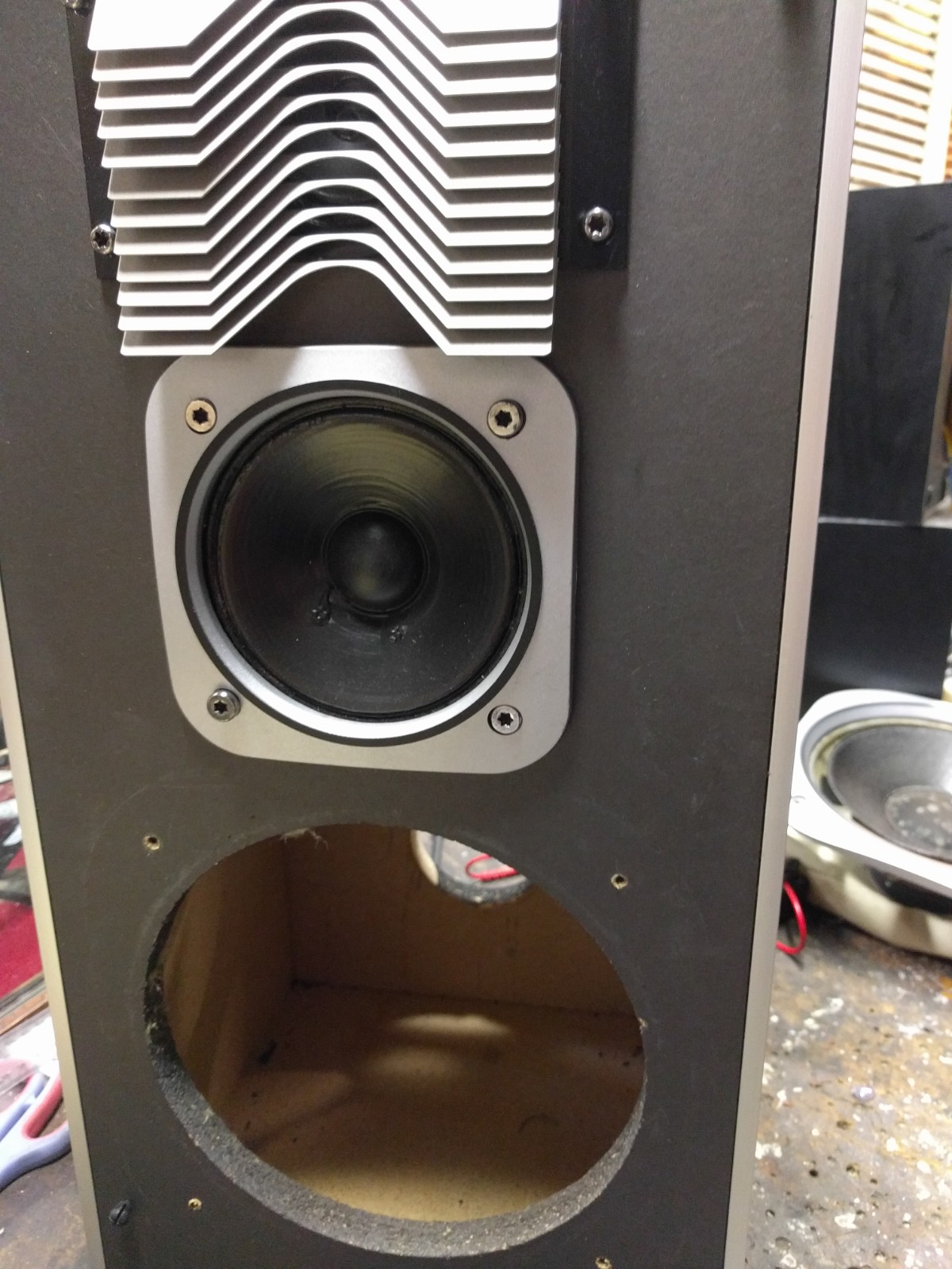

Thanks for photos.

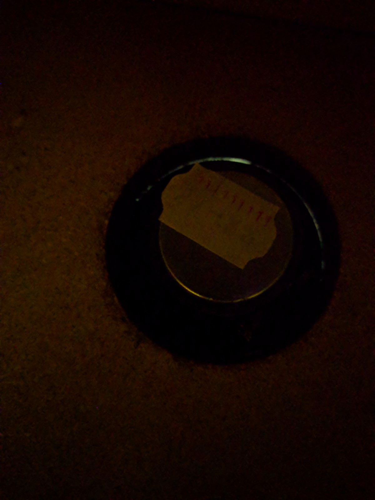

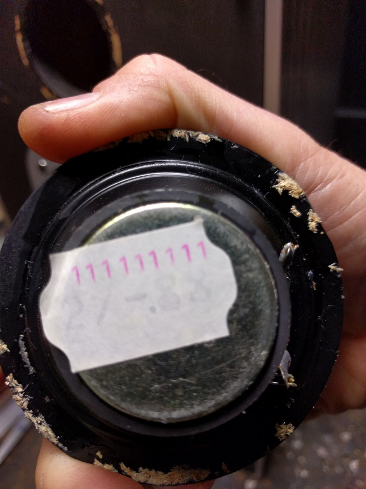

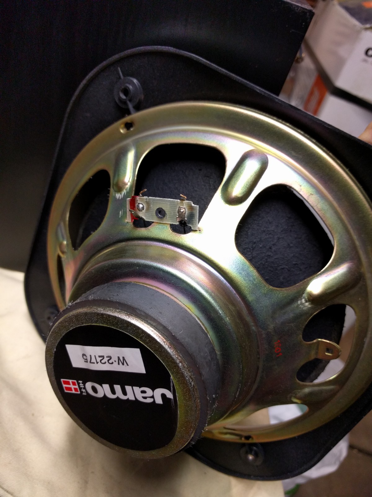

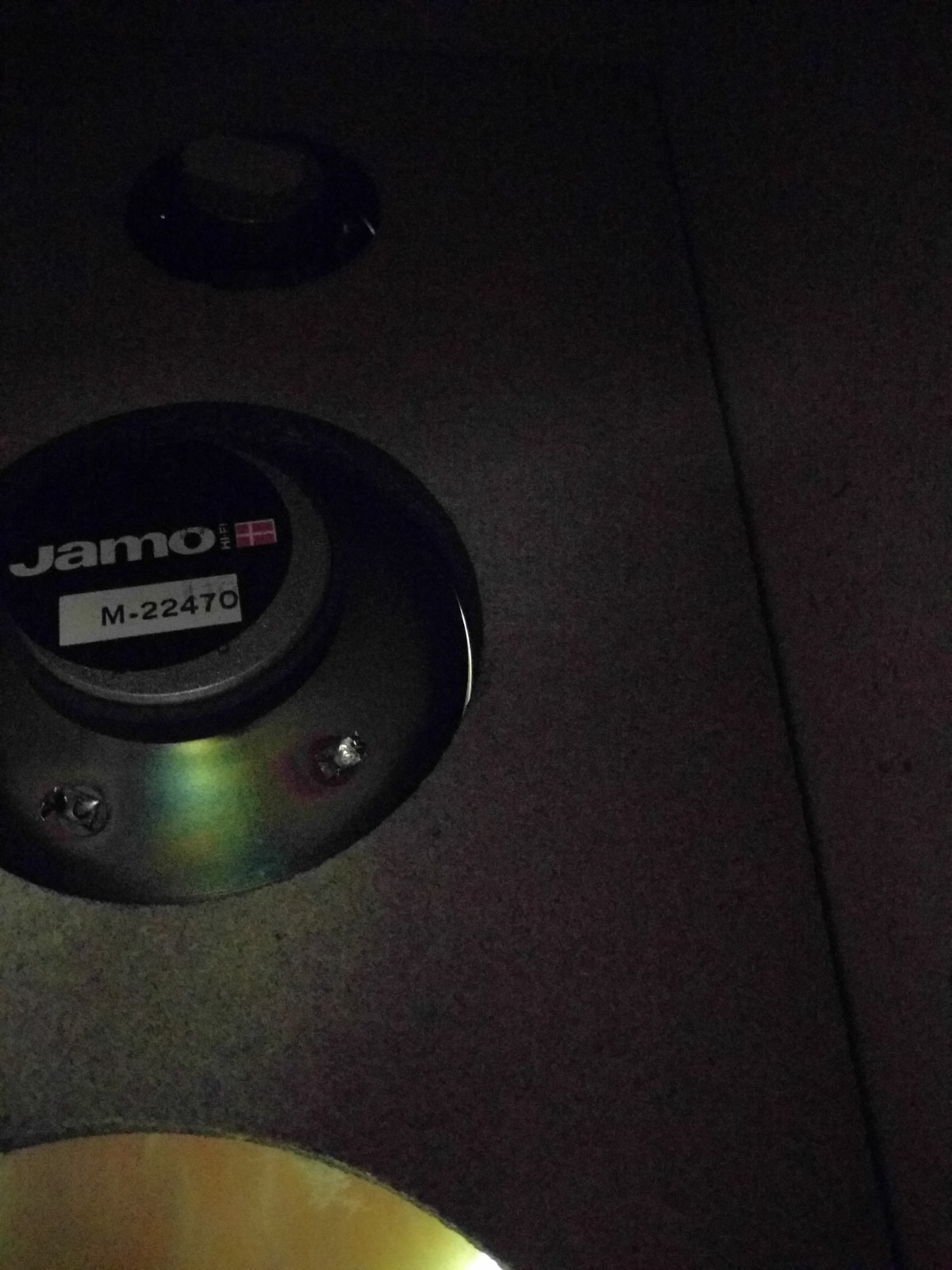

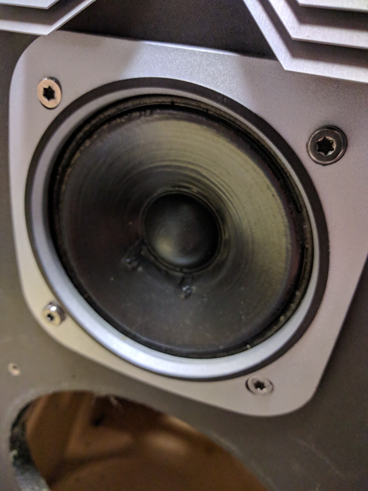

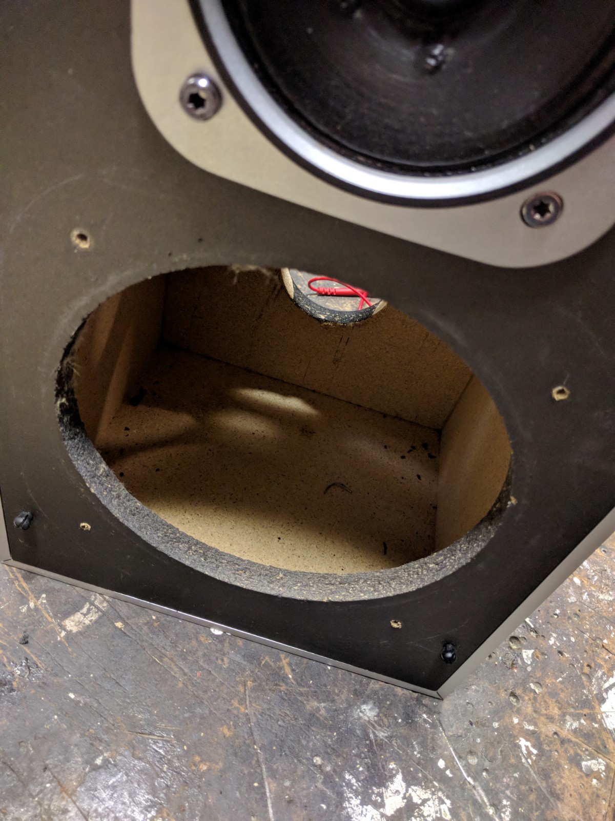

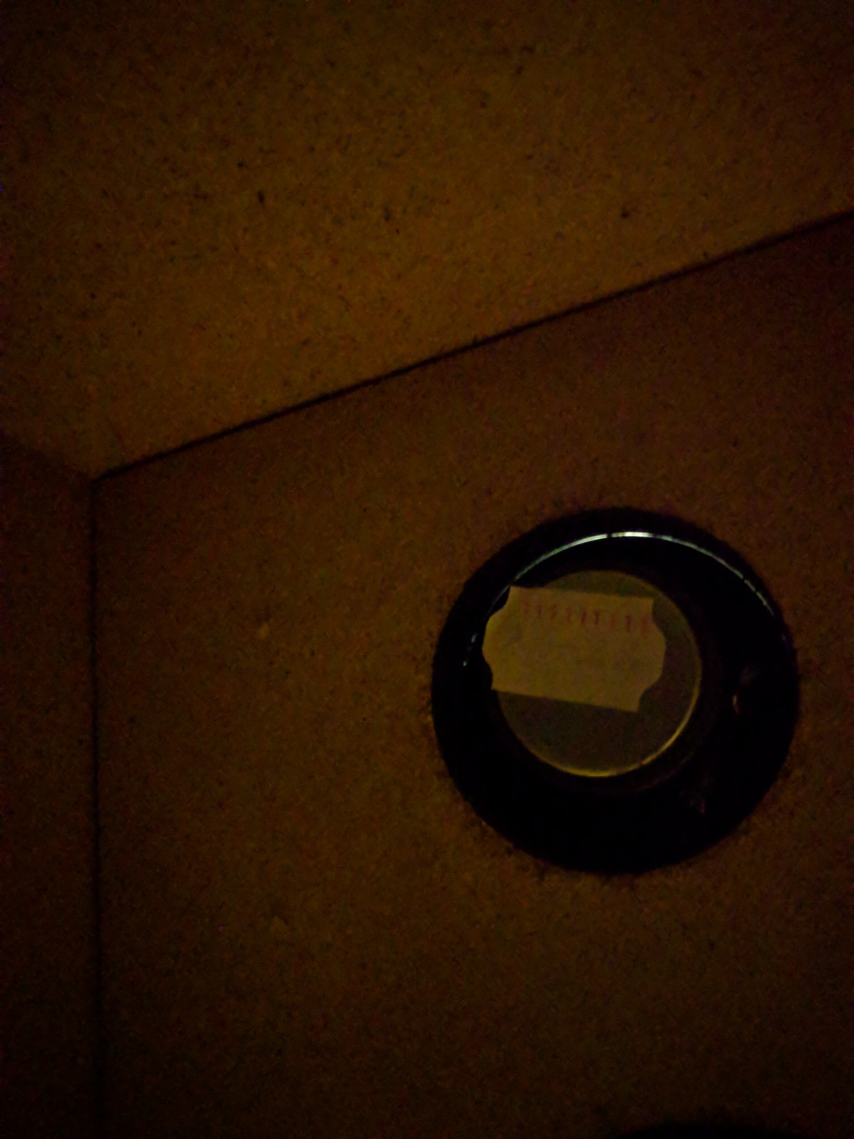

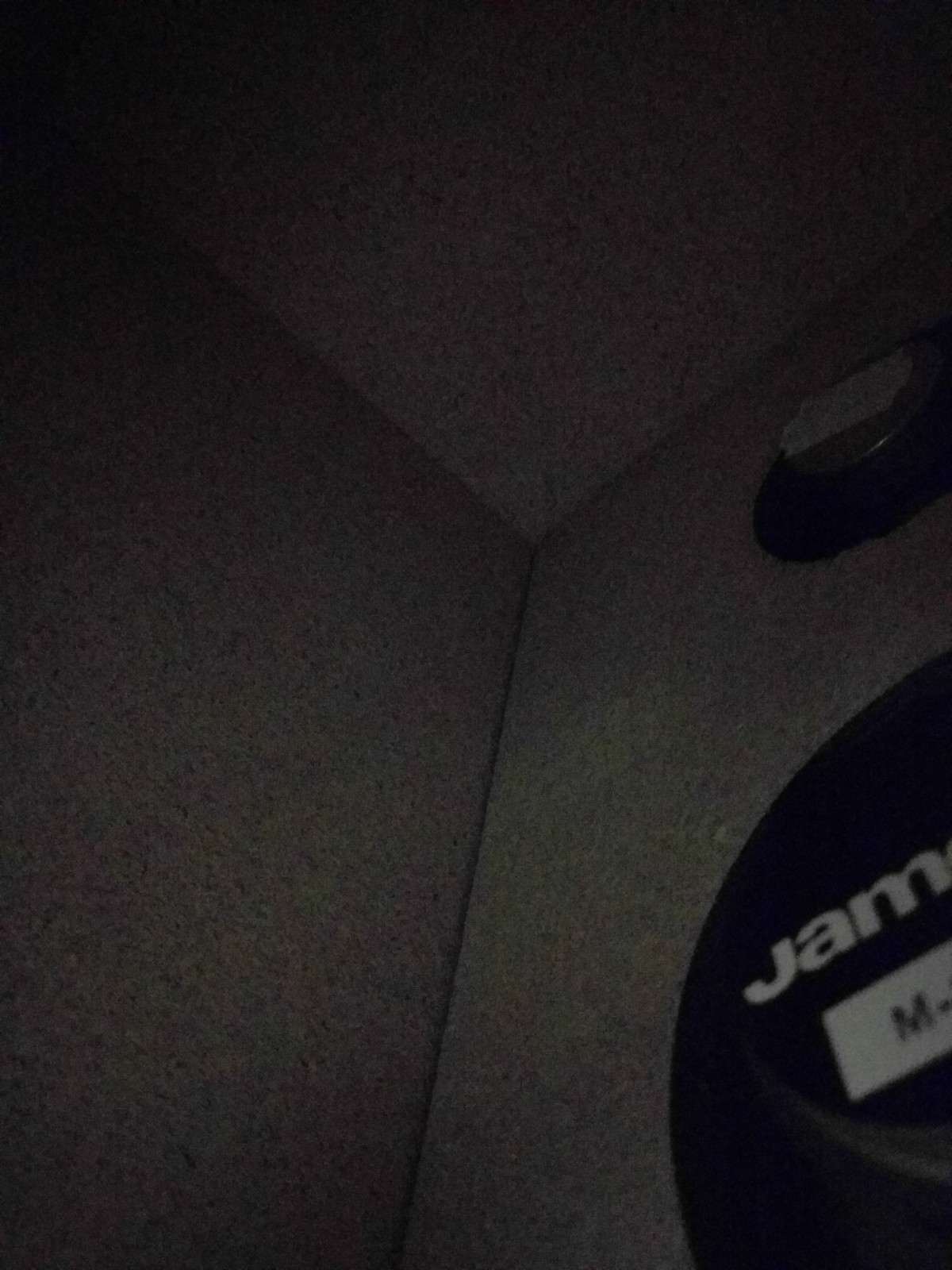

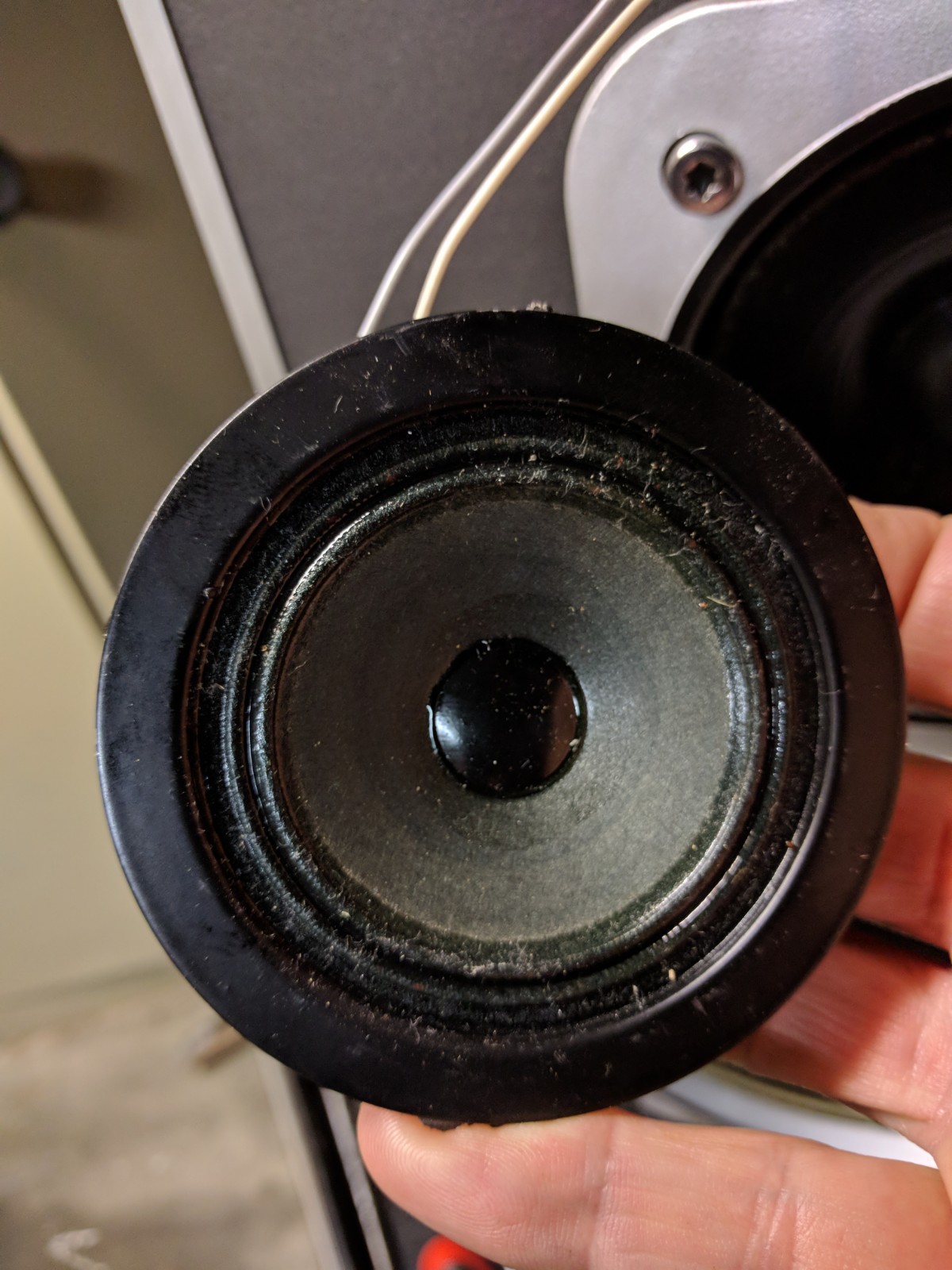

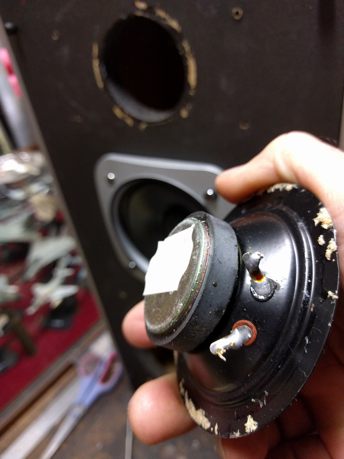

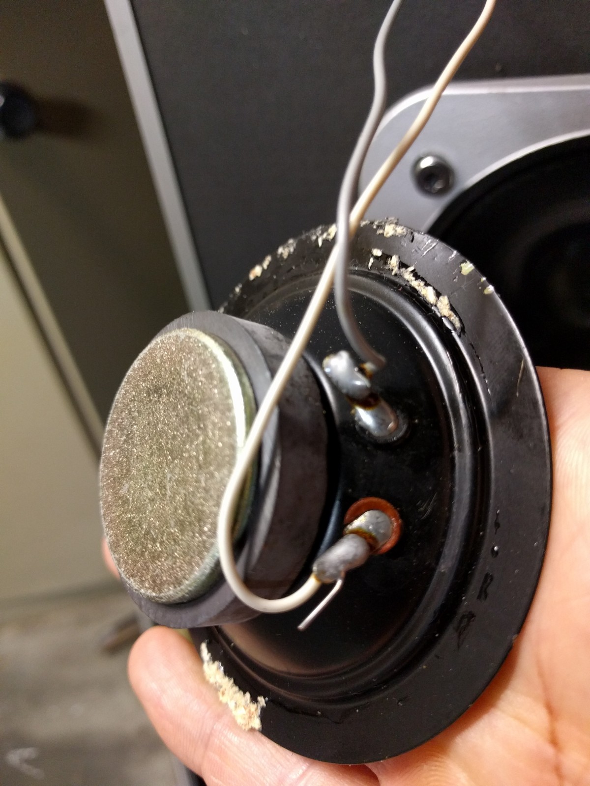

Which terminal is which? and I assume you are counting Red terminals as positive terminals on woofer and mid?
B is the positive.
The tweeters (as well as other drivers)are colour coded.
All are marked with a red terminal, which I presume is +ve.
