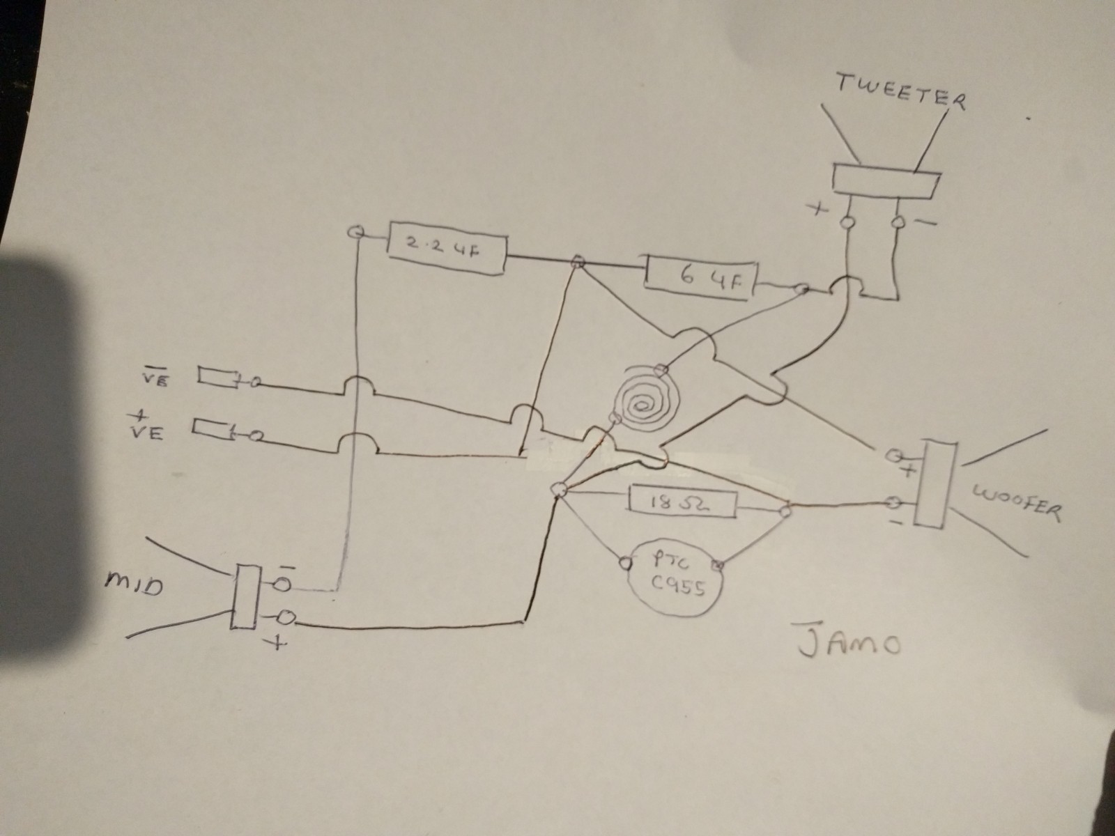

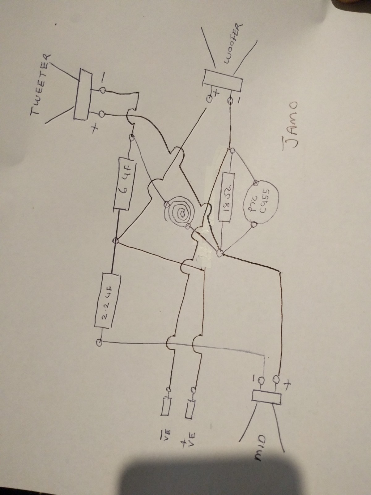

I share your ?, Ric.
13 ohm is a high resistance in this context and I would also like to see exactly where the PTC is positioned in the crossover.
Meanwhile, I agree that replacement with an identical PTC or, alternatively, 13 ohms worth of resistance are the options open to Cliff.
I have replacement caps and resister ready to go.
Just stumped with the Thermistor issue.
Everyone is posing valid points???
Now that you've finally supplied the crossover circuit, I can definitely state that the folowing is valid and I hope Ric will agree with me.
In the absence of a replacement C995 PTC, you have two options:
  1. Leave the original PTC in circuit and leave well enough alone.
  2. Remove the PTC and replace it with 13 oms worth of resistance (12 ohm + 1.0 ohm ceramic resistors in series).
If you don't intend to play at high volumes, as you have said, then you will not need the protection of the PTC.
Note that alternative suggestions regarding using lamps and fuses to replace the PTC //18 ohm protection circuit are valid, but would need their required values to be carefully calculated in order to be effective in their protection duties. I would not go there unless you know what you are doing!
@ Allen. Cold resistance should be 13 ohm according to specs.

If the Thermister has defaulted to "compressed" output, then I won't really know the cause, as this might also be due to the Tweeters, or the crossover?
So I might need to do an A & B test with Thermister in place vs removed.
