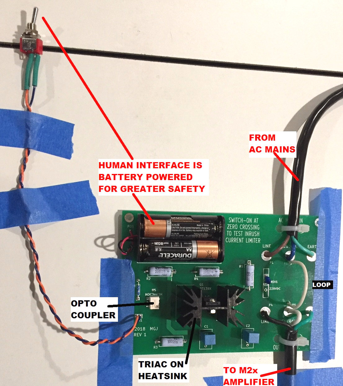

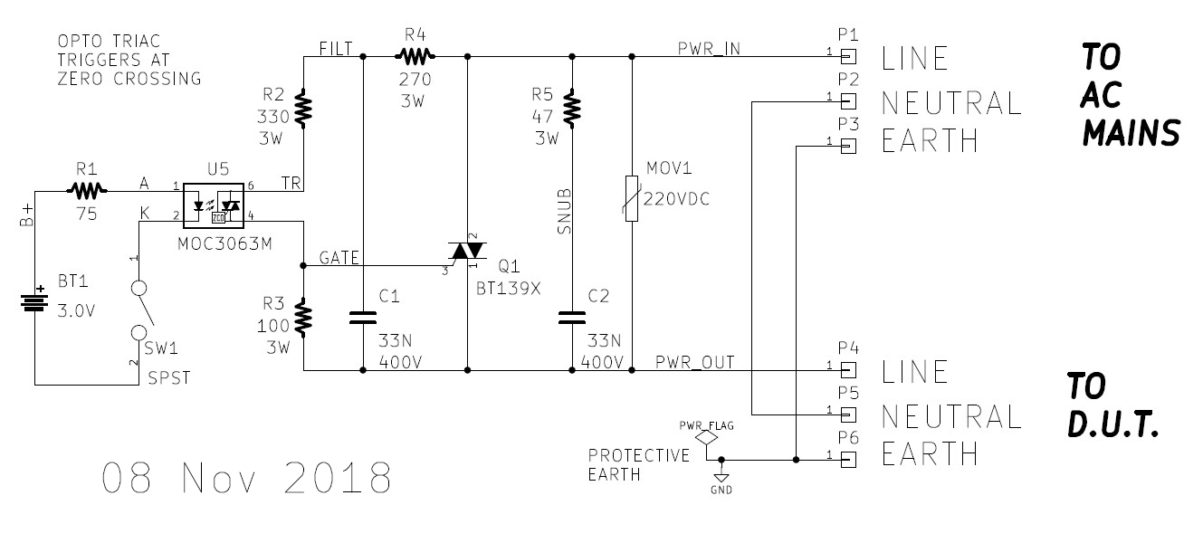

I took a different approach. I built myself a test box which is guaranteed to switch-on the AC mains at the worst possible instant: at the maximum inrush phase of the mains waveform. Namely, at the zero crossing of the voltage sinusoid.

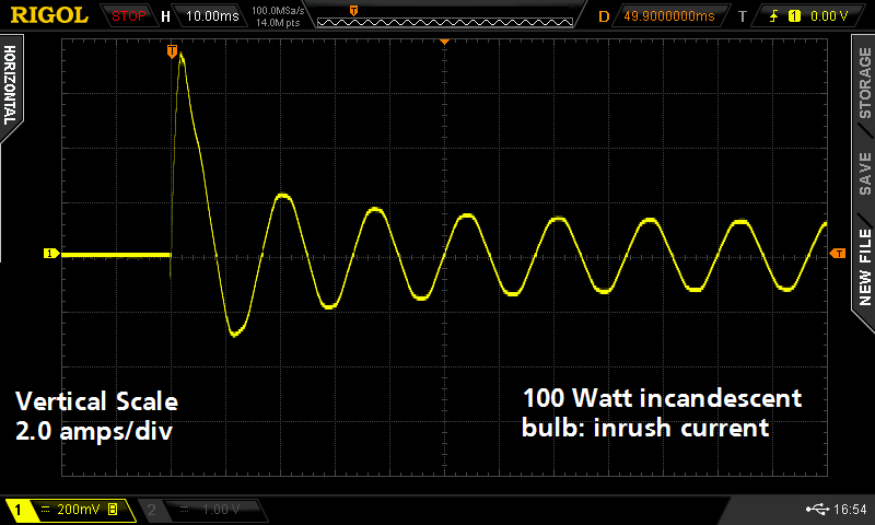

With this gear you simply attach a current sensing scope probe to the AC mains and throw the switch. Presto: you get to measure and to observe exactly how well or exactly how badly, your worst case inrush situation actually is. Here is a (link) to the original discussion, and a few of its photos are shown below.

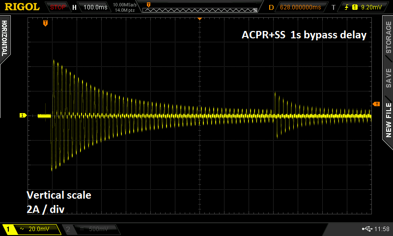

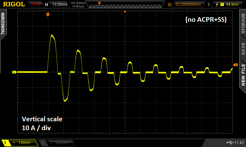

The bottom two pictures attached here show the test box, applying the AC mains to a solid state power amp (Bob Cordell's Super Gain Clone) -- at the worst case zero crossing. This power amp is measured twice: without, and with, "ACPR+SS" ( an AC Power Relay plus Soft Start circuit ). You can see that the soft start has reduced the inrush current from ~24 amperes to ~4.5 amperes. Even when the mains is switched at the worst possible instant: the voltage zero crossing. ELI the ICE man.

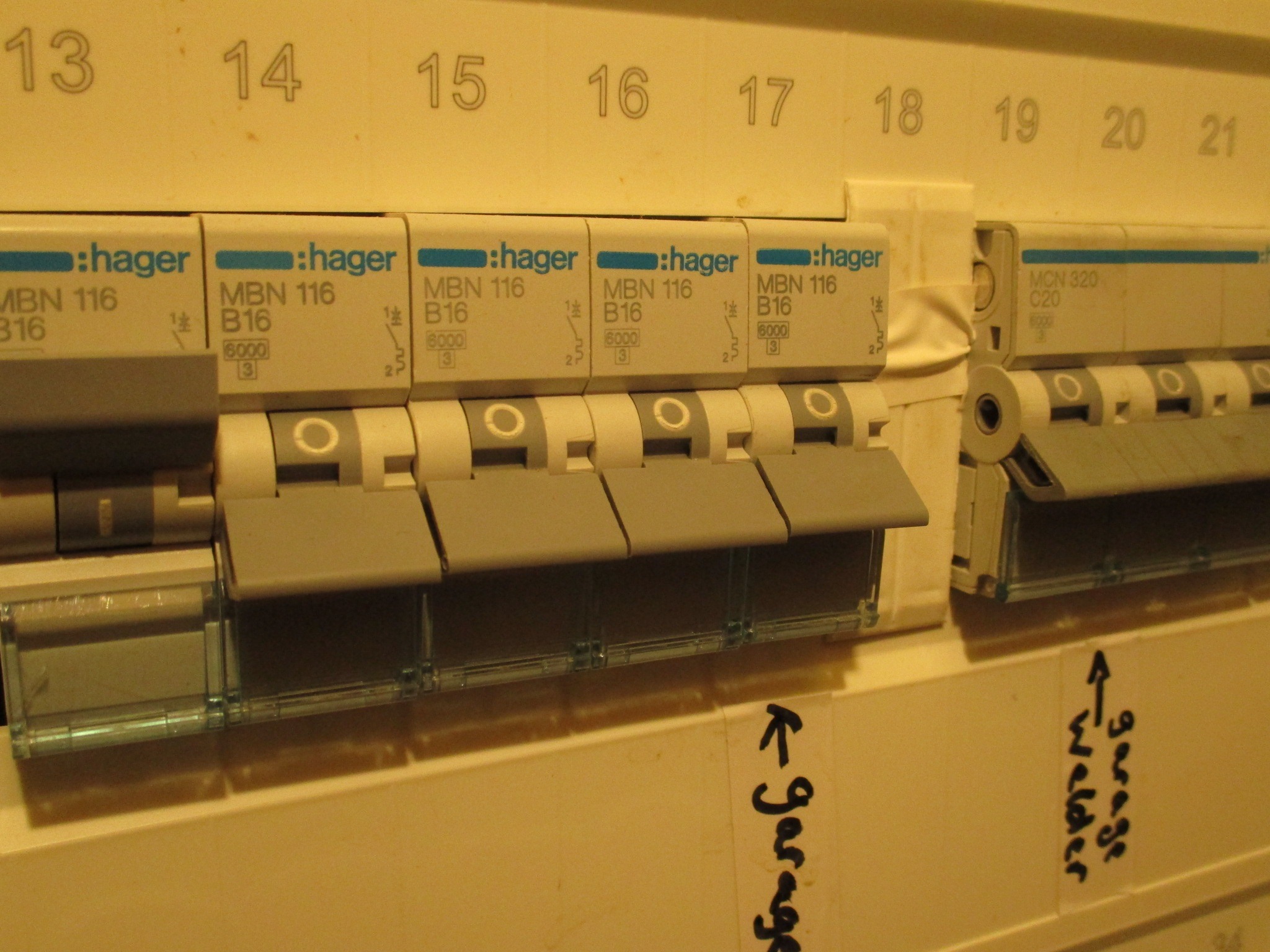

"Much lower" must be seen in the context of the grid. In my country that would mean a maximum of just 0.28 Ω for a 3 x 25 A service (a typical residential connection). I don't think that it will make much difference for the inrush current of the toroid if your grid connection is 0.05 Ω or 0.25 Ω.
Hold on ! In my rewired house in Germany with 1.35mm dia copper point to point wiring now standard rewiring installation, a 250VA toroid wound for 1.6T on random plug-in will easily trip a 16A B characteristic over-current trip which is fitted as installation standard. The european toaster and kettle both switched on will be on the verge of a 16A B rated trip chattering. Older installations with thicker ring wiring esp. in the UK benefit from vastly increased circuit fuse rating to take all surges, hence protection is often down to the individual UK 13A plug with it´s separate fuse. Modern or rewired housing now requires every layer in the household to be separately fused or relay tripped.
A 20A three phase "C" characteristic trip on the row next to, is for a welding transformer, which specifically makes use of the 1.7T excitation, with power factor capacitance added. A soft inrush on the equipment is still required.
The situation choosing appropriate equipment fuse protection then begins, and in years past, an engineering solution for toroids for studio /audio work is to request the winding house to wind for 1.2 or 1.3T which softens the surge and also reduces the stray magnetic field. That penalty usually results in an increased size and maybe cost. Sadly, those toroid vendors I used have been taken over(or gone bust) but haven´t come across any others who now do this. Majestic transformers (UK) will do this flux reduction with E&I styles only.
As to the diagram with the triac, I wonder how good it really is with that nasty loose connection test, as some years ago I tried a similiar circuit and fused the triac into a short circuit. It requires a very fast reset even on start-ramp up..

As for the tripping of MCBs or melting of fuses: light devices like consumer amplifiers with - say 300 VA toroids - should not trip a B16 or melt a fast fuse ("gF" IIRC). I have a welder that needs a C16 as it may trip a B16, but that's miles away from an amp.
