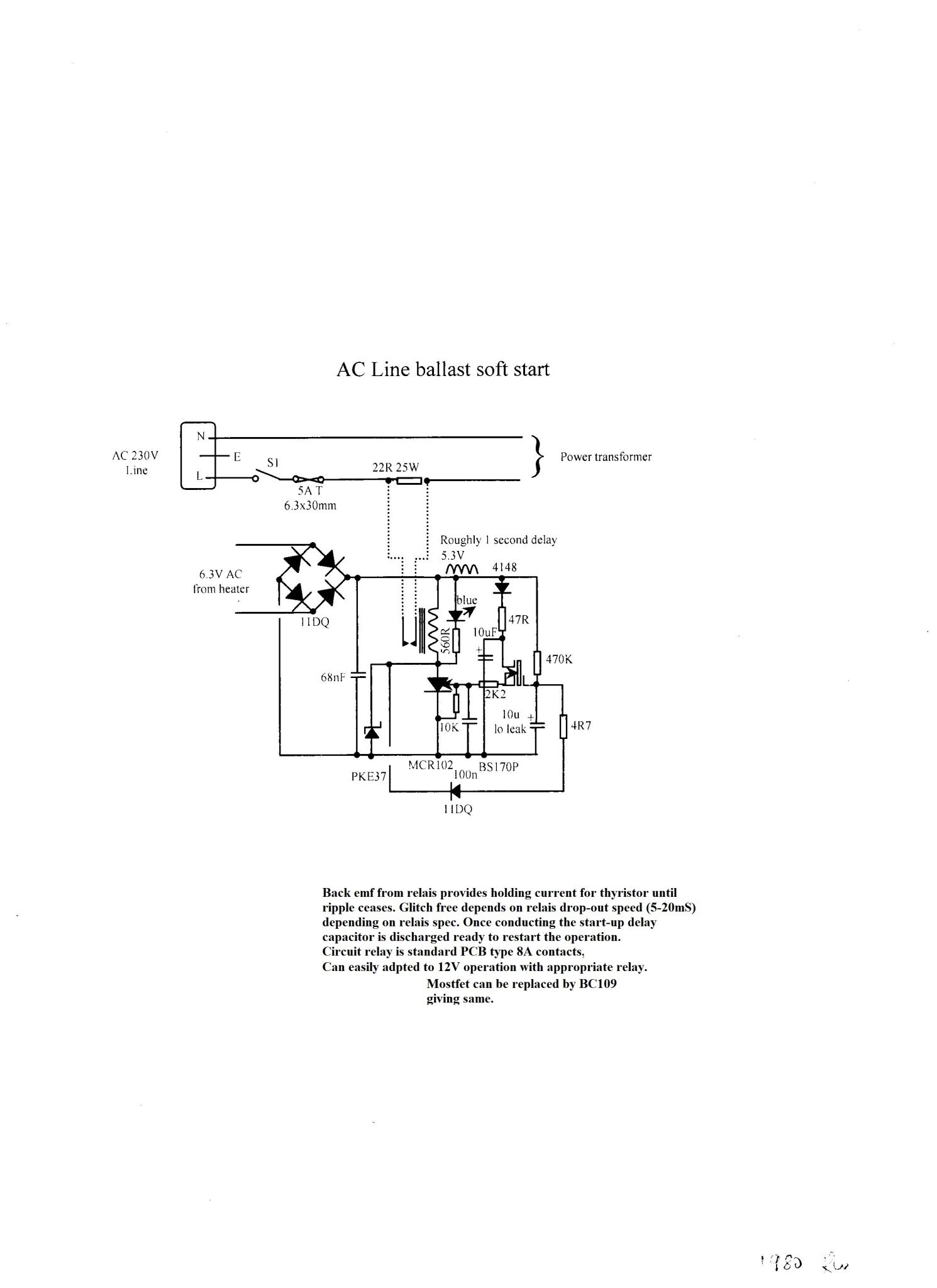

Here is the weekend sift through the folders,, that inrush circuit which I cobbled up many decades ago and is standard in my mains tube/valve equipment. I even used a near identical circuit for an arc welding transformer, which is probably the worst and most hostile environment. As mentioned, all circuit values are arbitary and be changed.
Only a note, if one breadboards the circuit, which typically have poor grounds/returns, the thyristor is quite sensitive to any spikes and may latch on prematurely. I use a ground plane and keep gate components esp that capacitor typ 1-47nF close to the cathode, that way spurious operation is avoided.

Probably "PKE37" is an abbreviation of a longer part number.
Just as the notation "11DQ" on the schematic, is an abbreviation of the actual part number, 11DQ06 (link). And we must mention the abbreviation "4148" also on the schematic.
Apols for the short component abbreviations......Naughty old habit burning midnight oil....been in this for a long time now..perhaps too long for old dogs to change habits. Zener volts merely to protect the thyristor. Can be any Zener 30-50V. At that time 1980, in non critical applications I simply used a PKE out of the junk box which is really a high speed transient type.
The great virtue of these quickie circuits is one can experiment the circuit function on the low volts side without being exposed to high volts. The mechanical relay makes an excellent interface.
