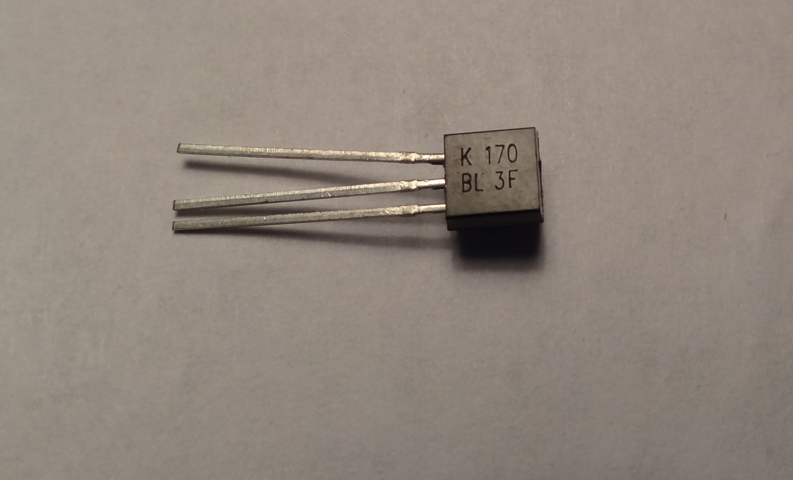

18mV/100ohms is not a good Idss number for these devices
for BL devices, idss should be between 6 to 12mA.

Sorry, they were 18mA each. I just checked a bunch more and they run between 12mA and 18mA each. The ones I used were some I had purchased as matched. They measured 18mA. I used this circuit.

It looks different to those I have, maybe yours are fake.
I have used these same JFETs in a few other amps without issue.

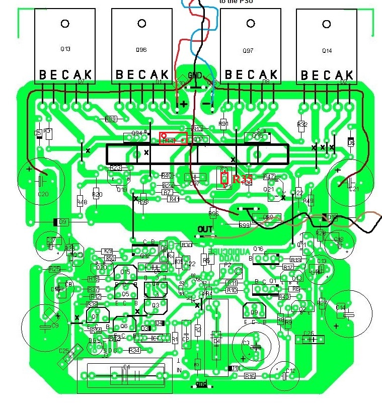

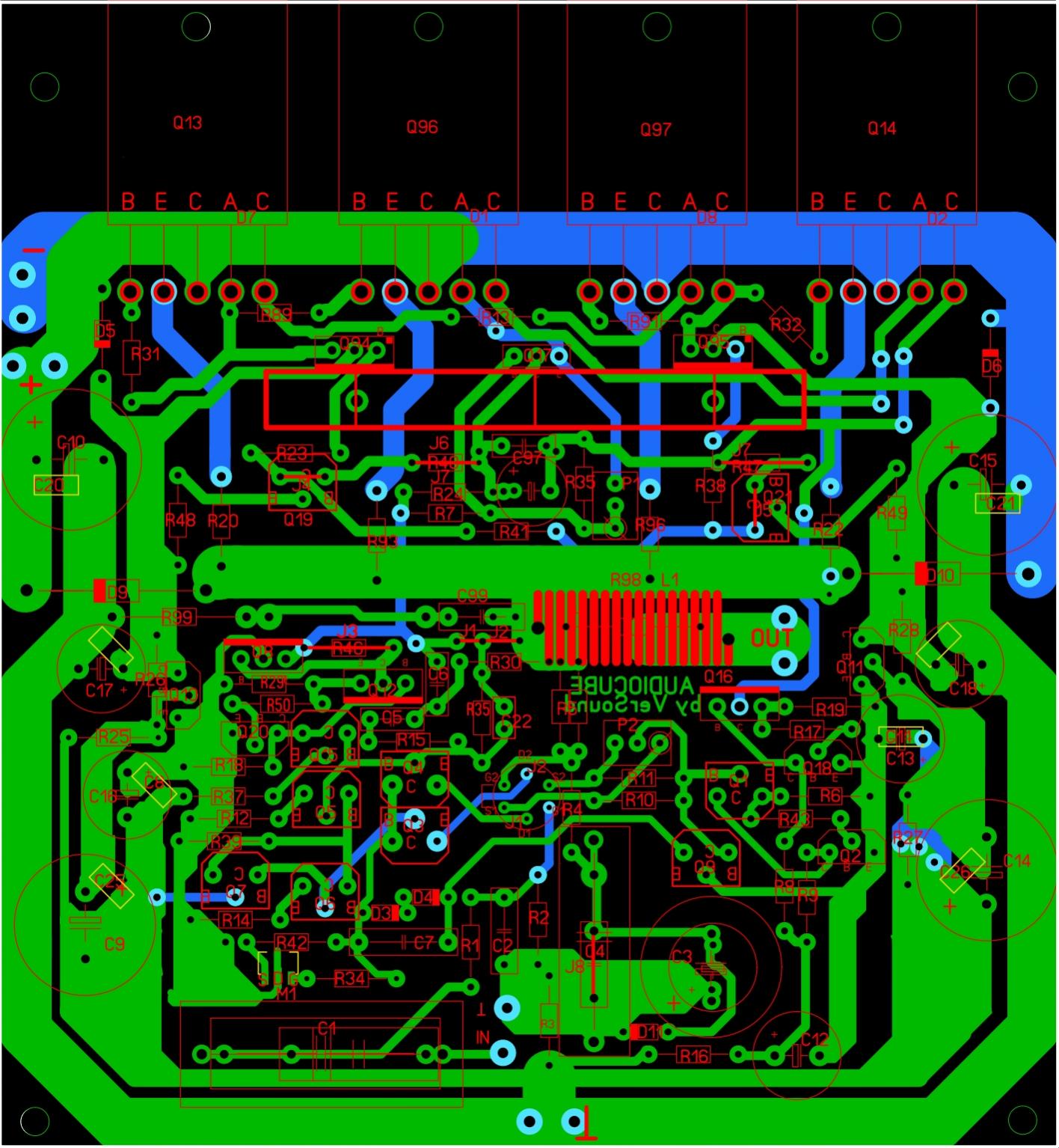

Did you look at the voltages around them in the schematic I posted? They are in line with the spice file. I think the problem is with the layout. You have said you used a two sided layout. The one I am using was the most recent one posted at the time you suggested I try this amp. After I etched the boards you posted a different one. To my knowledge, that one hasn't been tested either. You said the only error on the one I used was that P1 and R35 were reversed so I swapped them. I am attaching a pic of how I did that. I suppose it is possible that that may have something to do with it but to me it looks like it is correct per schematic. Please look over the layout and schematic and see if you find any more errors. You know how hard it is on etched board when you keep replacing parts. So far every part I have pulled has measured fine.

... i agree,; those look fake to me also.

Terry, this is not 2SK170BL as Idss is to high, max Idss for BL type is 12mA. There is not only Idss, but Vgs(off). 2SK170BL has very low Vgs(off) lower then -1V.
The fake fet could work in some applications. If this one has higher Vgs(off) then it could work with higher voltage than 3.5V as it's here. Try to replace one LED with 10V zener, cathode the pointing to the + side.
2SK170 or LSK389 is low noise, low Vgs(off) fet and with other type here the sound could be worse.
I could not find any layout fault. If you want I can send you the double side layout gerbers I use in my amps, but again there is question of the fet.

Sorry Terry for that. You where to fast with your build, I could not worn you about the layout. I have built 10 boards of this amp, all double sides layout with no problem except that change in Vbe multiplier.

I someone wants to build this amp here are the gerbers for the double side PCB I used in my amps and all of them with no problem. This layout has corrected part around the Vbe multiplier, P1 and R35.
