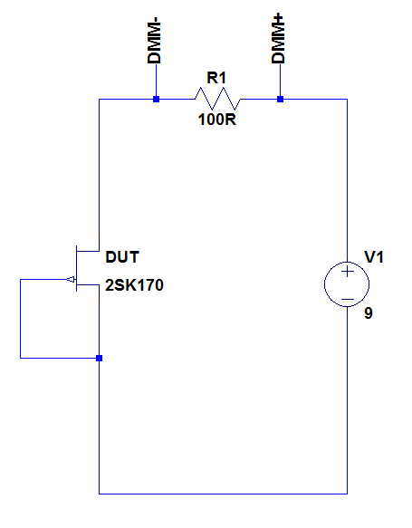

Back to a test circuit for matching the JFETs. Will the attached circuit work for testing and matching the 2SK170?

Probably I wasn't clear enough when I said two LEDs voltage for matching. As keantoken said to use Vds of the same level the fets are under in the circuit, and that level is two LEDs voltage drop.
You can use your matching circuit, it is with 9 V instead 4 V, but it will make no difference. As 2sk170bl Idss is between 6 and 12 mA, on that resistor you will lose about 1 V.
BR Damir
I have a 2A DC supply that has 3V, 4.5V, 6V, 7.5, 9V, 10.5V & 12V settings. Would it be better to use the 4.5V setting? I have an ammeter setting on one of my DMMs if that would be more accurate.
You can use 4.5 V and than compare with 9 V, I think there would be no difference.

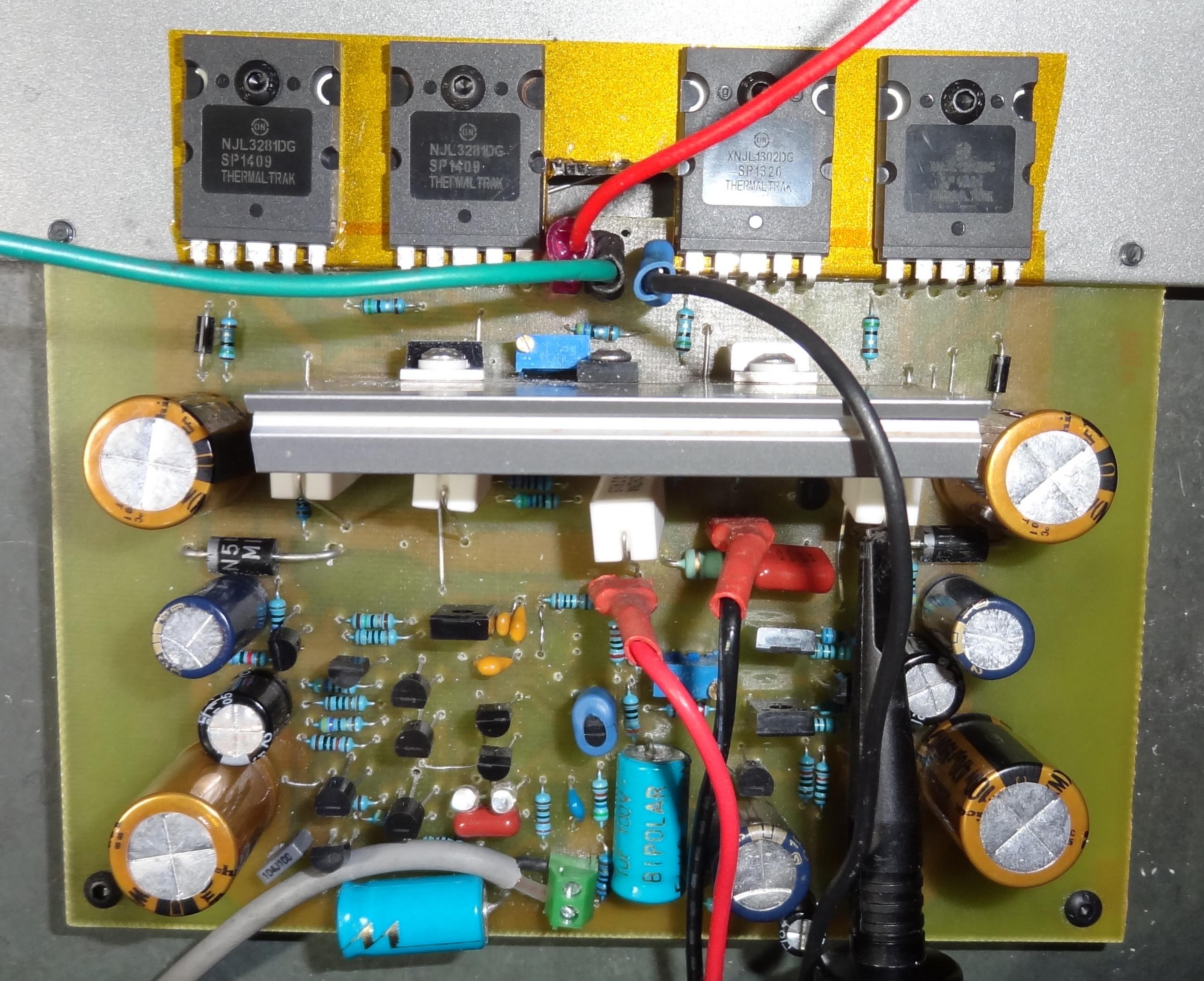

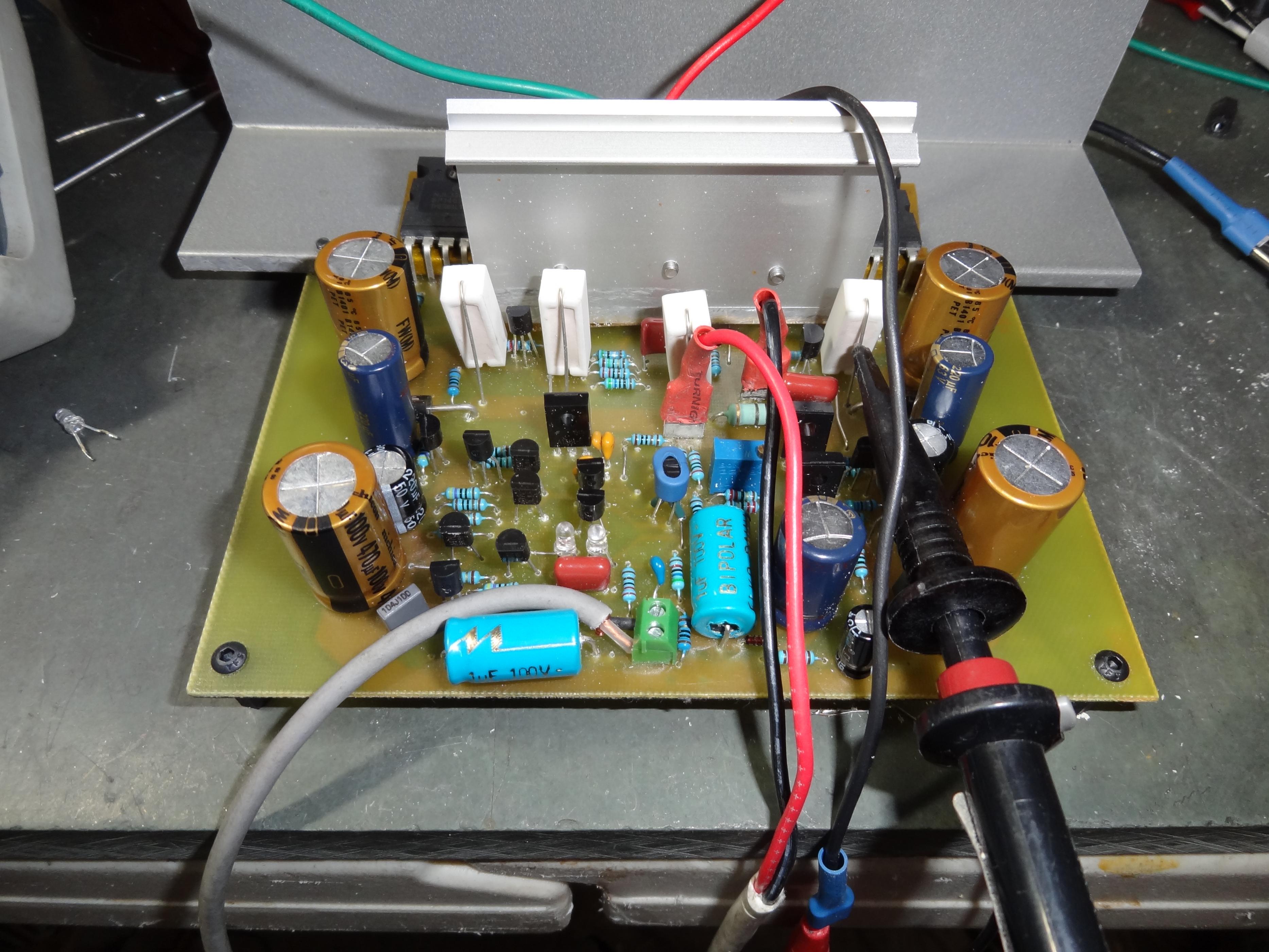

OK I have one board sort of working. It will play a sine wave but there is a lot of noise. It may be oscillating. If I hook my DMM to the ground and touch the other probe to the K-pin of Q14 the hiss sound will all but disappear. The only thing that is not installed are the two caps shown that go from the rails to ground right at the rail and ground studs. They are labeled C10 and C15 but on the schematic C15 & C15 are 470uf which I believe are C20 an C21 on the board. I will keep looking. It may be a have yet another solder bridge of cold joint somewhere. The bias is also very touchy. I have a ammeter hooked to the negative rail and the bias will jump from 30ma to 250ma in the blink of an eye so something is just not happy. More later after I've had a chance to do some more inspection.

Hi Terry,
Have you soldered 220pF ceramic C0G caps(C24, C19) directly between the pins base an collector of the drivers(Q95, Q95) on the PCB back side? Without them OPS will oscillate.
Also important is to connect input ground to the common star ground(outside the PCB).
Best wishes
Damir

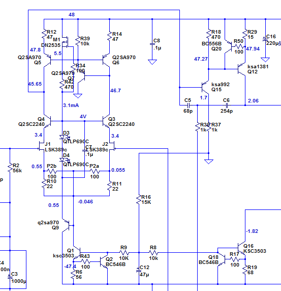

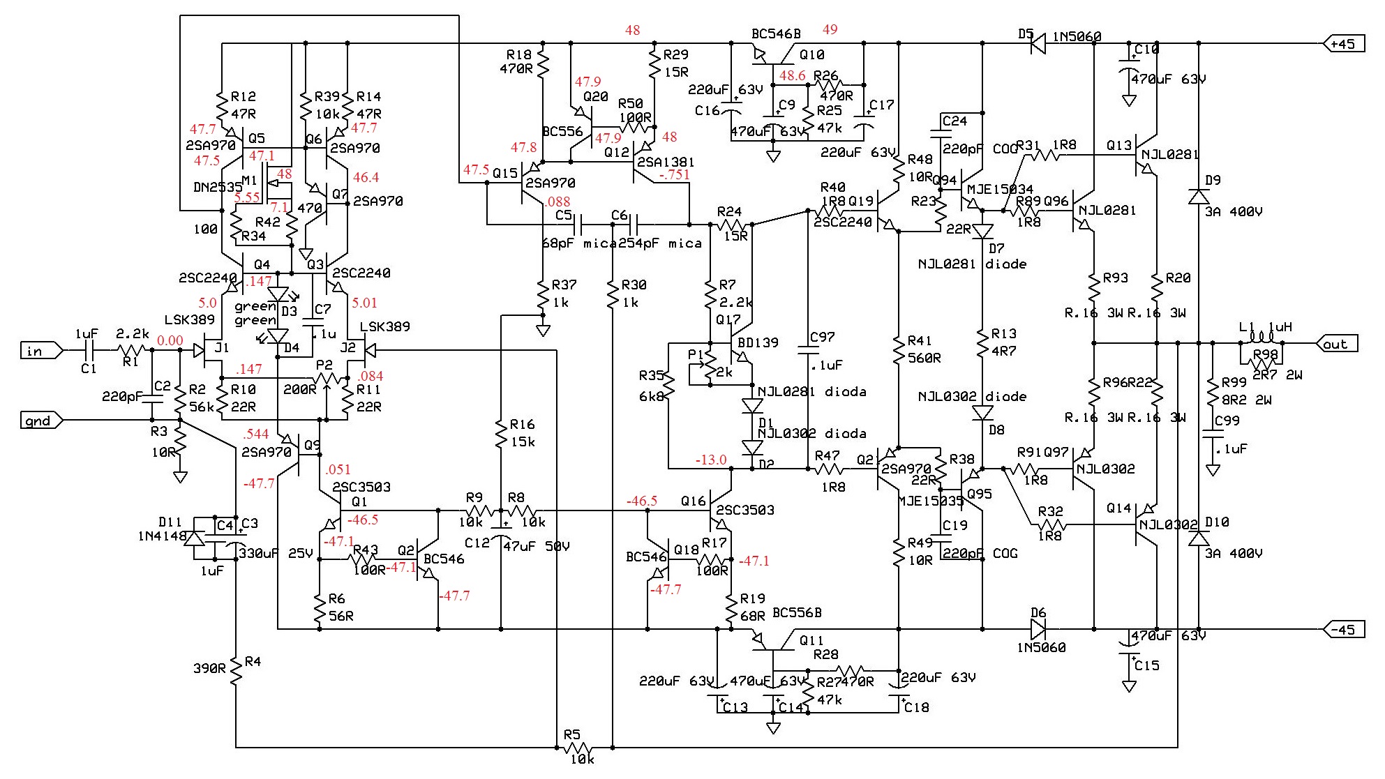

I'm having a problem with the front end. Q12 and Q20 have almost no VBE. The transistor check out OK. Any ideas are welcome.

Hi Terry,
Something is wrong with the LTP cascode biasing(Q3, Q4). On the D3 LED Anode should be close to 4 V(two LEDs voltage drop). Do the LEDs alight?
BR Damir
If you look at the base of Q3 and Q4 you will see 5.5V and emitter of Q9 is .544V so about a 5V drop. LEDs glow brightly.
VBE of of Q3 and Q4 is around .5V . VBE of Q5 & Q6 is about .6V.
However, vbe if Q15 is only .4v, vbe of Q20 is 0V and Q12 is .2V

I simulated with your power supply voltage to see where are the voltage differences. What kind of a LEDs you use that you have 5V drop on them? Or maybe you have to high current, it should be about 3.1mA to 3.2mA through them.
On your attached schematic there is .147 on Q3 Q4 bases, but anyhow a transistor to conduct should have 0.6V or a bit more between base and emitter, 0.5V shows something is wrong.
I hope this ca help you, I still think that an error is in LTP and surrounding components or connections.
BR Damir
