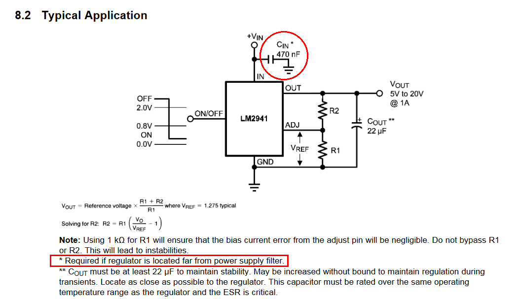

Agreed and hence the "FWIW" and why I want to test the 2SC6144SG for stability. I think I will leave the min-fT-of-650MHz MMBTH10 in place versus the 100MHz-700MHz fT MMBT6429 - perhaps my batch of the latter has fT at the lower end of the range.

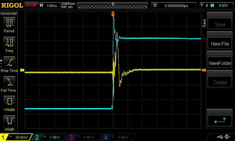

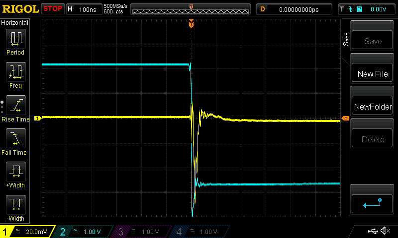

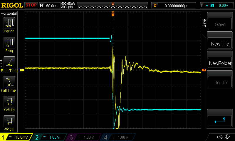

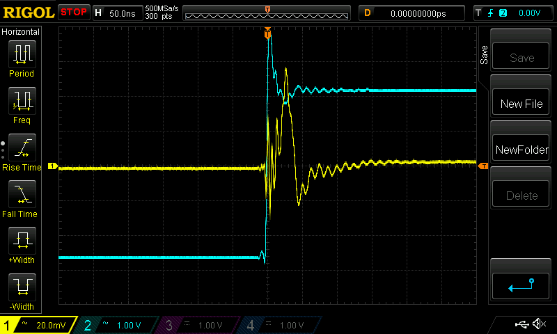

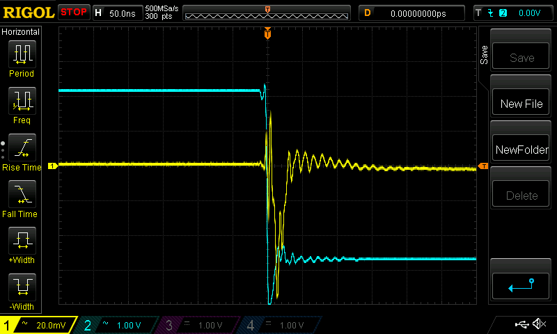

Am I right to see the ringing as circa 80 MHz well above the modelled unity gain frequency which is more like 1.5MHz? Hence it is likely ringing from parasitics, perhaps because I have no base stopper? It would seem, however, that having to use such a stopper is likely to kill off a good deal of any advantage that might be had from a higher fT pass transistor.

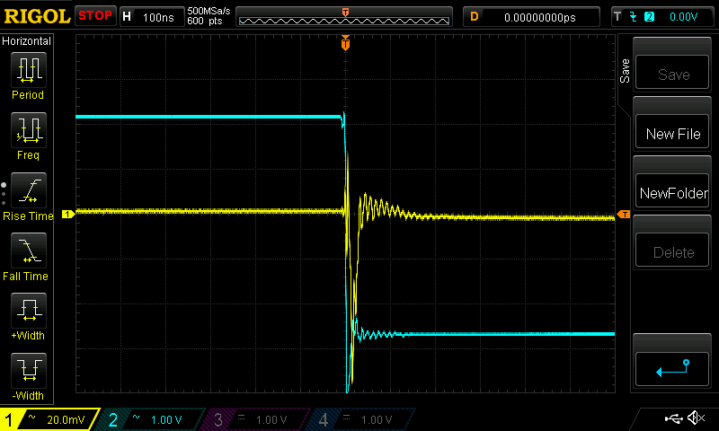

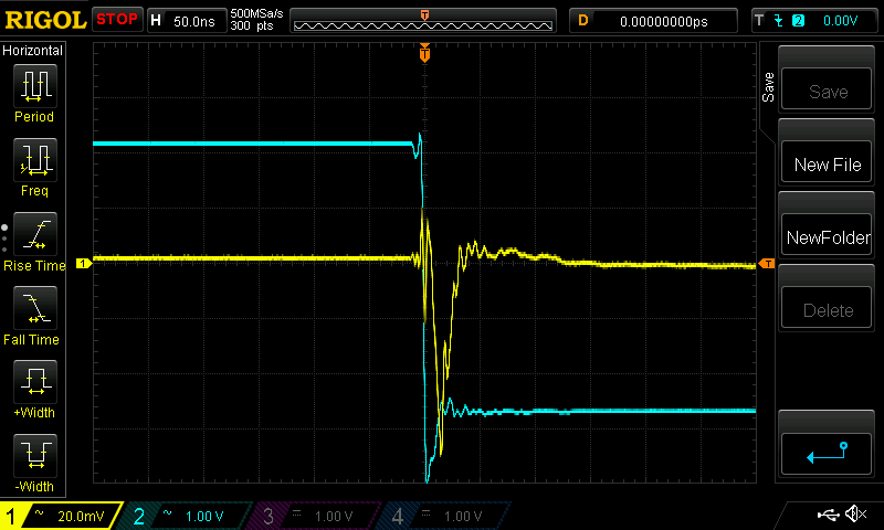

Looks like crummy probe grounding. Are you using the 1cm long coilspring ground? Or the crocodile clip + 10cm wire ground?
coilspring - probing the pins of the output cap (3.5mm spacing). Same as before. Should be directly comparable to pics in post 313. (Trigger is just probe croc clip to faston connector.)
But I think you are right (as usual). I just powered it all up and took the (second two) measurements again (plus a look at 10mV per division, 32 sample averaging). Much less scary today.
The good news is, the entire assembly is stable / non oscillatory, as it exists today, even with the imperfect transient response of the preregulator. If/when you tweak the RC network on the preregulator output to improve its load regulation, this will only improve the final result.

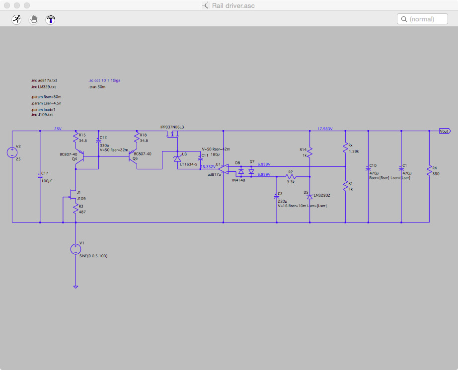

BTW I read that Walt Jung article linked in post #320, and found out how he measured 120dB line rejection. It's scary. 1V input, 1 microvolt output, measured with an Audio Precision system 2 rig ($40K?). I don't have any idea whether such is possible using PC soundcards and homebuilt preamps and software ... but it seems daunting.
And Walt requires you to remove all input capacitors from the raw DC supply terminal of your voltage regulator board (his 200kHz rail driver has to drive those caps!), and replace them all with a single 0.1uF capacitor. The impedance of 0.1uF at 200kHz is 8 ohms, so his raildriver pumps out (1v / 8R) = 0.125 amps at 200 kHz. I now see why he won't let you connect 220uF to his rail driver!

With short cables I think you could live with Cin=100nF. You could redesign Walt's ancient raildriver circuit with modern components: use an AD817 (50 MHz) and a high-fT Nchannel power MOSFET from Infineon, to give 2 amps max output current -- 1 amp for the voltage regulator under test, plus 1 amp to drive an 800nF input capacitor at 200 kHz. All you need is a high frequency signal generator, an FFT setup that runs at 200 kHz, and a 120dB preamp.

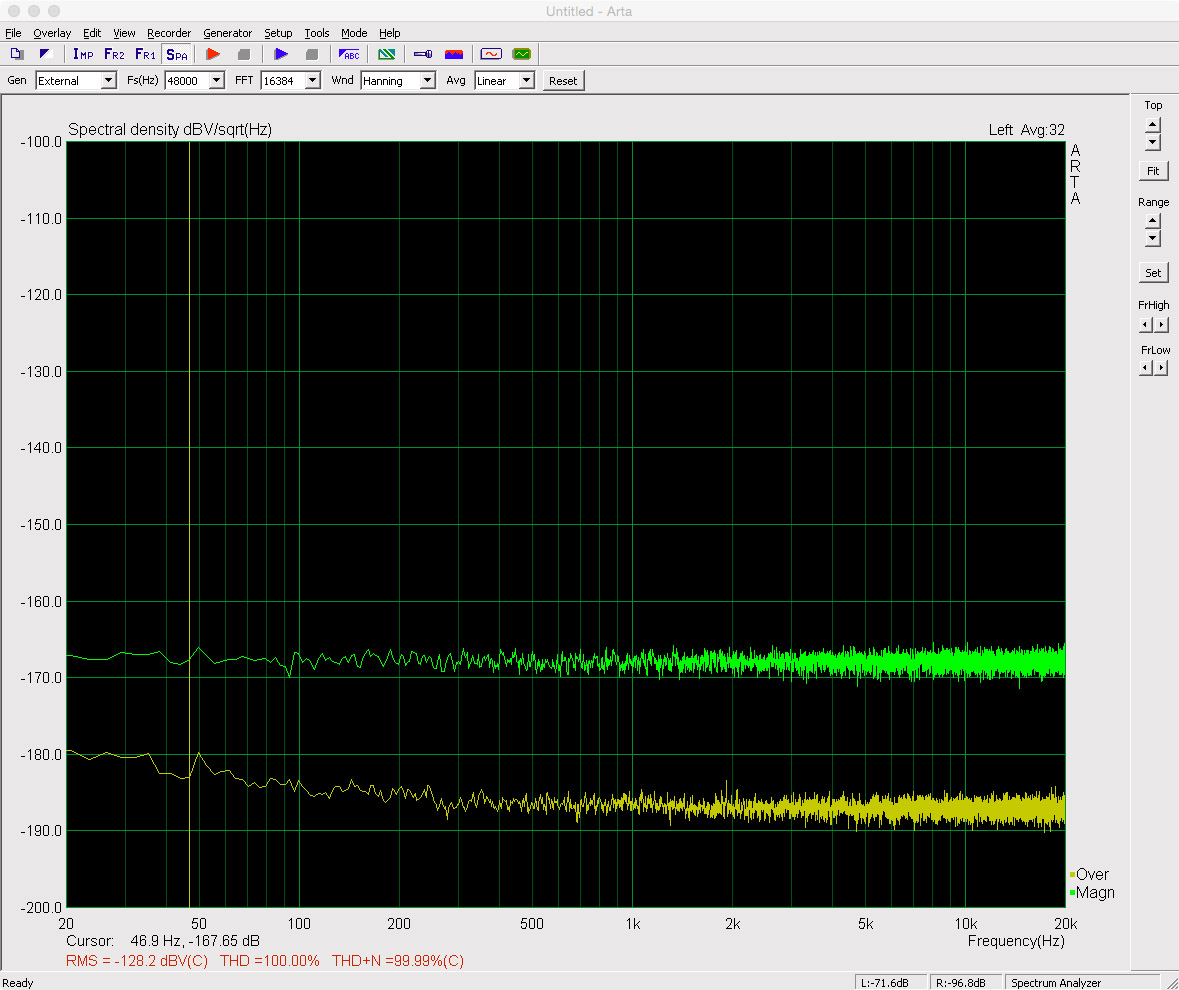

Attached is a pic of my implementation of Sam Groner's preamp with input shorted and measuring a 1k Ohm resistor.

That's a superb result.
If we assume a 1kohm has 4nV/rtHz, then that points to -167.7dBv
Near enough identical to what your plot is showing.
And your noise floor is nearly 20dB below that.
Your 50Hz interference only just shows as a tiny peak above that level. I can't pick out 3rd, nor 5th, harmonic of that mains either.

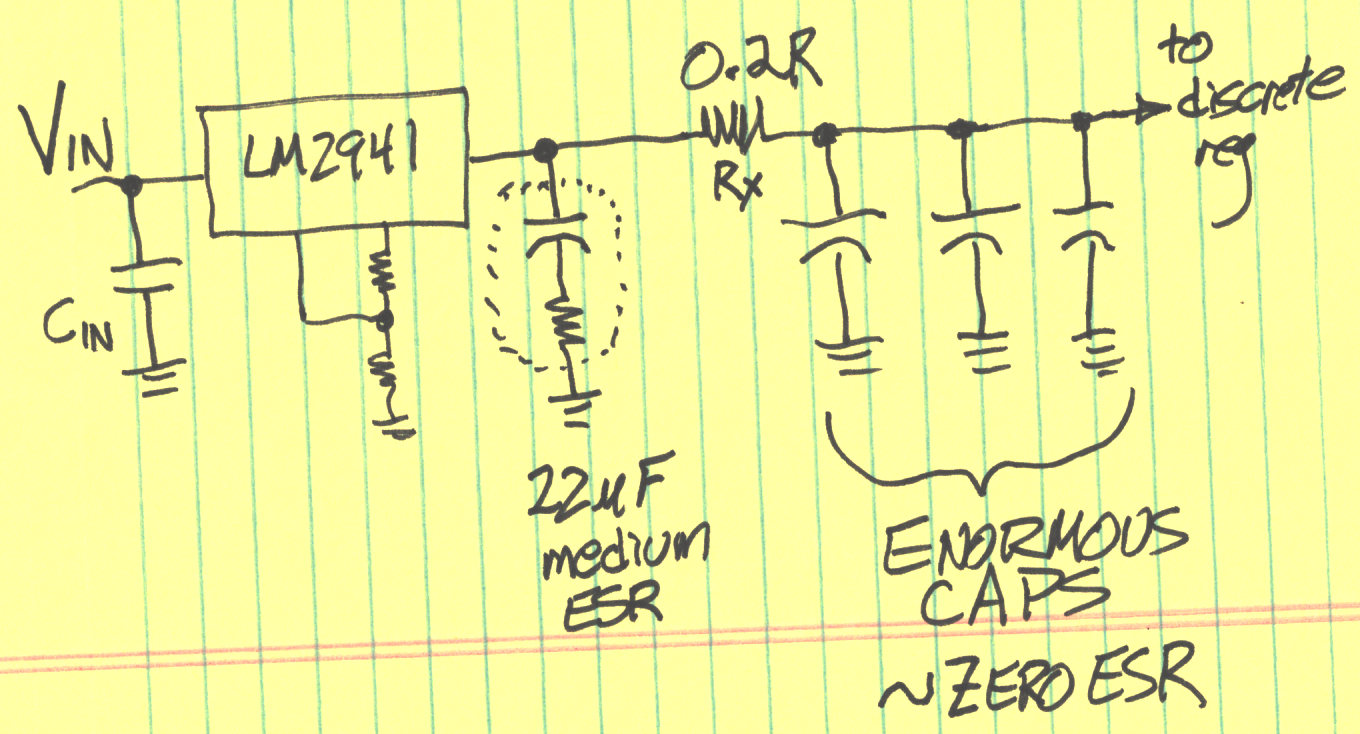

So I've been thinking about the preregulator. If we assume its function is to slice off the first 70dB of input ripple (at all frequencies), and if we don't care so much whether its output voltage is exactly 15.000 volts, as long as its line rejection is good ....
then we can tweak the output capacitor and its explicit series resistor. Instead of putting the resistor in the ground leg of the capacitor, let's put the resistor in the supply leg of the capacitor. The two topologies are equivalent: C_series_R , R_series_C {thanks to Kirchoff's Current Law} but perhaps the second one is "better" for our preregulator application.
See attached figure. Now the LM2941's output sees two (capacitor series resistor) networks in parallel. The "ESR" of this network is (RsmallcapESR || Rx) and we choose component values to keep it between 0.1R and 1.0R, so the LM2941 is stable per datasheet Figure 13.
However, in this topology, the capacitors after Rx have vanishingly low ESR so they are better and better approximations of a perfect capacitor whose impedance is ~Zero. Voila, the input node of the downstream discrete regulator is a ~Zero impedance perfect voltage source. Load transients suck big impulses of current out of this ~Perfect capacitor, and the discrete regulator's input sags not at all. Not even a millivolt.
Furthermore, Rx and Cenormous provide another section of lowpass filtering, adding more line rejection.
The downsides are (i) you lose some headroom (Iload * Rx), which is probably unimportant when your input voltage is high enough to allow a preregulator; (ii) the voltage at the input of the discrete regulator is not constant, it's load-dependent: (Vlm2941 - Iload*Rx). However it moves around slowly and your downstream discrete regulator's line rejection of slow moving signals is very good.
Doing such a regulator to supply adequate current is straightforward - as you hinted, we've basically done this before. I've been thinking about the more challenging modification regarding where in such circuit the 1Vpp is injected. I don't really follow Walt's implementation and XLR wiring (or why his graphics seem to show 1.4Vpp input). I've been thinking about where a BNC connection from the waveform generator would be injected into the IPP037/AD817 reg circuit. Initially I was thinking it would have to be the reference part of the circuit which would have to receive the stimulus and drive change in the output, but this seemed complicated. Is it as simple as changing the reference level for the entire regulator by intercepting it and GND as depicted below? It seems to work in sim with minimal current demand placed on the injecting voltage source.

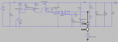

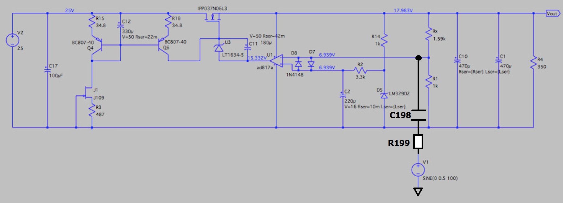

Walt installs C198 and R199 {maybe in the opposite order from my drawing?}.
Notice that R199 forms a voltage divider with the other two resistors, Rx and R1. Thus to get a 1.0V sinewave at the opamp input pin, he needs his signal generator to provide 1.4V.
Although if your sinewave generator's output impedance were really low compared to R2, you could just drive the bottom plate of C2 and be done.
_
Ah. Presumably R199 is a safety current limiting resistor and C198 a DC blocking cap. And injection between inverting pin and GND. I had been looking at it like a level shift and had V1 'in series' with the op amp pin.

Hmm. Doesn't work in sim. Not dissimilar problem from what I observed when playing around with injecting into Vref. I'll come back to it tomorrow.
Walt sets R199 = 1.41 * Rx so in your circuit that gives R199=2.25K.
Or else just drive the bottom plate of C2.
