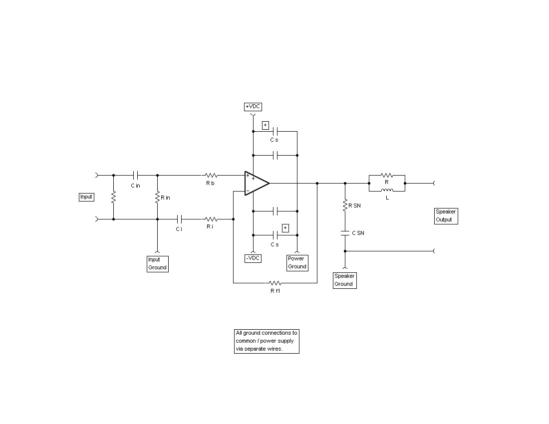

One thing I would suggest is to keep the power, speaker, and input grounds totally separate. It might work OK the way you have it now, but you will get lower noise and distortion by connecting all three back to common or power supply ground with thier own wires.

Nope, separate wires will prevent ground loops. If you have one wire conducting high current power supply and speaker currents, you will risk modulating the low current input ground. Remember, no wire has zero resistance, and you should account for that in any design.

Here's what I'd recommend all beginners to start out with (see attachment). Notice that all grounds have separate conductors back to common (or "star" if you prefer) power supply ground. This will eliminate or at least minimize the possibility of noise and distortion caused by ground loops.
As for the proper value of feedback cap (C i), it depends on value of feedback resistor (R i) as determind by formula; 1/R*C*2*PI), and should be no more than 1/2 the frequency (much less is better) of input filter formed by C in and R in. In other words, if input filter has a corner frequency of 10Hz, the corner frequency of the feedback network should be no higher than 5Hz, but even lower is better. The reason for this is you don't want the amp to recieve frequencies that the feedback loop can't control.
Hope this helps.

Rsn+Csn return to the Power Ground via the shortest possible route that the PCB layout will allow.
The PSU Zero Volts and all the other "grounds" must be taken to a Main Audio Ground (Star)
Add RF attenuation across Rin.

Infinia, I'm affraid I must respectfully disagree, if you use a common ground conductor for small signal and high current paths, you will get elevated noise and distortion. A very good test for this is to listen to the amp output without any input signal (as in shorted input) through headphones. I do this with all my designs. When it's right, the most you will hear is barely audible thermal noise (high frequency "hiss") and nothing else, no buzz or anything else. Besides, as I said before, adding a wire or two is cheap and easy, and just plain-good design practice.

It's all good, your diagram is useful. I just wouldn't call the chip amp ground "power ground", cause most of the power actually goes through the speaker return. I recommend that the input return should tie to center point of the HF decoupling caps 0.1 uF for the single PCB ground. Sometimes a problem arises when using in a system with 2 different boxes with two different PE's connections, then the noise or hum wants to travel between the two boxes on the input RCA cable shield. (ie ground loop) Then it's useful to use a small resistor in series on the input signal ground, thus forcing the bad hum or noise currents to take another route. Most times all this 50/60Hz hum can be avoided with using a common PE connection. Also the Zobel needs to be shown at the IC ground not at the speaker.
If the Out- were connected to the PS gnd star then all "issues" are pretty much solved.
