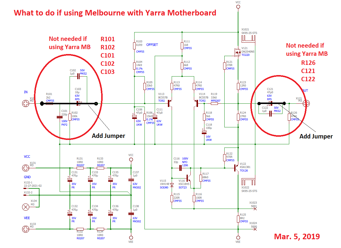

Vunce had a very good question as he was working the BOM/Shopping Cart for Yarra and Melbourne. Which components on Melbourne can be left off when using it with the Yarra MB? Note that Melbourne was designed to work as a standalone preamp - that's right, all that is needed are +/- power rails with a GND, and feed your signal in and get signal out. However, on Yarra we have room for big fancy boutique caps. So here are the parts you can leave off of the Melbourne and replace with a jumper. The output AC coupling caps are optional as Melbourne is designed to have close to 0mV DC offset (as high as 20mV depending on luck). You can tweak it by adjusting some resistor values if desired.
