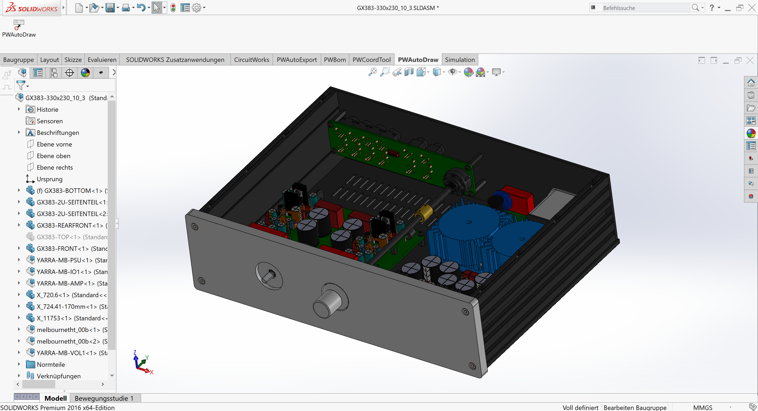

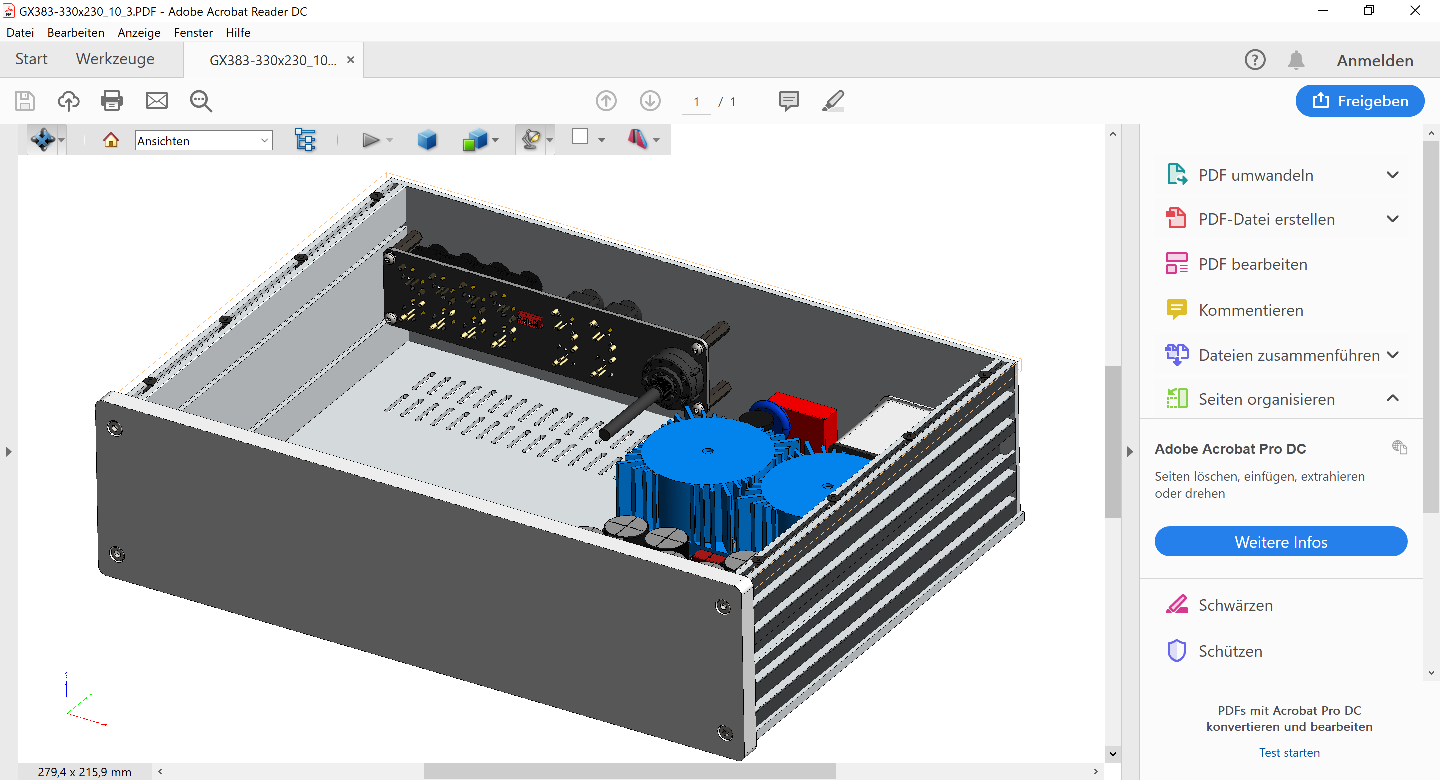

YARRA enclosure - weekend progress
Hello,
IO and PSU PCB placed and rear plate drilled (silkscreen or digital printing later).
We´ll place tomorrow the preamplifier with Melbournes and check the different spacer for the different potentiometer variants.
Finishing with engraving.
Hoping finishing middle of next week so we would inquire and get an offer till end of coming week.
P.S.: someone who can/will share (Google Drive) 3D PDF (1.39MB) so I´ll send him file with email.
JP

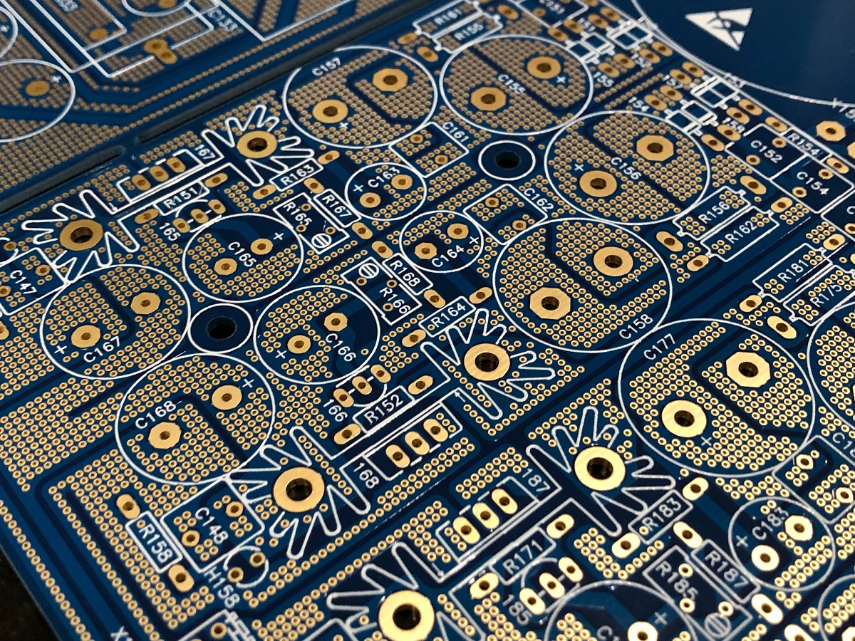

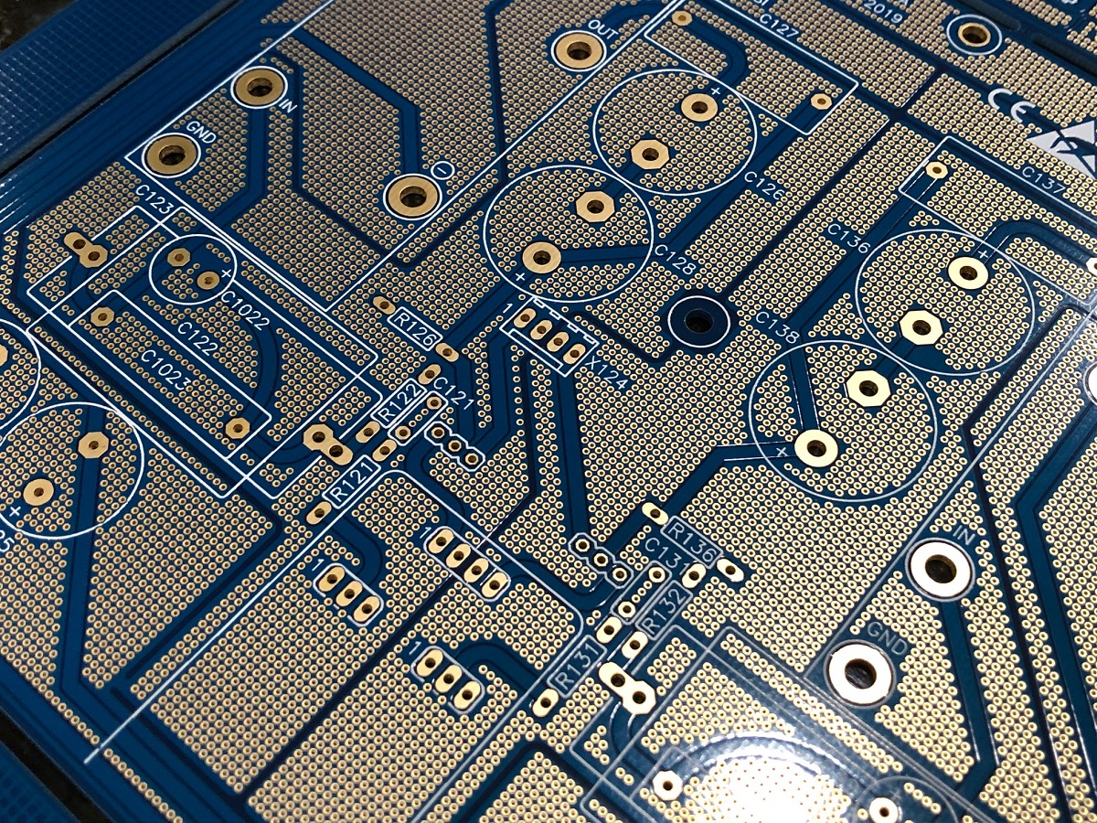

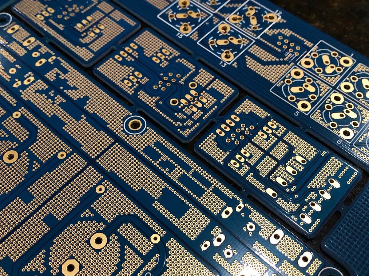

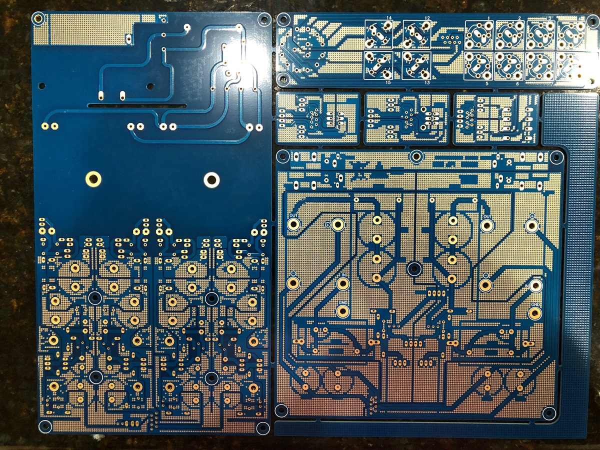

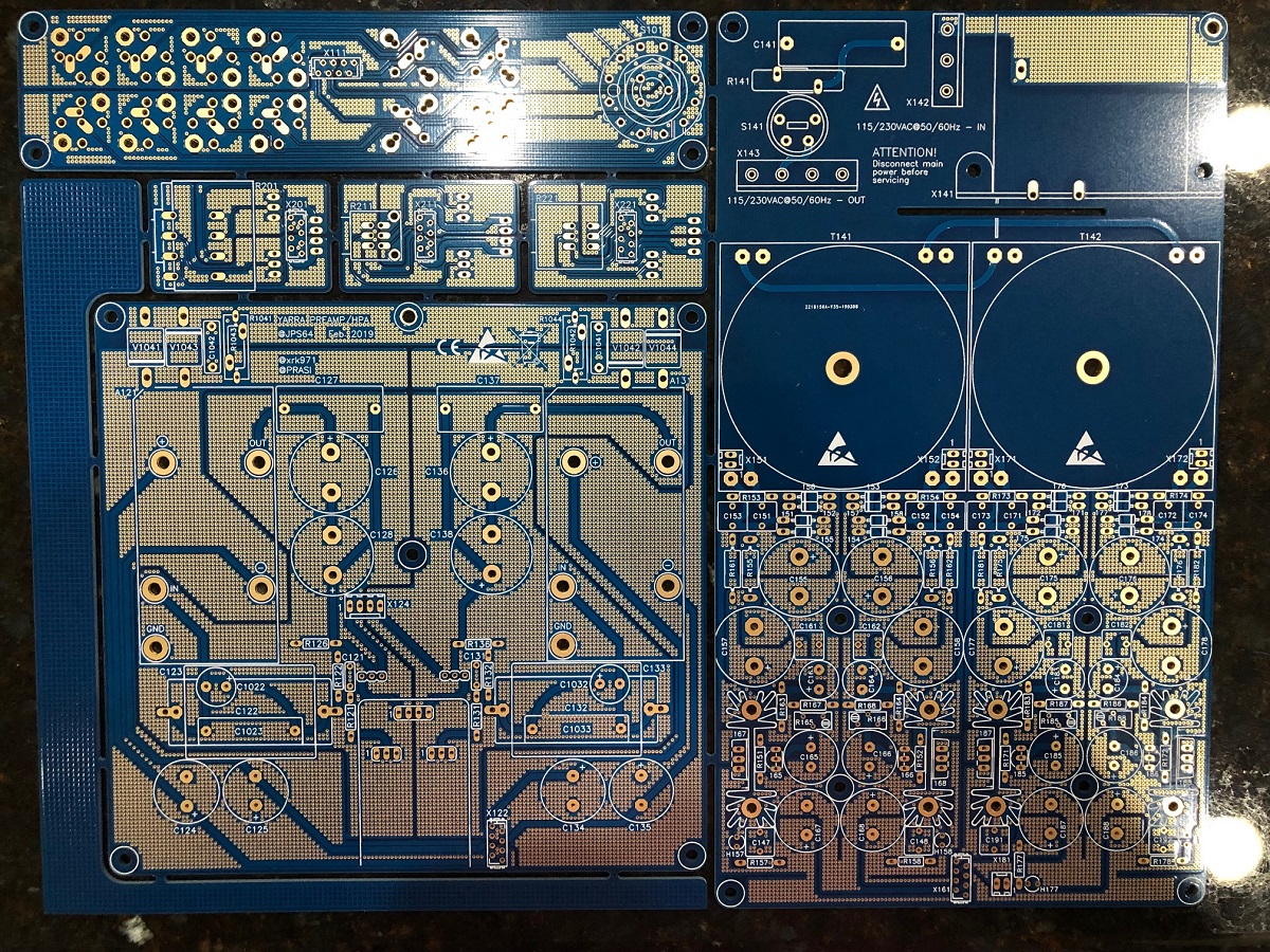

The version 1 verification build boards are here. They are 1.6mm but with 2oz copper and ENIG. These are perhaps the largest amplifier boards I have ever seen - about the size of a PC motherboard before you break apart the small sub panels. Here are some photos plus detailed closeups to show the master strokes of JPS64 at work. This is true art. Thank you JP for an superb layout and design!
Top:
attachment.php
Bottom:
attachment.php
Detail of Cap Mx PSU (thanks to design inspired by Prasi):
attachment.php

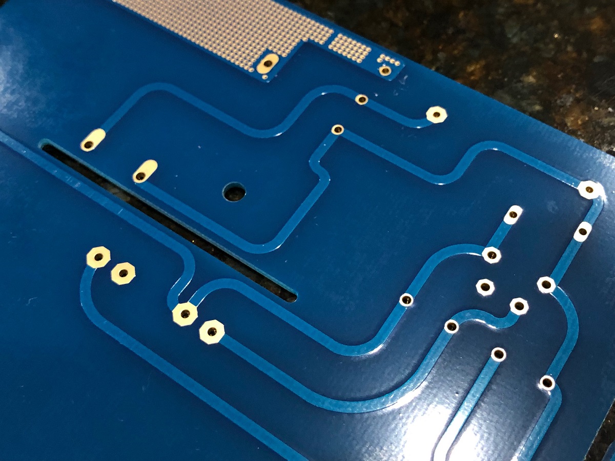

Left and Right ground planes split down the middle of a 4-pin JST jack:
attachment.php
Detail of the 3 different volume pot boards for connecting the wires with less strain:
attachment.php
Detail of the nice curved AC primary traces from the IEC to the transformers:
attachment.php

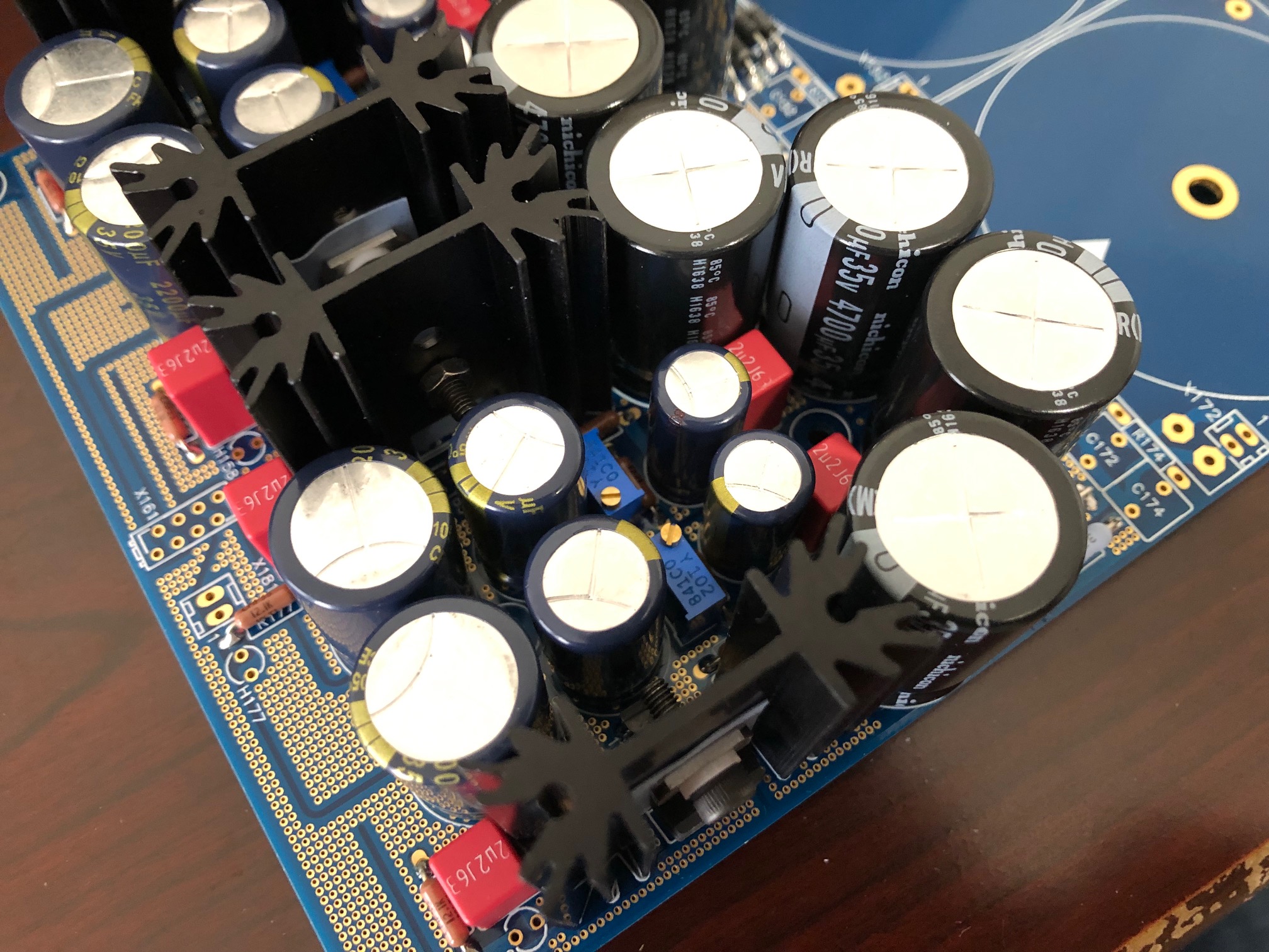

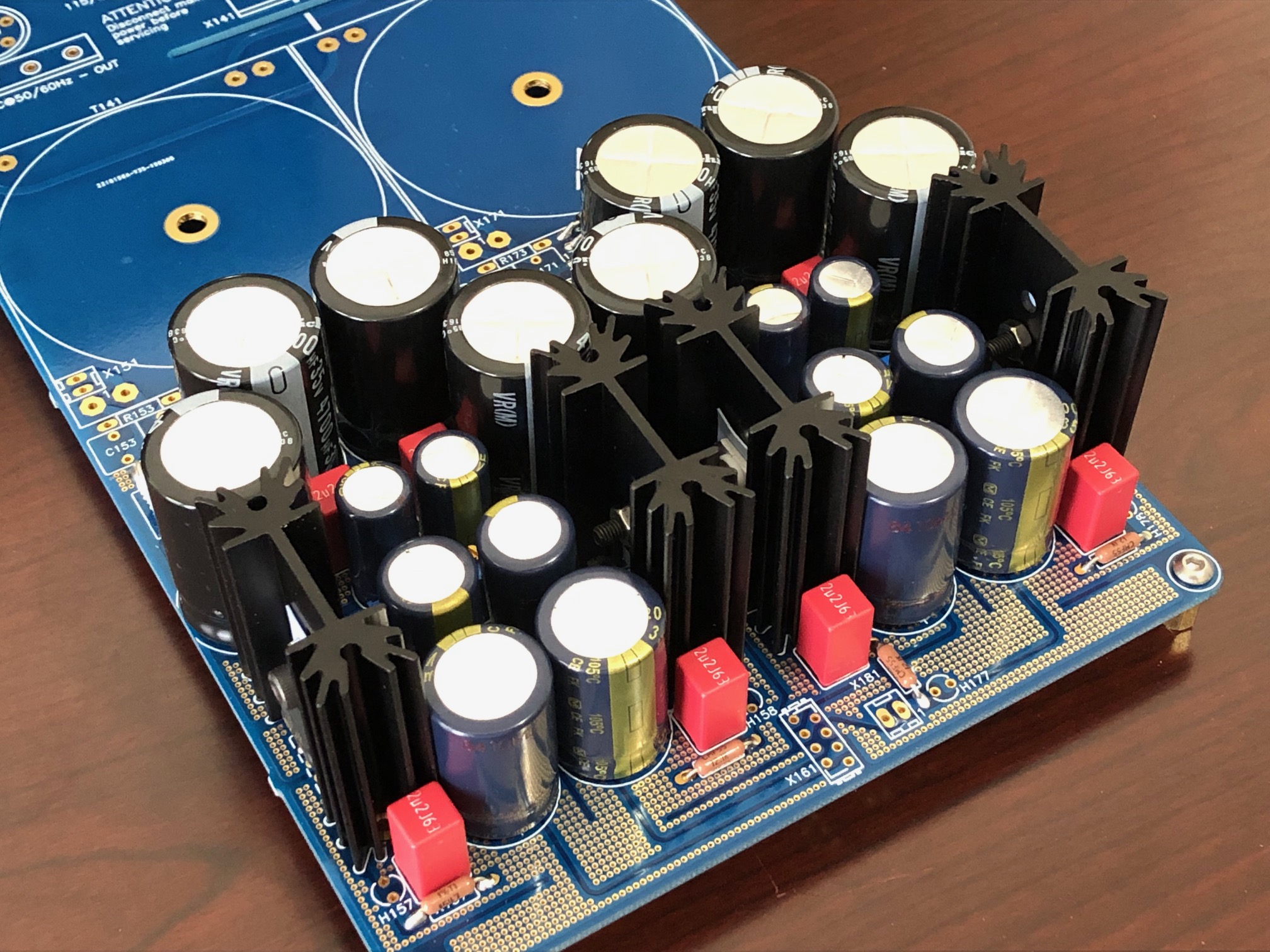

Progress on verification build: PSU is populated mostly. That’s a lot of caps! Quite heavy now with all those Panasonic FCs and Nichicon KWs. Will use a temporary external trafo to apply power while waiting for Talema to arrive.
