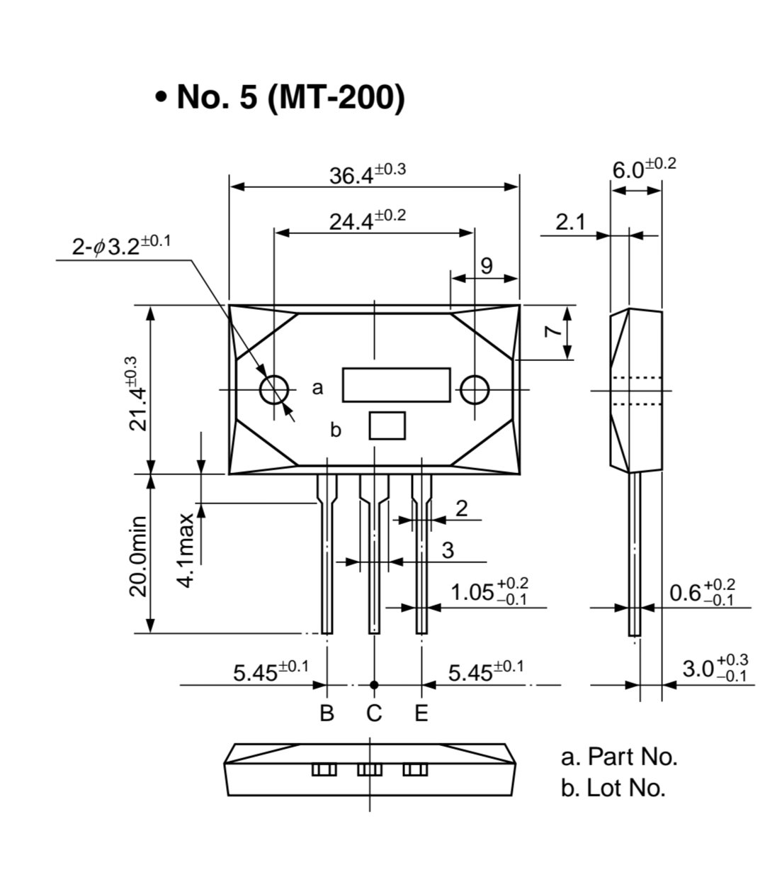

I am going to use mt200 sanken output. Is there a problem with ef-5 ?
The MT-200 can not be used on the EF3-5.
The transistors on the EF3-3 and EF3-4 are spaced at 40mm. For the EF3-5 the transistors centres are 30, 30, 30, 30, 40, 30, 30, 30, 30. The outer two transistors are in the same horizontal position as the EF3-4

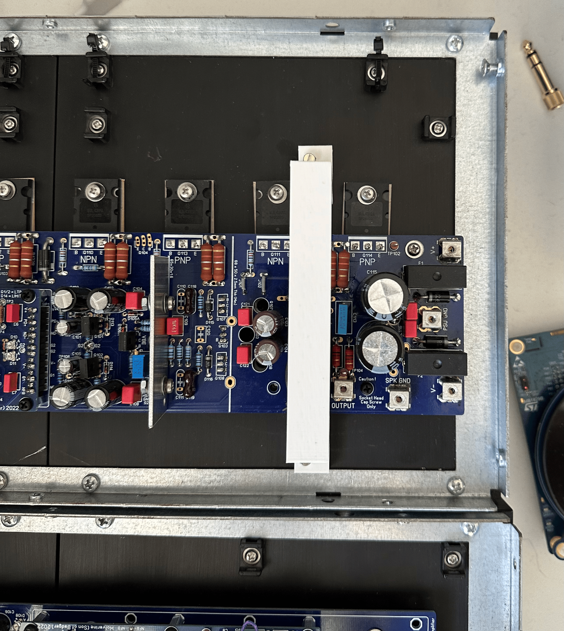

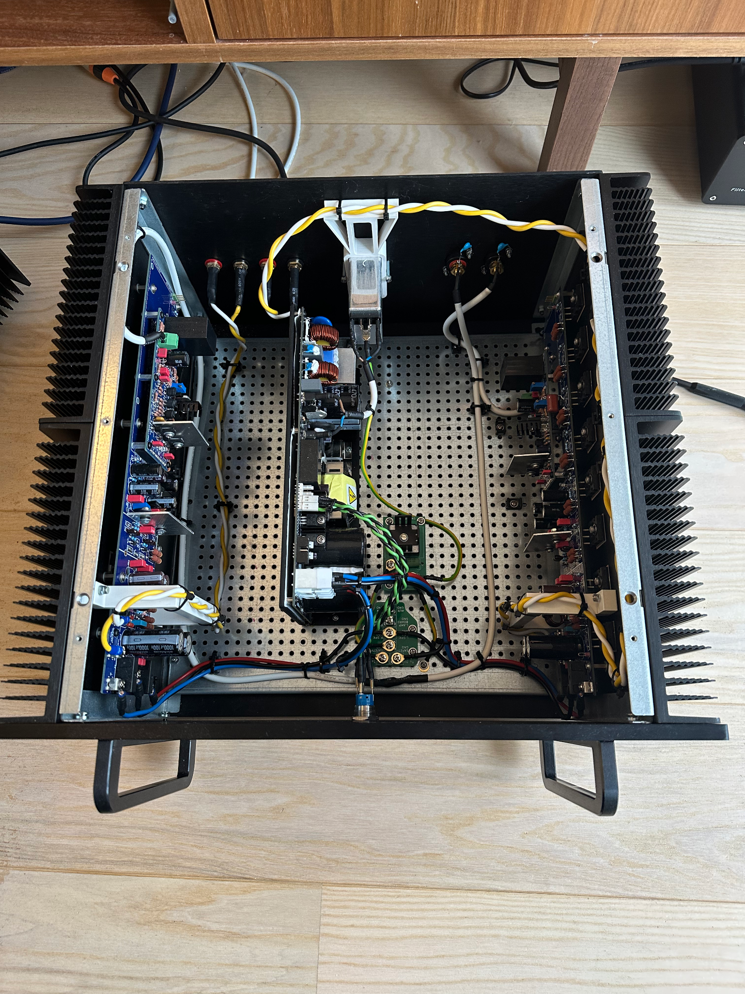

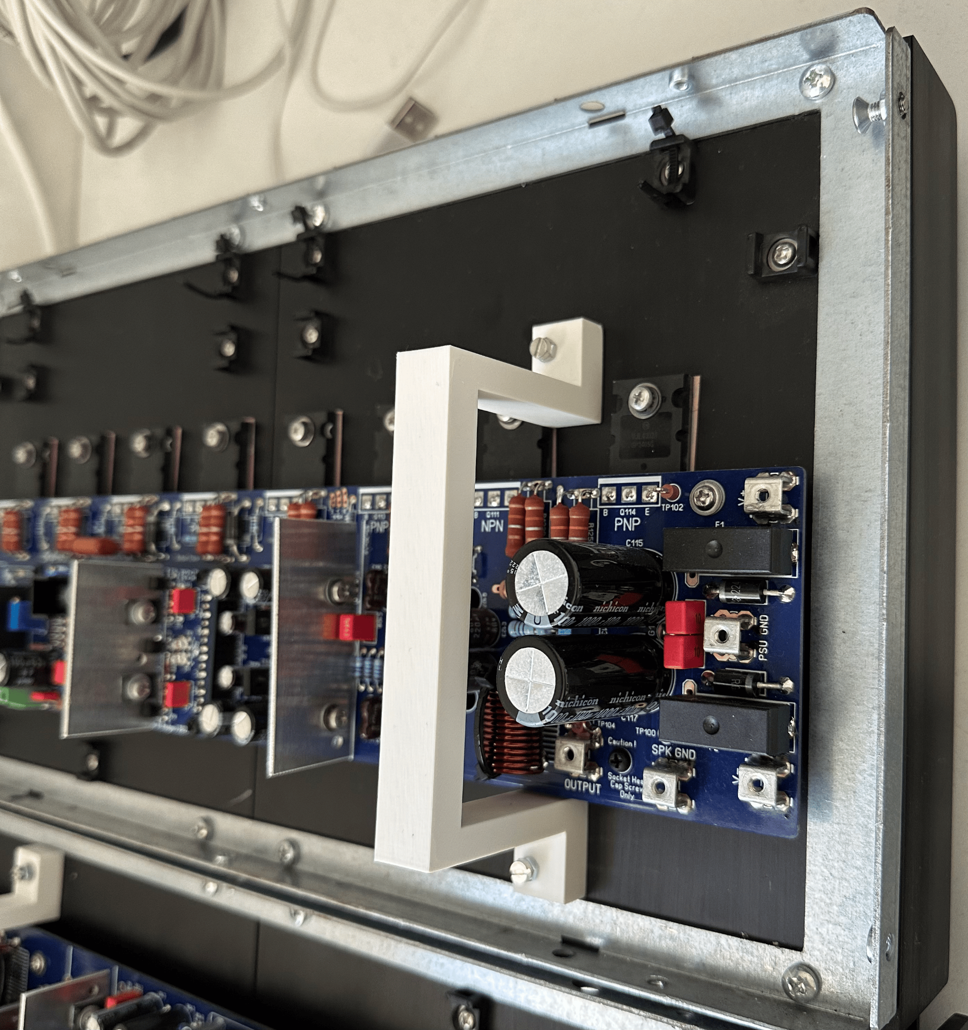

Hi guys.
For my Wolverine V4 build I designed some simple 3D-printed wire bridges to jump the output from one side of the board to the other.
If there's any interest in something like this for the people in this group buy, I can update the design to make them a bit prettier and supply them for this group buy with the help of Stuart. You'd then be able to buy them together with the boards from Stuart.
They're printed in ASA plastic, so there shouldn't be any concern regarding having them mounted on a warm heatsink. I have attached some images of my own Wolverine build and a close-up of the installation.
If there is enough interest I can print a bunch and sell them to Stuart for no profit and he will sell them for the same price. I doubt it will be more than 5$ per bridge, though I haven't done any math yet.
Please reply or DM me if you might interested! 🙂
