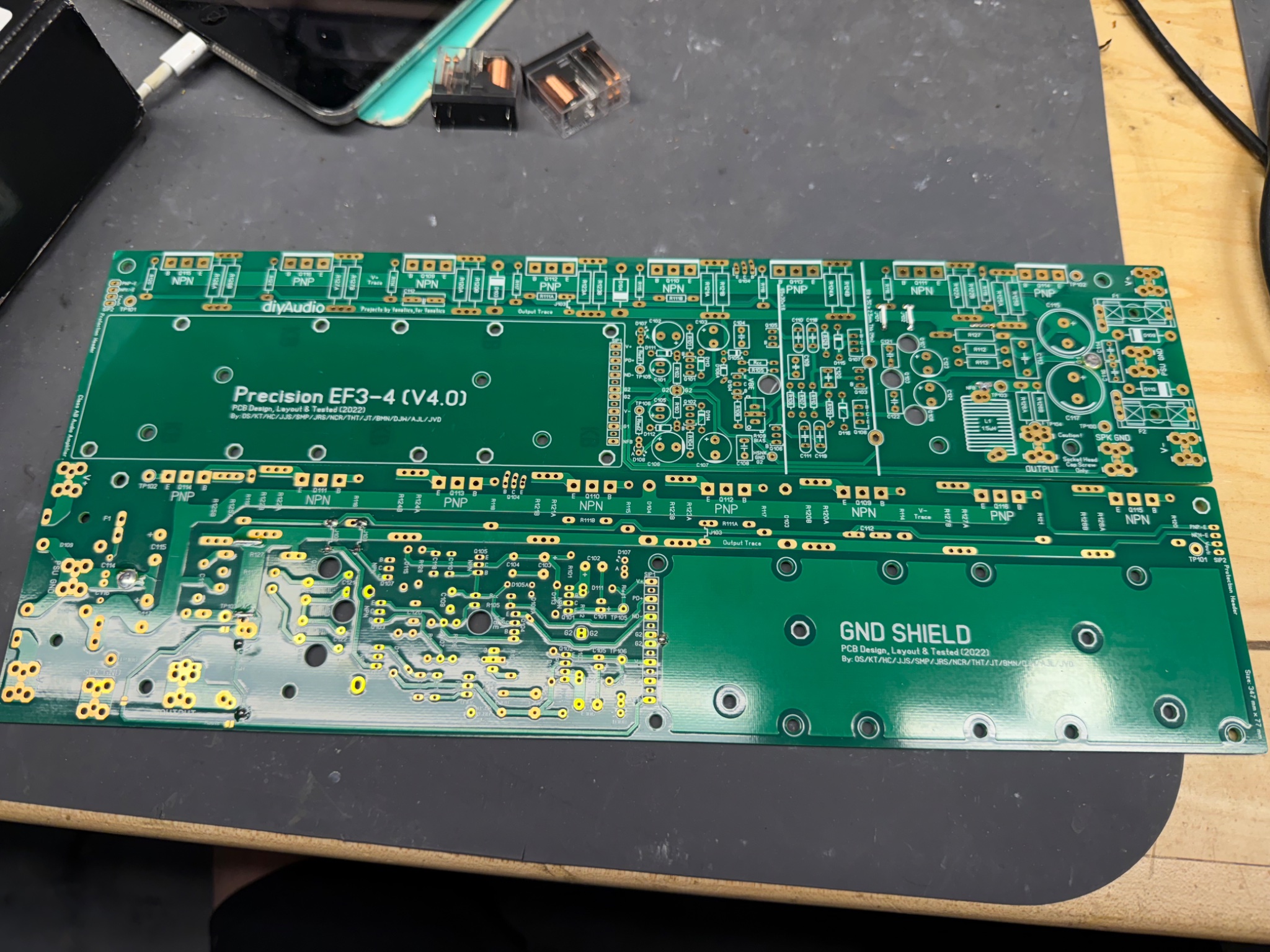

So far the updated spec-sheet only shows enhanced rail voltages beyond ±71VDC for the EF3-5. Is there any chance this will do for an EF3-4 V5 if components are selected correctly?

Looking at the data sheets, the MJL21193/4 appears to have double the 100v SOA of the MJL4281/4302 pair.High chance of being fakes with many of the MT200's. Unless maybe buy from a brick and mortar store in Japan that can show you some parts tracing.
FWIW Those transistors aren't on the BOM list for the amp. (Thats not to say they wont work, they just aren't tested or proven)
The biggest, baddest output that is still readily available is the MJL4281/4302 combo.
They are slower however and not as linear with increasing current drain.
Overall a more durable output stage though?
