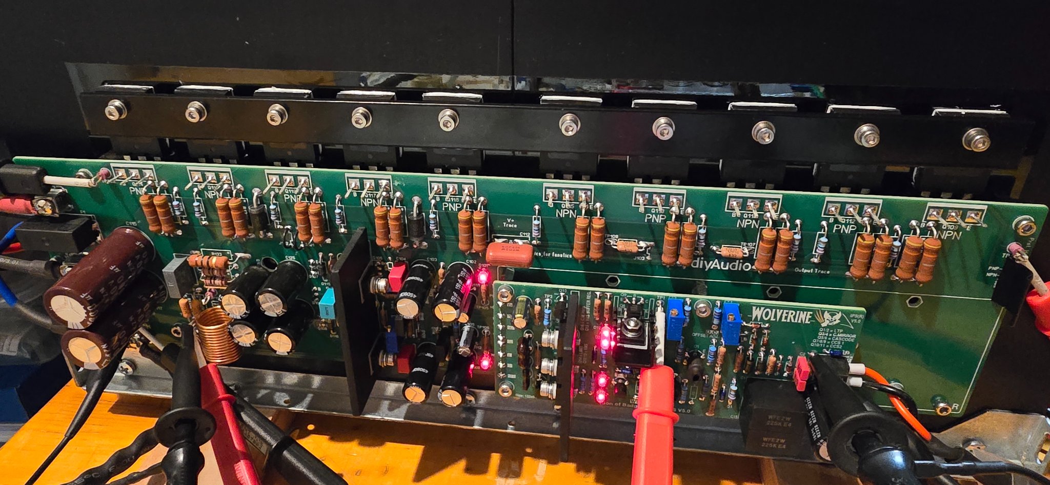

Hi Guys,
Here is a picture of the V5 EF3-5 test build officially up and running, also a mock up layout for the mirrored channels, enjoy!
Wolverine 5th Group Buy - Boards Tested, Order Imminent!
Hi Guys,We’ve hit a thrilling milestone in the Wolverine 5th Group Buy! I’m ecstatic to announce that the building and testing of the following boards are now complete:
- Wolverine IPS V5 Left & Right
- Precision EF3-3 V5 Left & Right
- Precision EF3-4 V5 Left & Right
- Precision EF3-5 V5 Left & Right
A huge thank you to @danieljw and @Mainframe for their incredible dedication in building and testing all production versions of these boards. Their hard work was a massive undertaking, and the entire Wolverine Team is blown away by the results. Your efforts have set the stage for an amazing group buy!
Over the next week, I’ll be finalizing the Gerber files for the group buy order. We’re on track to place the bulk order in 1-2 weeks, meaning these boards—complete with the stunning gold ENIG finish—will soon be ready for your builds. Fabrication typically takes about a 1-2 weeks, followed by 5-6 days for shipping, so we’re not far off!
If you’ve been hesitating, now is the time to join the 5th Group Buy! Don’t miss out on this chance to get your hands on these high-quality boards, perfect for everything from standard setups to demanding 4-ohm loads. For all the details, including pricing and the Excel order sheet, check out the first post in the Wolverine 5th Group Buy thread. Simply email your order to stuartmp@internode.on.net with the subject “Wolverine Project – Your DiyAudio Username.”
Thank you all for your patience and enthusiasm—this community’s passion is what makes the Wolverine project thrive. Stay tuned for more updates in the Wolverine Build Thread and Development Thread, and let’s keep building something extraordinary together!
