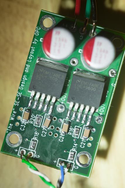

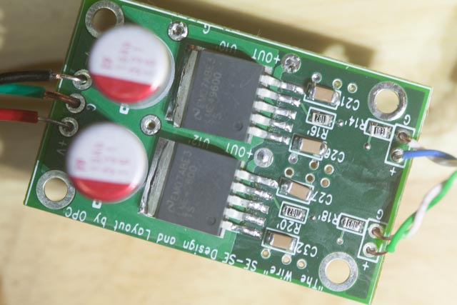

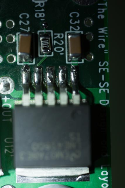

I got the power supply (PSUv1 - #2) to supply +-12VDC. The SE-SE works in one channel - but the other just has a low "hum".
I even tried some Bruce Cockburn on it 🙂 - but still just one channel.
Based on my soldering skills, I need to at least touch up the bad side. Hopefully, I did not overheat anything. I will try to take pictures if the touch up does not work.

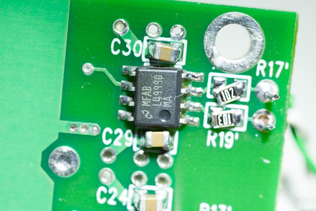

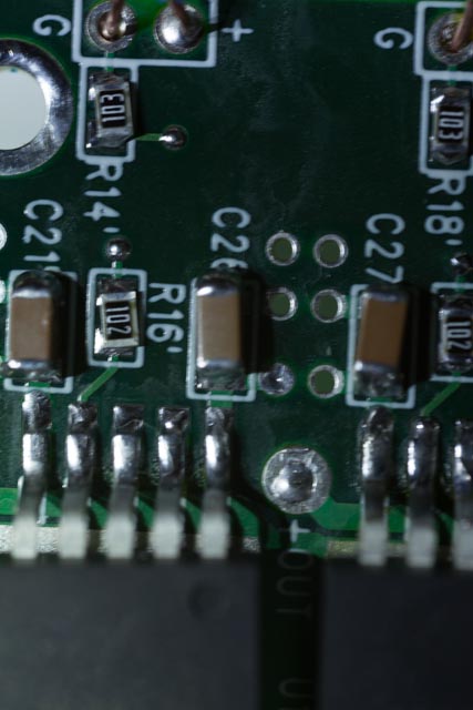

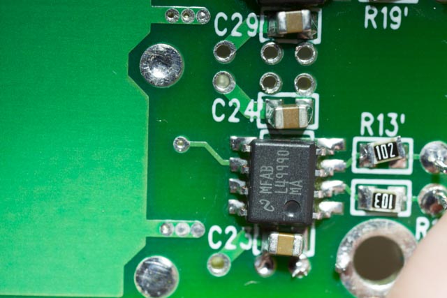

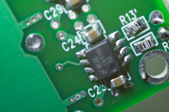

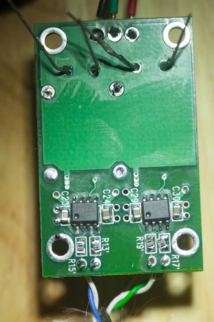

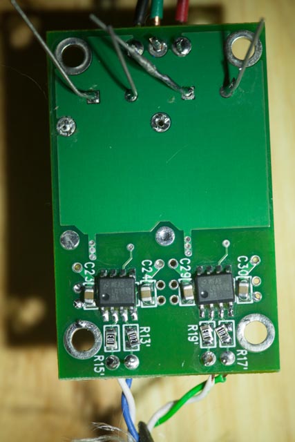

SE-SE one side silent
Please let me know if you see anything. One side works (sounds good!). My test is just to touch the headphone leads to the +OUT and G. (You can get new cables for HD800s - right? 🙂)
U10/R14 (C24 other side) - works
U12/R20 (C30 other side) - no sound -
These pictures show more than I can normally see - maybe just R17 and R19 need to be straightened out?
Thanks for any help or suggestions!

Better, as I see no grey soldering. Grey is not the colour you want. You want nice a shiny. Next up. A good solder job will leave the solder nicely sucked into the component in a clean fillet between the component pads and the pads on the PCB.
Some of your components are way to crooked to leave be.
R13 and R17 especially.
Last tap on the opamp, beside the SE-SE designation may be suspect as well.
If you have a magnifier , well it is your best friend. One of those that has a light and an arm to hold it is my best friend. When things get smaller yet I have a surface mount stereo microscope I picked up real cheap.
O think you have enough solder on most of the tabs. A reheat and a position with a toothpic to hold them in place while the solder sets may be all that you need.
It is definitely looking better.
And you have one channel running.
Plus you have probably deduced correctly that you were not regulating the output in one of the boards. Progress!
And light at the end of the tunnel.

Agreed with Mark, and to add, the top side of R16 in picture two looks like it hasn't been soldered correctly. The solder may be stuck to the pad, but it doesn't appear to have flowed onto the resistor.
In pictures 3 and 4, the GND lead on the large poly caps also looks like it hasn't been soldered.
Good news is that all the ICs look pretty good, but the passive parts need to be re-aligned. Some are unacceptably crooked.
Based on the pictures, I'd say you're not getting enough heat onto any of the joints, so either turn the iron up, use a larger chisel tip, or take a little longer on each joint. The solder should flow freely and set to a nice shiny finish as Mark suggested. Also, if you're using lead free solder, go get some leaded stuff. Not so great for the health, but much better for the solder joints.
Owen
