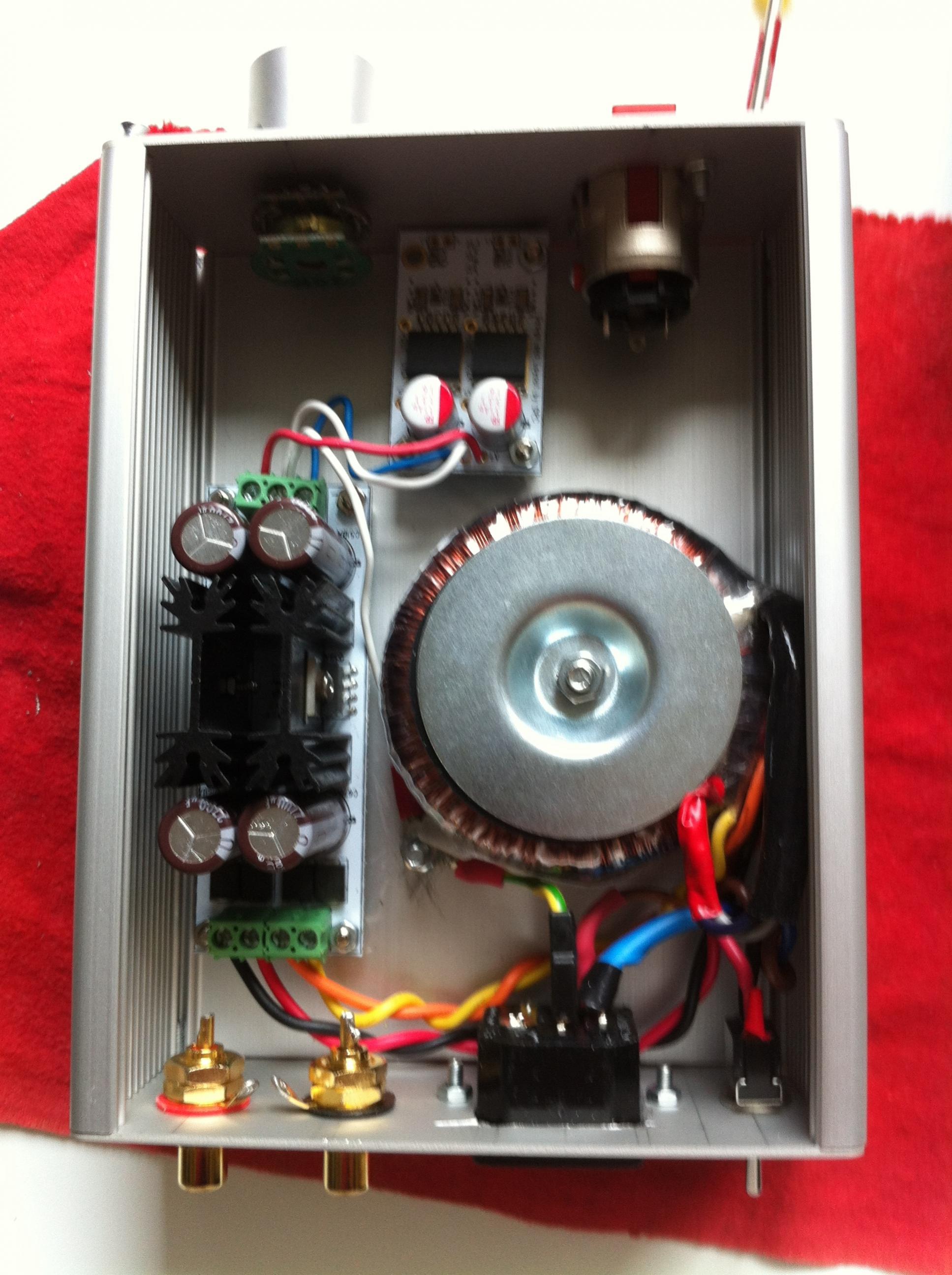

finally I got some time to continue my Wire building SE-SE v2.
I connected both main power earth and PSU G to chassis star ground.
Do you think is OK? (see attached picture)
Do you think is also useful to connect the amp G to the chassis star ground?
PSU test was OK (+-15VDC at output). I connected SE to PSU and it did not blow and also light bulb test was OK.
Last step is to connect the signal wires.
northernsky
