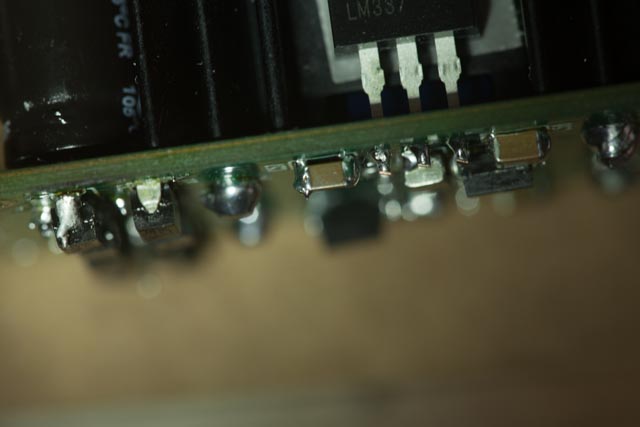

To Troubleshoot PSU (v1)
Hello
first smd project
First tried PSU v1 (had kit sitting for a while)
The positive side is around 15VDC but the negative side .... (0.5V ) I think
I can get a picture soon if that could help.
Are there any "flowchart" for trouble shooting PSU that you all might know of. (That is not for PC power supplies)?
I will start with schematic - I guess look around the LM337T
Do I need to remove components from the circuit?
Thanks for any help or suggestions

First Power down.
Second build a mains bulb tester.
Third test the wiring of the transformer alone. NOTHING on the secondaries.

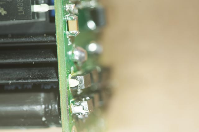

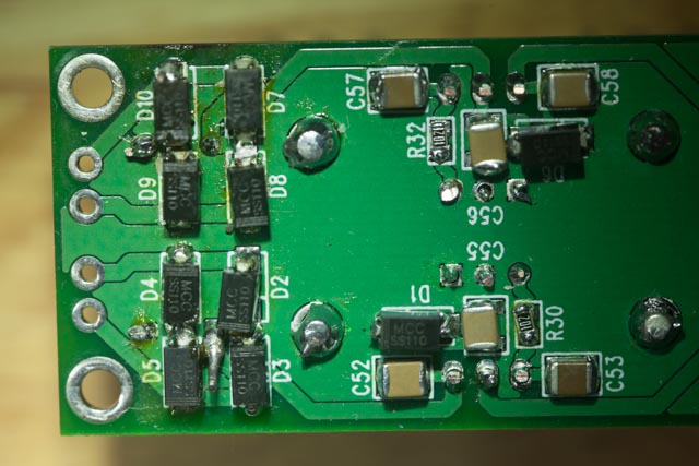

Hi ghellman,
Andrew is correct, and you should probably test the transformer alone to rule out a serious problem. Please be cautions while doing this!
Next up, we would need good pictures of both the top and bottom. There might be a short or a cold joint somewhere and that might help us find it.
If we still cannot see anything, I will need to ask you to measure the voltage at a few points on the board so we can narrow down the possibilities.
As an obvious test, can you make sure both regulators are properly isolated from the heatsinks by measuring the resistance between the tab of the reg, and the heatsink itself? Use the solder points for the heatsink as the black anodized surface is generally non-conductive.
Owen

the resistance between solder points and tab:
317 : 2.8K ohm
337 : 0 ohm
at PSU output:
The 317 (V+) : 5.12 VDC
337 (V-) ... 0.06 vdc
The transformer (antek110) gives 14.65.VAC and 14.69VAC at secondaries
I know (at least) the outside of D10 (topside on #1 pic) is messed up - I tried to resolder the lead.
