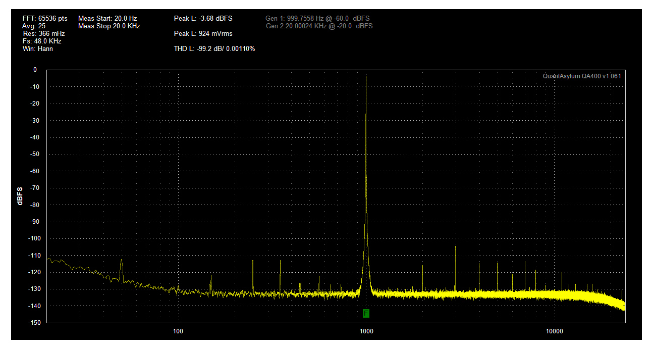

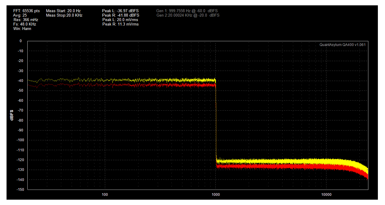

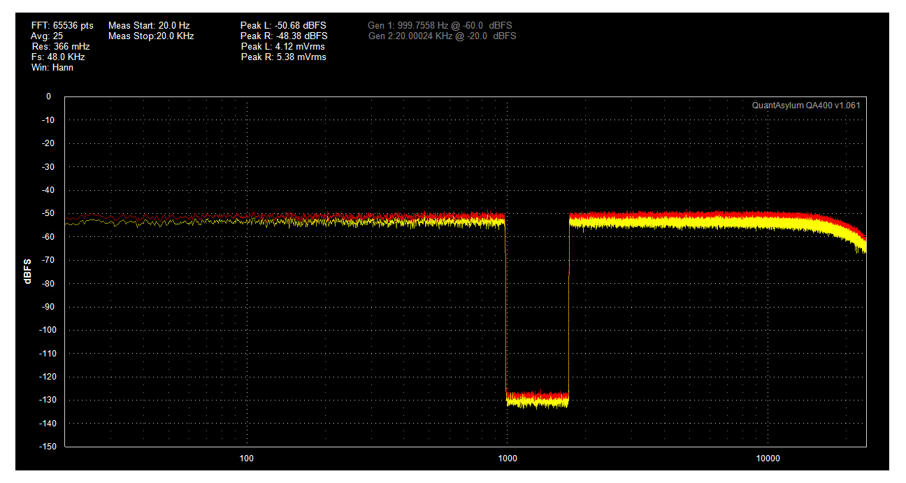

Yes, because you like harmonics and listen to harmonizer amps. The Ti is designed by professionals and it's a good clean amplifier, with exremly low distortion and it's sounding good to me. One only need good headphones and good source material. Here is some measurements to prove my point. The red trace is the source, yellow the amp. Load 33 Ohm s.
