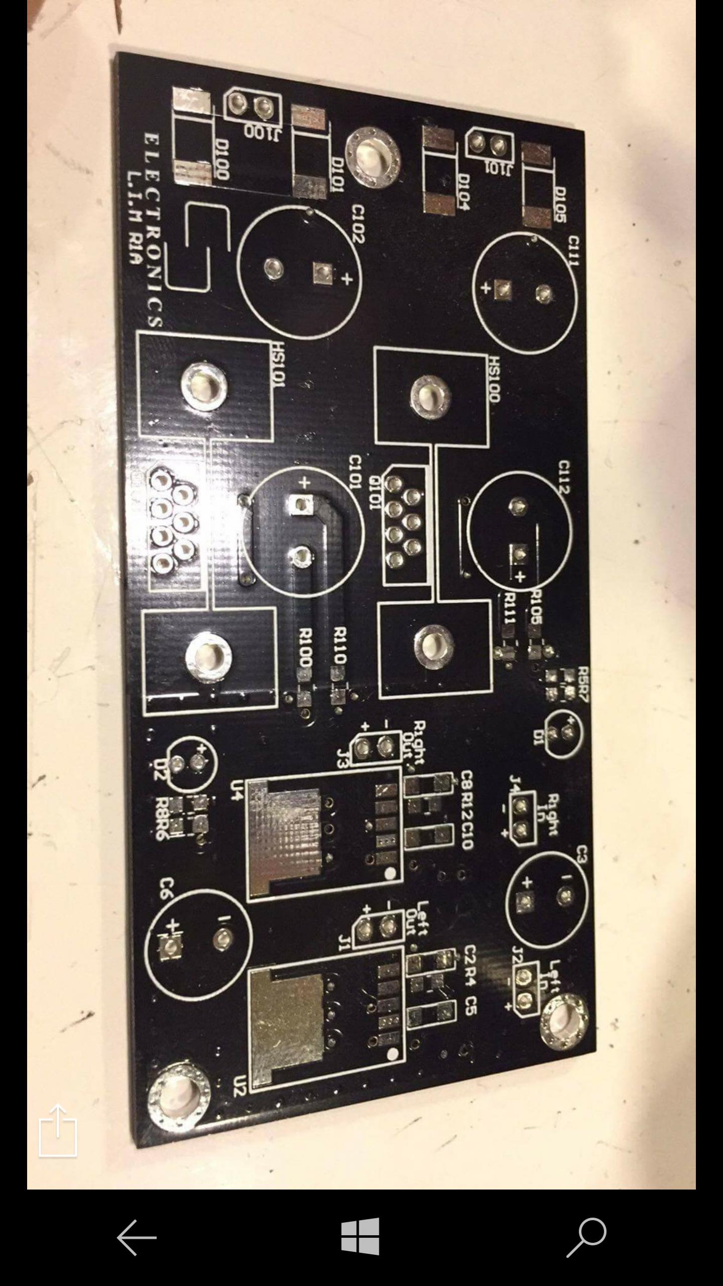

Hello, I've received a custom PCB for the wire, made by a friends friend. I already got the op amps and buffers, how do i find the BOM for the missing parts? Sorry for asking such an obvius question, but I can't seem to find what components and where to place them.
The pcb is with psu included and op amps on opposite side.
Would you consider selling PCBs to people without the skill or know-how to make one for themselves? XD
