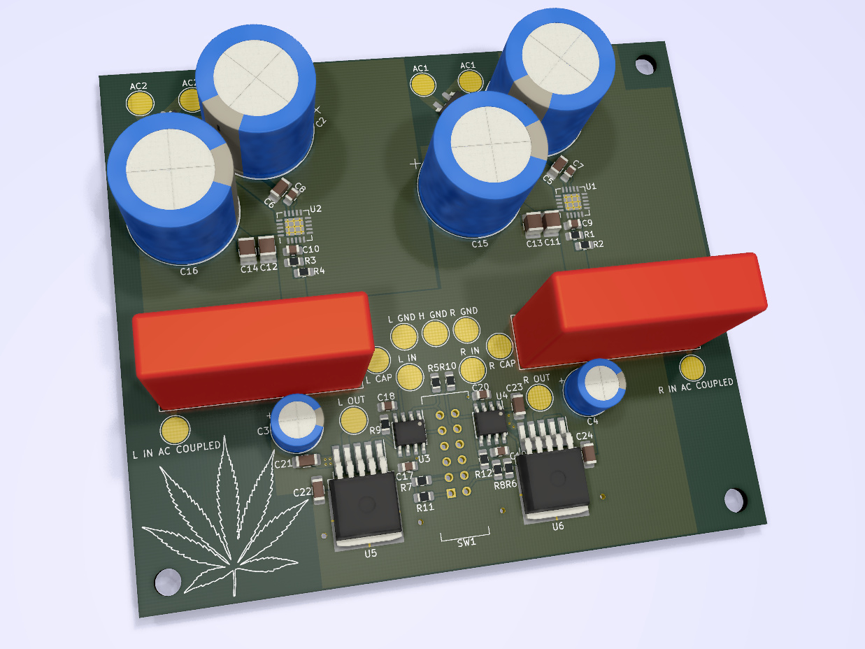

I'll have these boards soon.
This is PSU V2 + SE-SE on a single PCB.
I omitted the input resistors (R13, R14, R17, R18) as I'll be hooking up a nice pot directly to the opamp.
I also added a 1x-3.86x gain switch.
Let me know if you'd like one.

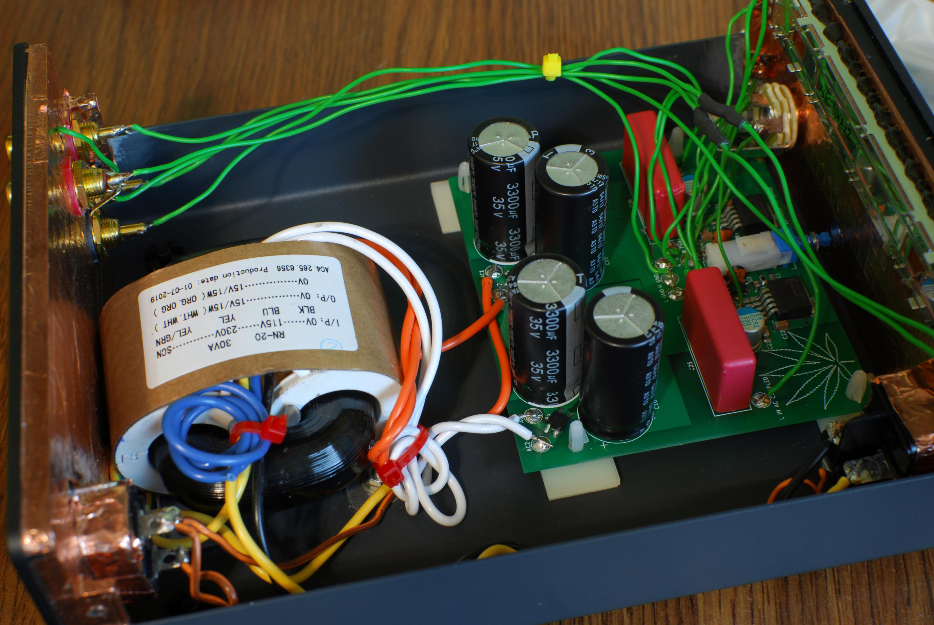

I'm came to the party late but wow!
I've been using the power supplies for a number of years but I didn't finish the two SE-SE boards until this week. I built two of them and they work great, I housed one of them with the wire power supply board.
I've been listening to it for the last two days and I'm very happy. Truly non-fatiguing and a delight to listen to. I really don't want to put down my headphones, I have a bunch of headphone amps and wasn't in any hurry. However, I'm happy I pulled these boards out and finished putting them together.
Those tiny resistors were challenging for my old eyes.:eek: I used a 25K dale stepped attenuator that I built, I didn't look at which value you suggested but this one seems a nice fit and I had it laying around.
Thank you for your effort, Owen, too bad they stopped production of some of the chips, I think a lot more people would have really enjoyed these. I still have a BAL-BAL board and the chips, someday I will get around to building it.
