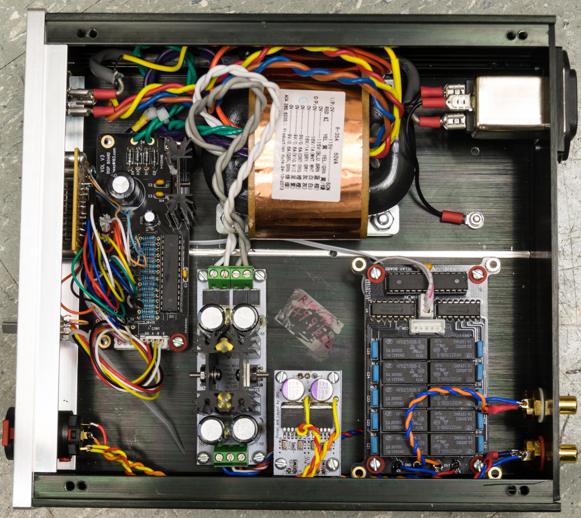

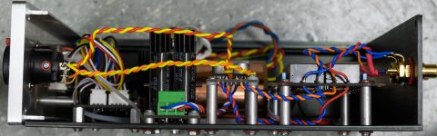

Hi, all. Almost finished my build.
Here it is. Planned for a small/medium footprint desktop amp, paired with a remoted volume control module. CAD/CAM building in our machine shop.
The volume module is bought from a designer in China two years ago. MCU control board (close to the front panel) + realy/resistor network (close to the back plate), 10 relays and (typically) 100 logic sound levels, 3 alternative curves. The pot-like thing is an encoder that gives input to the MCU. The module is programmed to learn any IrDA remote control, so yeah, your smartphone works if it has an IrDA emitter. Very robust and well thought in details. Thank the designer.
R-core transformer ebayed, too. I like it having multiple secondaries feeding different modules in the build. LED integrated switch from radioshack, 🙂. Happen to have a roll of shielded twisted pair power control cable, so used for the mains. Might vialate the grounding rule a bit here.

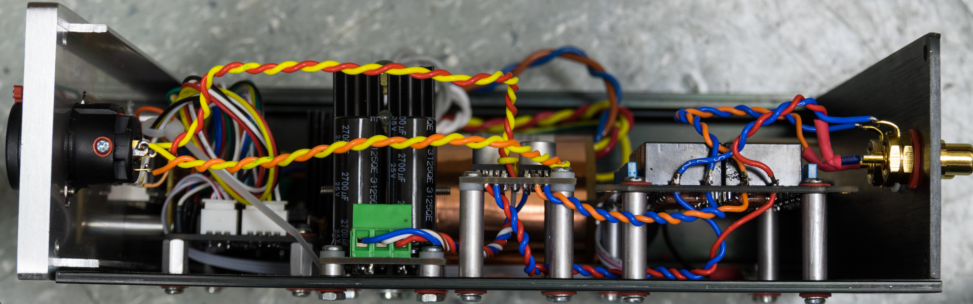

The transformer was pretty close to the circuits due to the small chassis layout, so I milled a slot on the bottom and top plate and tapped a threaded hole, which hold two stacked steel sheet as a isolation plate (plate removed). Not really much audible change in a rush test. Worst case I can paste some mumetal foil, but that is expensive.
The whole job is done on some ebayed aluminum chassis (keyword: 2207S, indicating its dimensions)and took some milling work. The chassis is bit of warped, gave me some troubles in the work. Some misalighnment of holes, breaking drill bits, etc. The seller offered to customize the chassis, at a cost of cource - good for those who have difficulty accessing machine tools. The LED digits were on the control board, and I do not have enough room on the front panel to mount it there. So I built a daughter board and flywired the digits and the Infrared receiver. Congested space there get me layout the wiring in a "feather like" way. They are just constant DC current when not adjusting, so should not be a problem.
I hanged the amp board and relay boards high in the chassis to wire them from both sides - quite convenient.
Thanks Owen designing it. Thank him and all others helped me.

Very nice! I can only hope mine comes out half as good as that😀
Just attach your pics.
Just learnt to scroll down 😀
thank you all for your kind words.
Yet to finish the acrylic cover plate and volume knob. Enjoyed it last night and like it very much.
