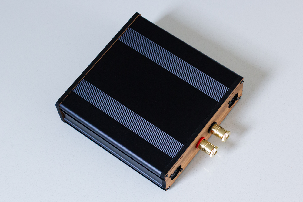

I crammed mine into a 6" Box Enclosures BEX 4 chassis. If you want a little more room, opt for the 8". A fellow DIYer (john) here in Ottawa helped me cut out the front and back panels from Sipo wood on the laser cutter at a local art/tech co-op. The picture is of one of my amplifiers, but you get the idea 🙂
Overall cost was less than $50.

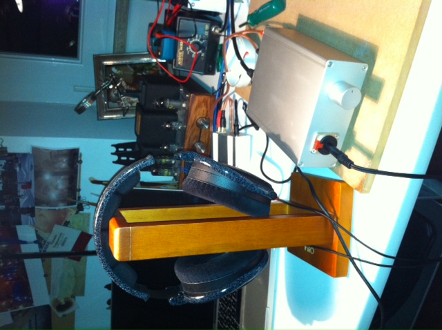

This is mine from Hammond, available on Mouser and RS (I do not know why, but the picture when uploaded is rotated).

That came out really nice do you happen to know the Hammond part#? Did you have to mount your power supply board on its side or did it fit standing up?

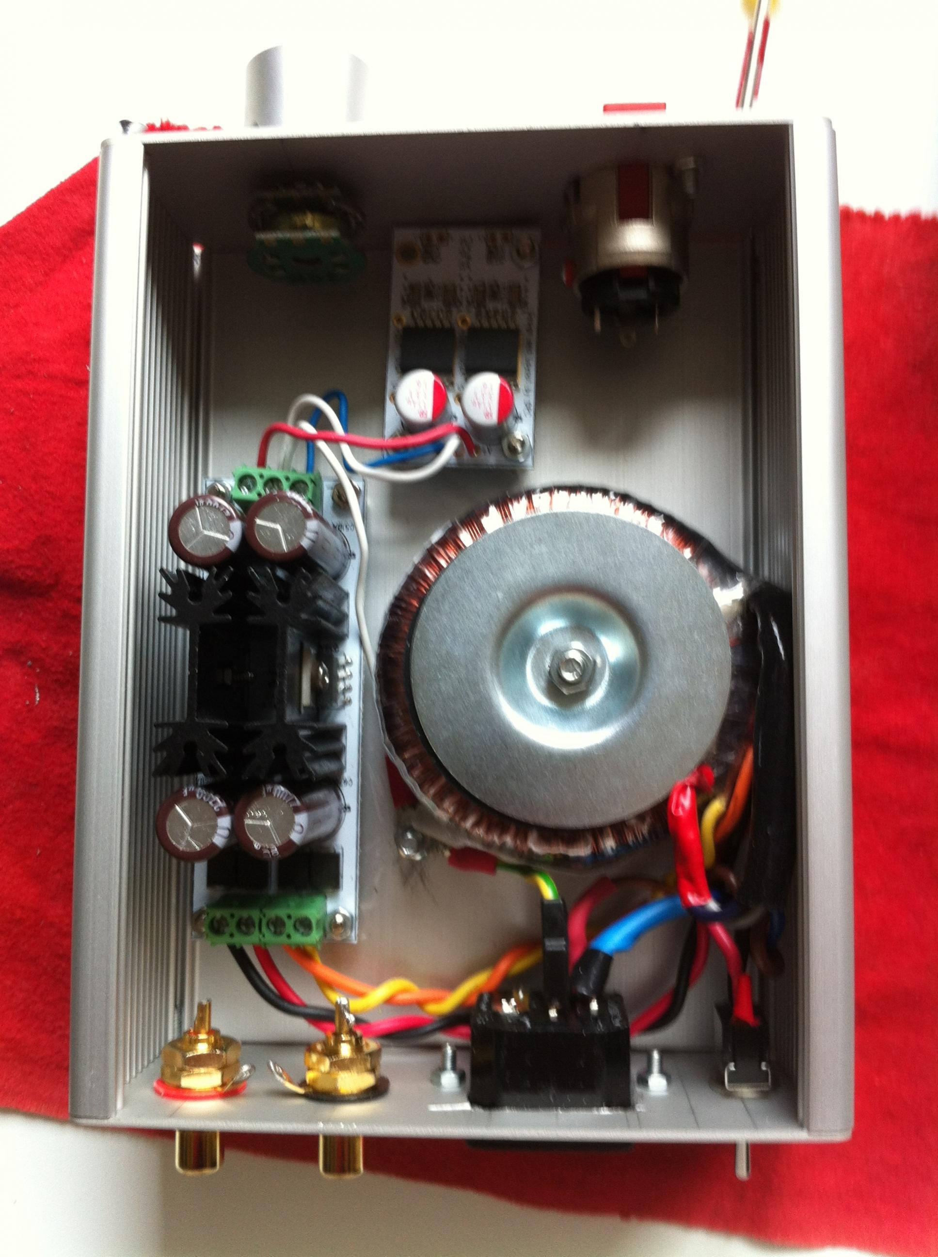

The Hammond product number is 1455Q1601. In the attached picture you can see how I mounted the pcbs. I could put the PSU standing up but I needed to use very short standoffs. The dept of the enclosure is only 160mm; as you can see in the picture the trafo is very near the amp board: no noise at all when it sounds, but now I would prefer the only deeper enclosure (n. 1555Q2201, 220mm deep). I like its Apple Mac look.

Thanks that looks perfect🙂. I think I may go with the next size larger because I planning to add an onboard USB DAC in the future. The one you used looks to be about the same size as my temporary plastic enclosure. It's a little bit cramped but even with the messy wiring it's dead silent even on sensitive IEMs! The Wire really is an amazing little amp😀

can you tell me how did you wire the pcbs to the enclosure ground?
Did you connect the PSU input AC OV to the chassis ground?

All I did was connect a wire from the power supply pcb ground to the chassis ground. I'm not sure if it's the best/right way I just did the wiring the fast and easy way since it was only temporary. Here's a pic showing where I connected the wire from the chassis ground.Hi,
Thank you for your detailed reply; you confirmed my toughts, I did the same.
