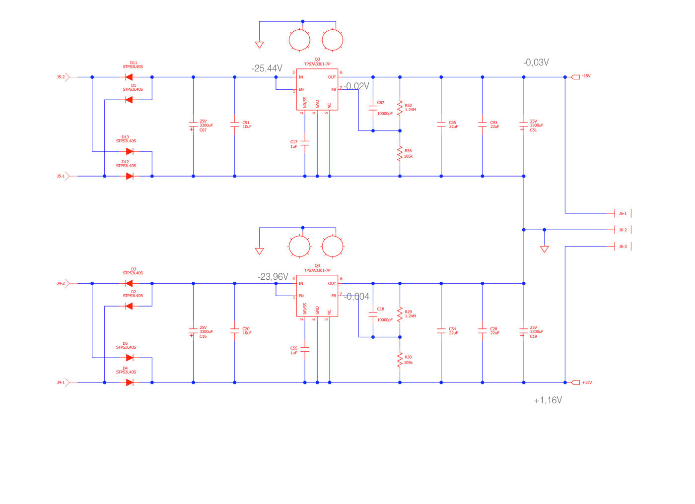

+1.3V is close to the reference voltage, thus, assuming you shorting/mistaking the large resistor (R29/R52)? Vout = Vref*(R52/R55+1). Vref nominal value is 1.175V.Maybe volfsin youtube link was aimed to me maybe I need it. I get -15,3 Volt but only + 1,3 ... out of my PSU V2. Sighhhhh.
what resistors do you go with? the 1.24Mohm on BOM? measuring that with multimeter is a little tricky as there is a cap in par. But I still measure (increasing) 800k+ for 1.1Mohm I used.
I use the BOM values. Thanks for the tip!! Yes, I assume it's a short. The question is - where?
well, anywhere that could short it. Say, are those caps and resistors crooked?
Or, did you reverse R52/R55 (or the other side, not sure which one you were talking about)? That makes it 1.175*(105/1240+1)=1.274V
Yes I would say they are a bit crocked. Does it matter if the component reach outside the pad?
Not if they measured OK.
positive side should be R29 (1.24M) and R30 (105K). check both, from adjecent joint, not their pads/pins

How does one verify the integrity of an regulator "in circuit"? Is it possible? Out of circuit?
Are they sensitive? What could cause its life to end "in circuit"?
if you are talking about the soldering of the regulators, measure from pins' root.
If you are talking about regulator dead due to something... hmmm... I think modern ICs mostly have protection circuits and are not so easy to destroy.
Thanks... but what to measure for? Sound reassuring that its hard to break.
measuring contact, from each pin of the regulator (root of the pins), to adjecent component. Should measure close to 0ohm on all of them, to make sure they are of good connection.
