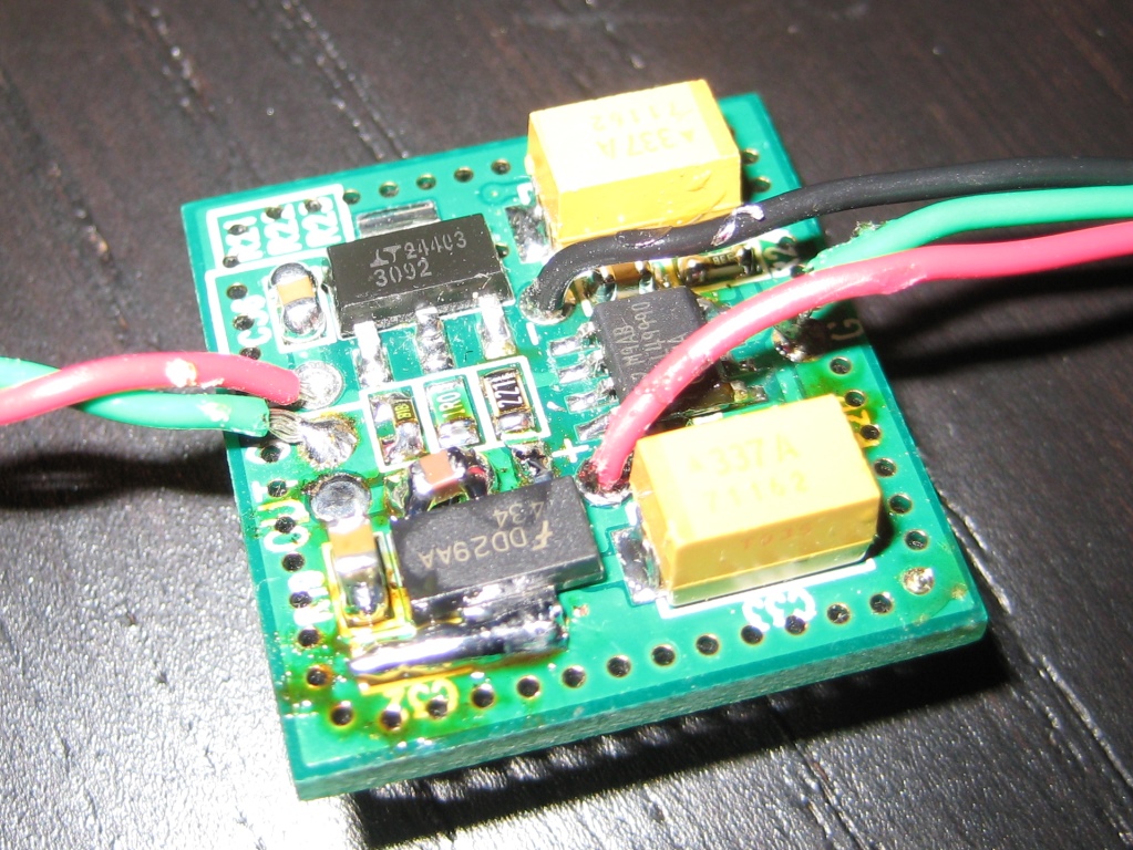

The UHPSR is in final prototype stages, and as you can see in the picture, it's not a pretty board anymore after so many changes, but it performs oh-so-well in its current state :)
I can fire you a few prototype boards to play with for fun, but the real deal should be available pretty soon in a prettier format.
The proto board layout is designed to replace the tridents on the BII or BIII and I think the final version will look much the same as what you see in the picture, minus the puddles of flux everywhere. It's good for 1.2V or 3.3V from a 5V supply, and current can be set pretty easily, but maxes out at 200mA.
A word of warning... it's not a cheap shunt reg to put together, but it's well worth it :)
Owen

It is certainly possible to solder them by hand, but it is very high on the difficulty scale, especially the power pad. To get good dissipation to the back plane, you really should be using 5 to 9 smaller vias, which makes soldering tricky.
My original plan was to have a run of TO-247 size regulator daughterboards built up, and provide these along with the PSU to allow people to use to TPS7A4700. These boards were designed to bolt up to a heatsink just like a TO-247 pack, and the power pad is brought back to the rear ground plane to allow for good dissipation. I use these for prototyping, but decided that buying all the regs and having a panel built wasn't the best path forward. It would have dramatically increased the cost of the PSU, and if people really want the 4700 regulators, they can always look into the finished products I'm working on :)
As for the mystery board, you went a little too far in the opposite direction.
It's a low voltage DC coupled NTD1. It uses the NTD1 as an I/V converter, but with lower gain and much lower resistor values which allows the current to stay high (150mA) with reduced voltage rails. It's also makes the common mode DC voltage at the output low enough to feed directly into a OPA1632 which makes up for the lower voltage gain of the NTD1 by applying some additional voltage gain. This circuit allows the I/V to do what it does best, and the op-amp to do what it does best, all while keeping power dissipation in check. It simulates beautifully, but we'll see how it makes out in the real world next week! I know people have been anxious to get rid of the coupling caps, and this is one way to do it.
