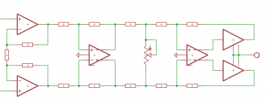

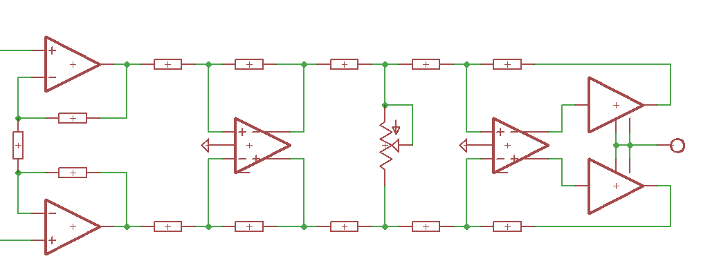

My current question (open to everyone, of course) is this:
I'm considering fully-differential op-amps (input and output, i.e. LME49724, THS413x, OPA1632, etc.).
As has been discussed, the H-pad (differential shunt) doesn't attenuate common-mode signals.
But won't an instrumentation stage (i.e. as suggested in Bruno's G word demo, just with differential output) already have taken care of that?
In other words: How much common-mode distortion is there at the output of a proper instrumentation amp, considering that they typically have CMMR in the order of 100dB or better?
I was considering such an instrumentation amp with a shunting volume pot in front of a BAL-BAL Wire... :D
I'm pretty sure I could leave out a couple of components, but the general idea is this:

Andrew, thank you! Today is the first day I've had time to look through the links etc., due to a crazy project at work. I thought I understood adding a volume control, but it is more involved than I realized, and the links do a great job of explaining the issues. My original plan was to use a stepped attenuator with 0.1% resistors in it. I wonder if this would track well enough to keep the CMRR a non issue?
If you need balanced to minimise interference, then the variation in switching resistances will limit the attenuation achievable and is likely to be variable.
If balanced is just for the sake of maintaining a good signal where interference is not a big issue, then switching resistances may not matter much.

Interference is really not an issue for me in this application, but the efficiency of using a bleed appeals to me. I've been looking more and more at the "fig17b" circuit (resistors in front of pot used as VR to bleed phases together) and wonder if with these resistors in circuit, do they replace in input resistors in the bal bal wire? Having 5k resistors there, and then 10k resistors as IR right after them (or more correctly, right after the VR) seems redundant, to my admittedly ignorant understanding. It also completely confuses me as regards to figuring out what the ratio of IR / FR becomes, in terms of adjusting gain.

Some specifics: (too late to just edit). Source is a legato IV, with output impedance of 150 ohms. Bal bal has either a 1k ( if no volume control is in circuit) or 10k (per Owens suggestions) input impedance if a volume control is used. If the legato needs to see a load before the phase bleed pot, then it seems like 3k would be sufficient in terms of a 20x rule of thumb. If I have a 10 k IR, and use a 10k pot, along with 3k lead in resistors, is the total input resistance 5k (IV res and pot) +3k +3k = 11k? (This is from a pass amp thread from 2013) and gain (not the amp gain yet) would be 5k/11k = .46? This seems like a harsh waste of signal.
