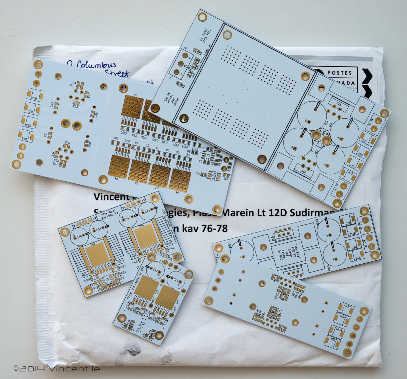

arrived
Beautiful boards, can't wait to populate and test it!
For those haven't ordered any board yet, do it quickly 🙂
