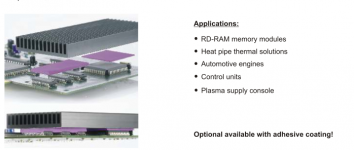

The question becomes: What thickness to make the pairs of aluminum bars?
opc posted:
...you could instead obtain the same result by adding two aluminum bars of the correct height to an existing thin based heatsink to obtain the same general shape and result.
My assumption about the machined heatsink offering was for the leg only to contact the board outside the devices / no direct contact with the devices. I see where my post has created the confusion.qusp posted:
Ed: sounds like i misunderstood your solution, so the 2 bars are on the outside contacting the PCB not the sink and the sink contacts the buffer bodies? the former of course seems perfectly fine, the latter i'm not so sure about
I think it is expecting too much for all things to come together in such a way that the tops of the devices and the bars are in the same plane; better to rely upon aluminum contact only... & Isolation would occur at board level, using the keratherm.bcg27 posted:
I interpreted it as the bars on the outside contacting the pcb. Then the sink goes on top and contacts both the bars and the buffers. Assuming things line up correctly.
Alternatively you could just drill clearance holes that screws from the heatsink would pass through. If you needed the bars to be isolated from the heatsink then some kind of shoulder washer could be used.
What I'm still struggling to find is a decent gap filling thermal pad that doesn't cost a fortune. I had two scrap pieces of 0.2" thick high compliance stuff from work and it's pretty much perfect as it forms around the buffers and makes good contact with the PCB which is where all the heat goes.
If anyone can find a thermal pad then please post a link up here!
Owen
opc mentioned the above quite early in the thread (12th/13th Jan). There is some discussion on it following the post quoted (see post 96 onwards)
Probably applies to your suggestion too but with alu bars you no longer need REALLY thick thermal pad, just a thick-ish one to sort out the installation/manufacturing tolerance of the buffers and then you should be able to bond to both the buffers and the pcb.
Bar thickness probably needs to be as close to the 0.18" height of the buffer as possible.

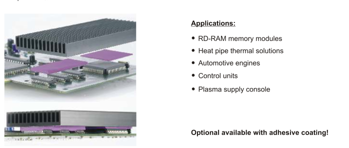

I remembered this post when i was talking with them last night and here it be, i've already asked for a quote on it along with the kerafoil. its called softtherm and can be up to 5mm thick, is pliable, but the ability to transfer heat is directly disproportionate to the pliability. Its available with adhesive backing available from 0.5-5mm attached is 3 datasheets ranging in thermal ability, probably somewhere in the middle would be best which means about the 86/320 or 86/450 with Rth of 0.5 and 0.3 K/W respectively and W/mK of 2.5 and 4.2. its available up to 7 W/mK but this is probably not only rather pricey, but not so pliable.What I'm still struggling to find is a decent gap filling thermal pad that doesn't cost a fortune. I had two scrap pieces of 0.2" thick high compliance stuff from work and it's pretty much perfect as it forms around the buffers and makes good contact with the PCB which is where all the heat goes.
not sure if the attachments worked as they are above the limit for size, but if not here is the keratherm datasheets page
and in order of thermal rating
softtherm 86/250 and 86/255
softtherm 86/300 and 86/320 and 86/450 (this is the most suitable range i think)
softtherm 86/500 and 86/525 and 86/600
also HYPERTUNE: how would the CNC go cutting out a stencil if i got the TIM films as a large sheet? or would i be best to just print out a stencil myself and cut with a sharp blade? there isnt that many of us, so wouldnt be too much work
