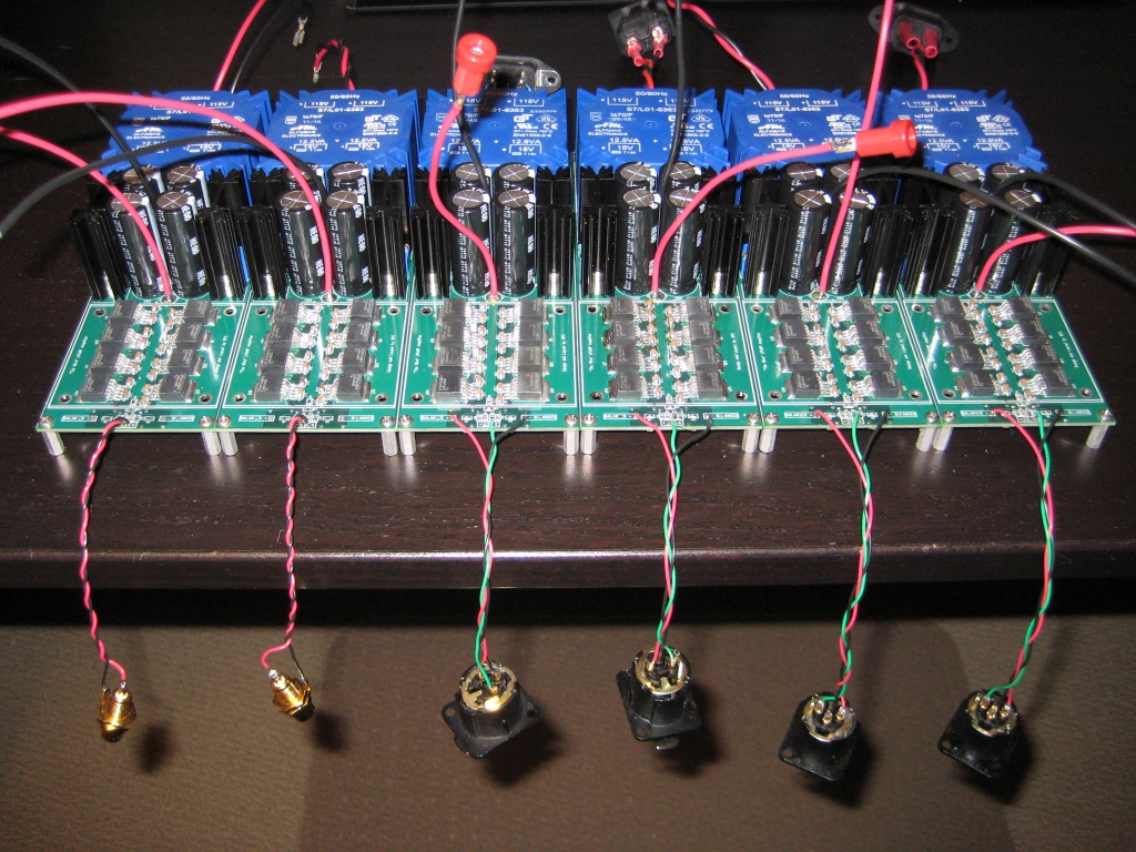

I built my remaining 4 amps over the weekend, and all 4 of them powered up and worked perfectly the first time. Two SE and two BAL inputs, both set for 15dB.
I've also tested the higher gain setting and it works perfectly as well.

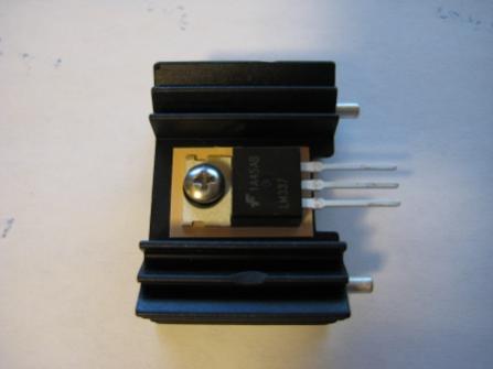

I see a few issues off-hand:
1. It doesn't look like the regs are mounted correctly to the heatsinks, and I don't see any type of isolation pads used. If that's the case, then the tab on the regs is being shorted to ground and one or both of the rails could be shorted after the regs.
2. Always build the PSU first, and adjust the pots all the way down (I can confirm that this is CCW on these boards). Bring the rails up to 18VDC by adjusting the pots CW and then power down, drain the caps and proceed with the rest of of the build.
Those are some handsome amplifiers you've got there Owen!
That photo makes my soldering hand itchy ...

That photo makes my soldering hand hurt! It took me 8 hours total to go from start to finish for the 4 units, and I think I worked it out to be 840 solder joints total.
Not bad for a complete pair of amps, but definitely a good amount of work!
I've attached a picture of how the regs need to be mounted to the heatsinks. you'll need a thermal pad and an islolating shoulder washer to prevent the screw from shorting the tab to the sink. the heatsinks are tied to PGND and if the tabs touch, you'll have a short directly to GND.
Owen
