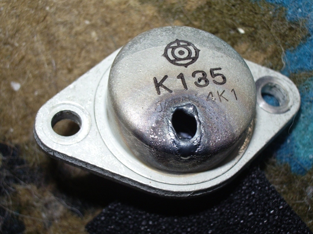

opc said:Red means that your output devices will melt if you run them under these conditions. The power envelope for a single pair of output devices really should be more like 350 watts, and I'll be updating the worksheet to fix a few small discrepancies around this.
did you melt some? lol
