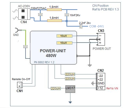

Just a consideration, in relation to the EMI filter. (heart connections)
DPS-400, using a filter that is unbalanced.(Eg. as CD Player) this does not require a link exhaustively to earth. but it is advisable to have the chassis ground. Also, to reduce RFI, the DPS-400 has a heat sink connected with a high voltage caps to heart.
DPS-600 uses a balanced filter, then requests a connection to the heart.

hmm AP2 i need some clarification here, can you show a schematic? i'm getting a bad feeling

no problem, so 'heart' as you describe it is what we call 'safety ground' or 'chassis ground' or 'earth' which makes sense; i just had to double check you werent meaning a center tap as described above
For dps-600, it is same dps-500 on pdf.
Pic , ref to dps-400 Emi filter.
