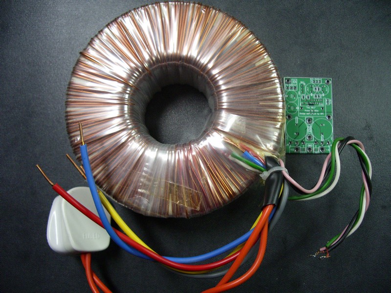

A better way, if you're buying a toroid and it's not potted, is to simply add some windings of your own.
Eg, if it's 2 turns per volt and you want ± 12V extra. Then do two windings of about 6 turns. You'll have to measure it.
That's how all of ours have been made. 0.56mm diameter enamelled copper wire was used.
I'd suggest to pay attention to amount of extra volts though to allow not just to clear the output stage and the regulators minimum overhead but also for the mains to swing, or if you one day might want to sell the amps to someone with a much higher or lower mains voltage than yours typically is.
On one Hafler DH200 I modified, I added an early stage, done with this method of a replacement toroid with extra windings joined to the main windings and to their own bridge and following main res caps then regs, the early stage earth was about +5V DC from the main earth star and centre tap. I ran a thin wire between the early stage regs earth and the main earth to equalise the voltage.

.......... if it's 2 turns per volt and you want ± 12V extra. Then do two windings of about 24 turns each. ............
🙂 Yes, I added at 2 volts per turn
I was distracted and only had time for a hew hours sleep last night
Thanks for the correction. I do now recall seeing what looked like about 20 to 30 turns on them. Of course it will vary with the size of the transformer.

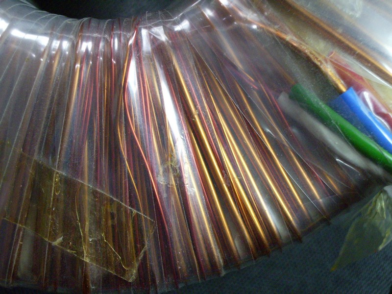

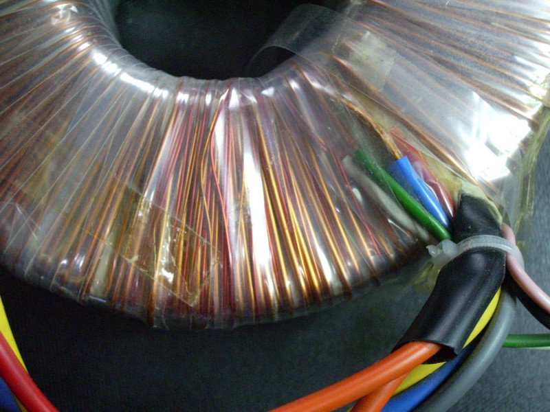

On this 1kVA transformer you can perhaps make out the extra windings all within a couple of inches.
They did them in two different enamel colours.

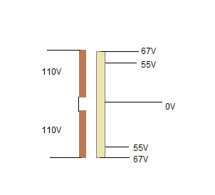

That is very ingenious. So you connect wires in series with the secondaries, give it a few turns and the original center tap is also the center tap for the new secondaries?
Yes. If connected this way, just like having taps for, eg, 92 - 80 - 0 - 80 - 92.
The 80's go to a big bridge, the 92's to a small one. Then the two earth's formed from the low and the high voltage capacitors are wired together.

yes, all used in a commercial low cost since long time.
problem is, that link keep full ripple from power link, (eg. your 80V), for this i advice use good regulator for 92V. but this need 10V higher than of voltage you need.
