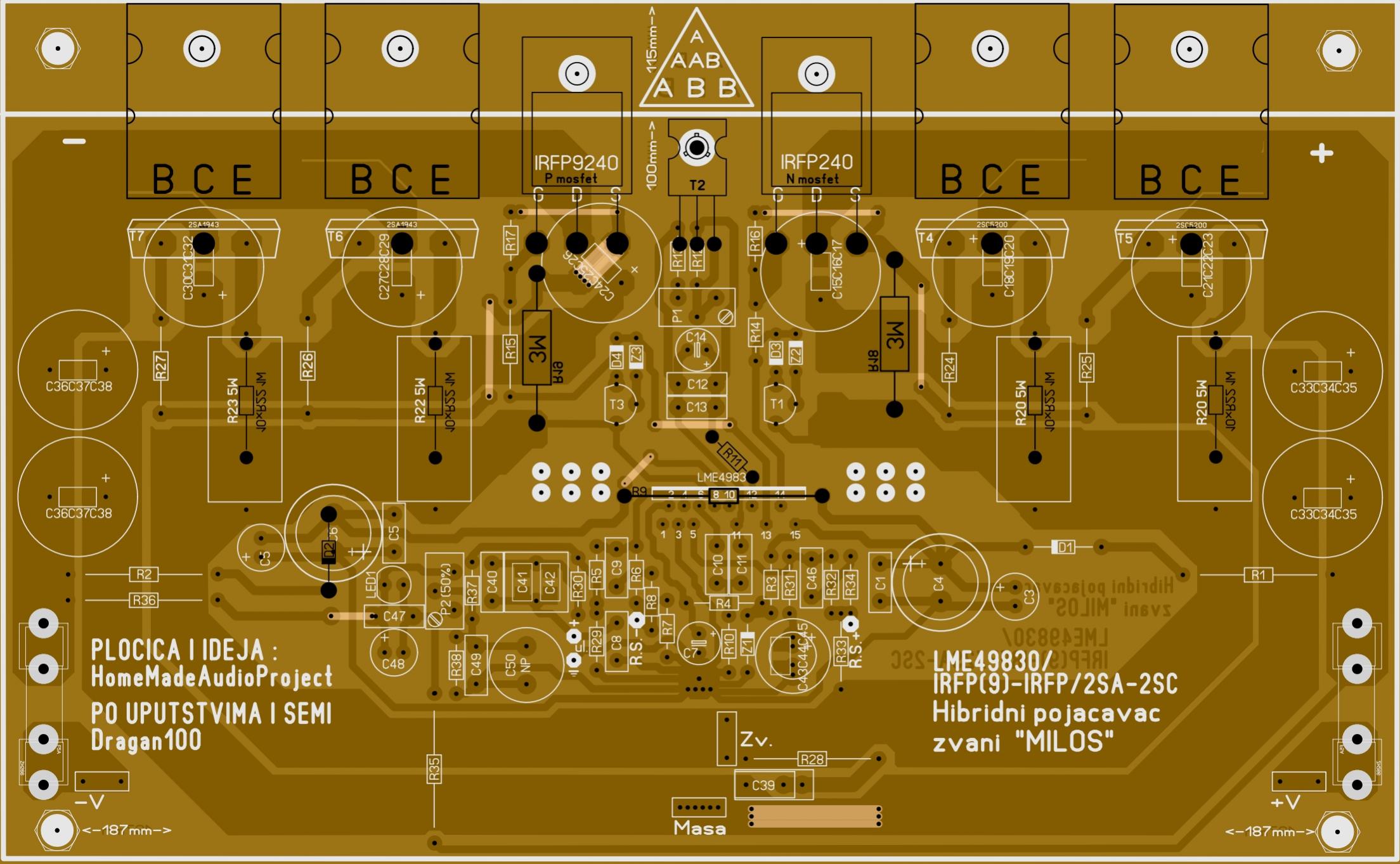

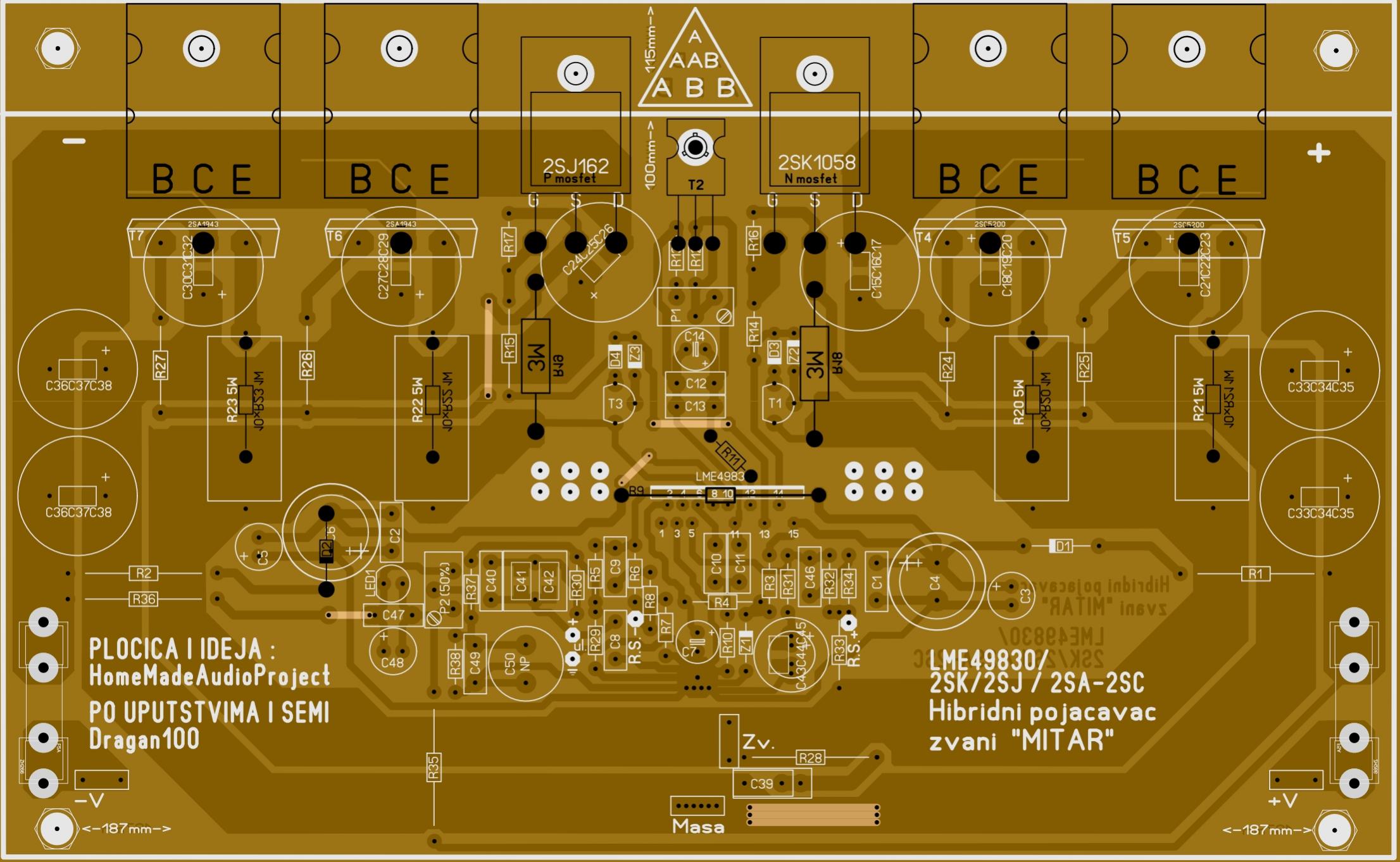

a man named Dragan100 in our Serbian forum has developed a schematics for this IC and my idea was driving mosfet hybrid BJT output stage.
i have drawn two pcb by his instructions,one for IRFP240/9240 and second for 2SJ162/2SK1058 and and they both work well,sound well and they both were connected to 8r60uH470nF load and proven them selves to be stabile amplifiers.
the thing is that i have tested them at 15kHz sinus wave and cliping for 2sk/2sj looks just like on pictures from posts you linked,but for IRFP240/9240 it has some sinusoidal form at the same place that lateral vesion has that almost vertical fall.
i have seen a schematics at about 30 pages earlier,i believe that it is being used in this thread and as i could see you used 220-330Ohm gate-resistors with lateral mosfets,and there is no resistor between gate and source. we used it in both versions,but the result is not equal and now i am looking for experinences from other people before i go and try to do same changes.
Dragan100 and i did it like this-

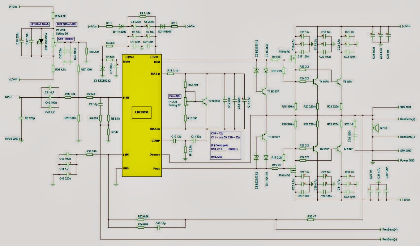

Are the compensation values good enough? I see its being reversed as instead you probably need to swap it? like C10 being 33pf and C11 being 12pf respectively?
According to the Wireamp worksheet in the first posts of the thread..
http://www.diyaudio.com/forums/atta...e49830-lateral-mosfets-wire-amp-schematic.pdf
the smaller value comes first like 12pf and then 20pf?
which one is right here?

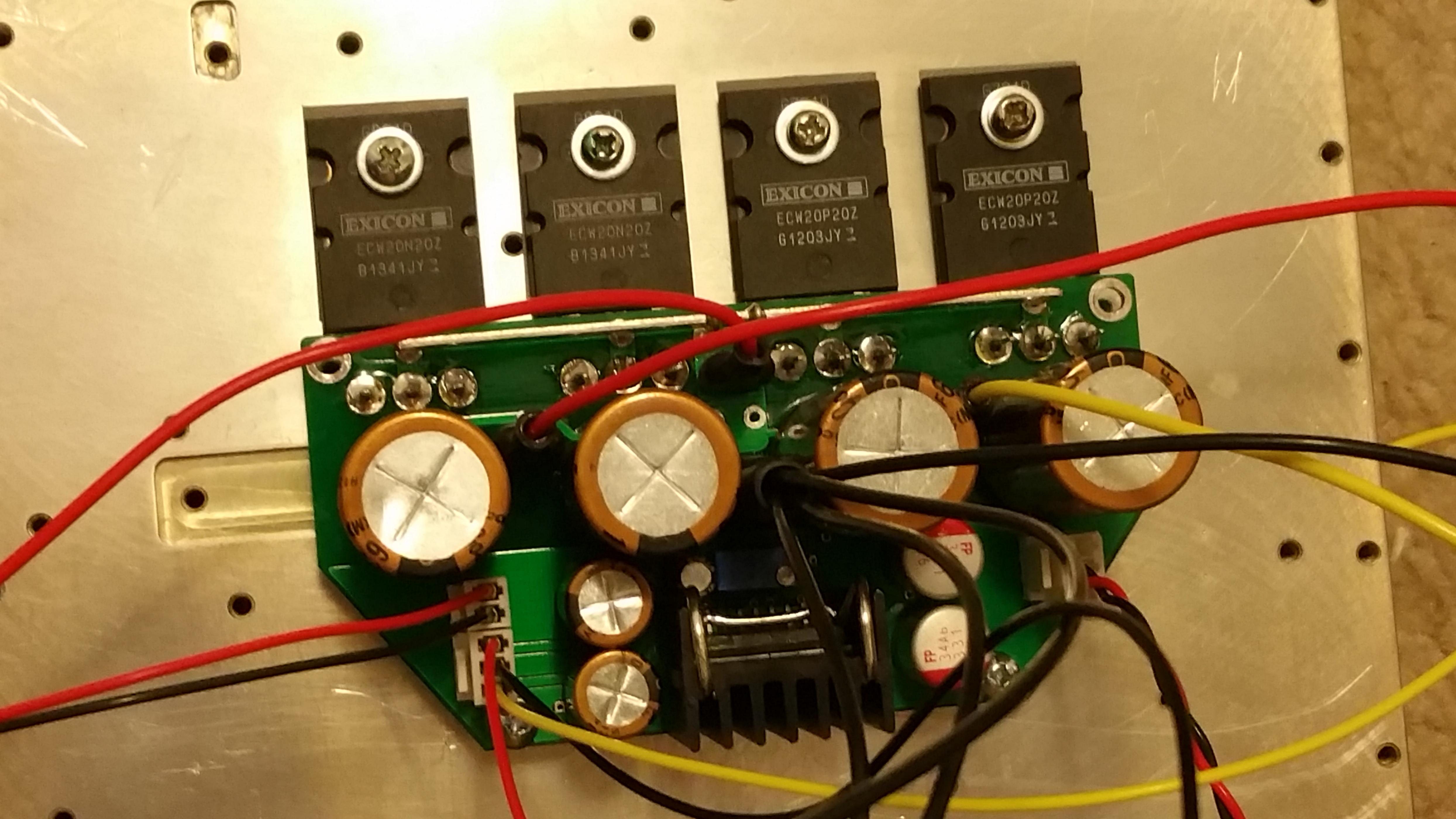

I = 350 mA, 55,5 V on mosfets and 64 V on frontstage. Dead silent without input connection but a very low hum (ear in speaker) when connected to a source or shorting the inputs. Cannot find it yet. Oscilloscope doesn't show oscillations. Zobel underneath the pcb and a coil and resistor at the outputs. I made the heatsinks for the lme a little bigger. The sound is id very good.
Some pictures:
