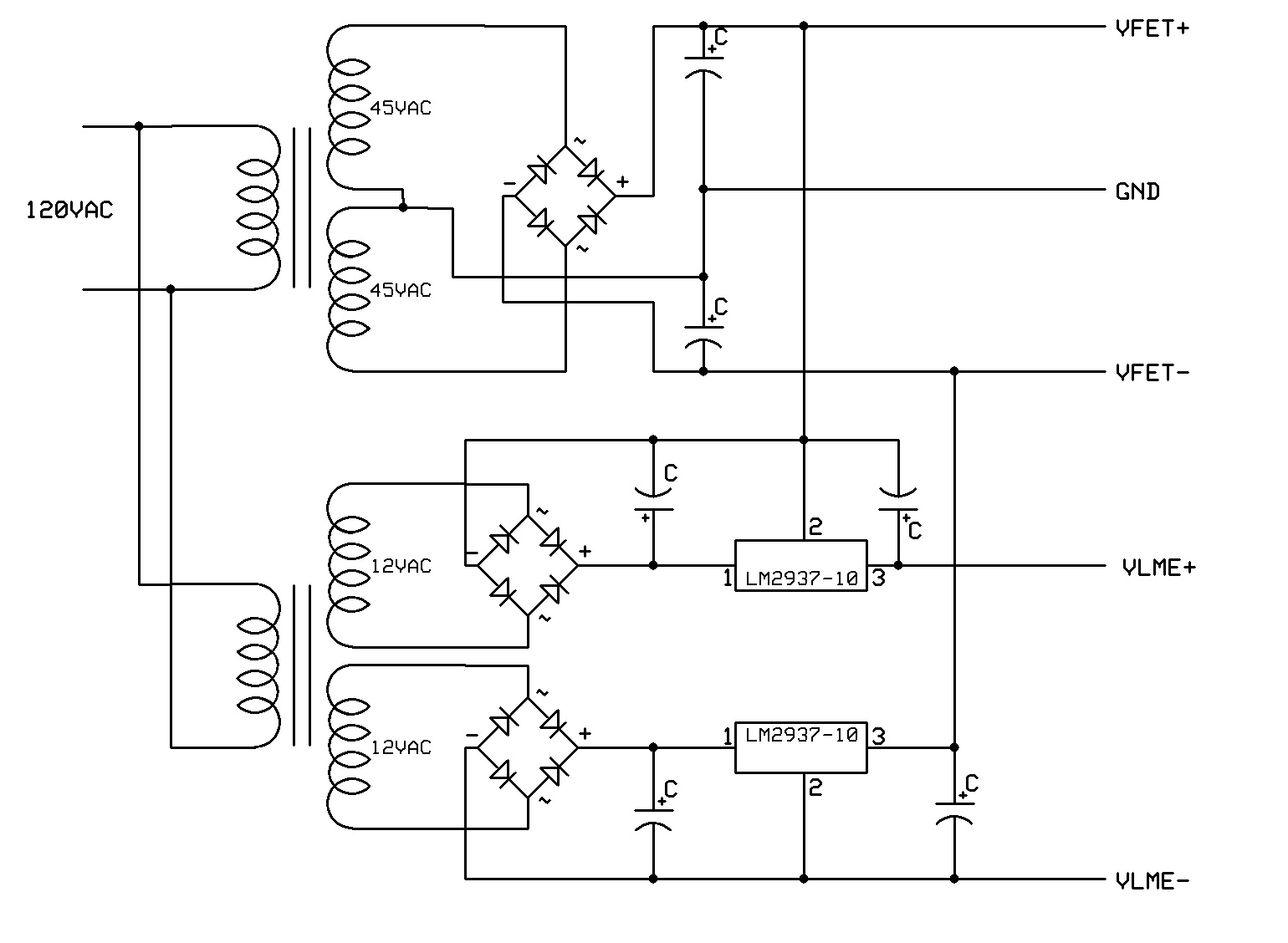

Working on a ps for this amp. Would it be acceptable to regulate the lme supplies to the fet rails or should they be regulated in reference to gnd? Attached is my sample sch that regulates 10v to the Fet rails.

If your regs can handle the additional voltage, it would be best to regulate to GND to avoid adding the unregulated supply's noise to the LME rails.
Consider just putting the additional 12V windings in series with the 45V windings and rectify / regulate from there.
As for the gate protection zeners, they are easy to add across the fet legs if you feel the need to add them. It really depends on how you plan to use the amp, but it doesn't hurt to have them there.

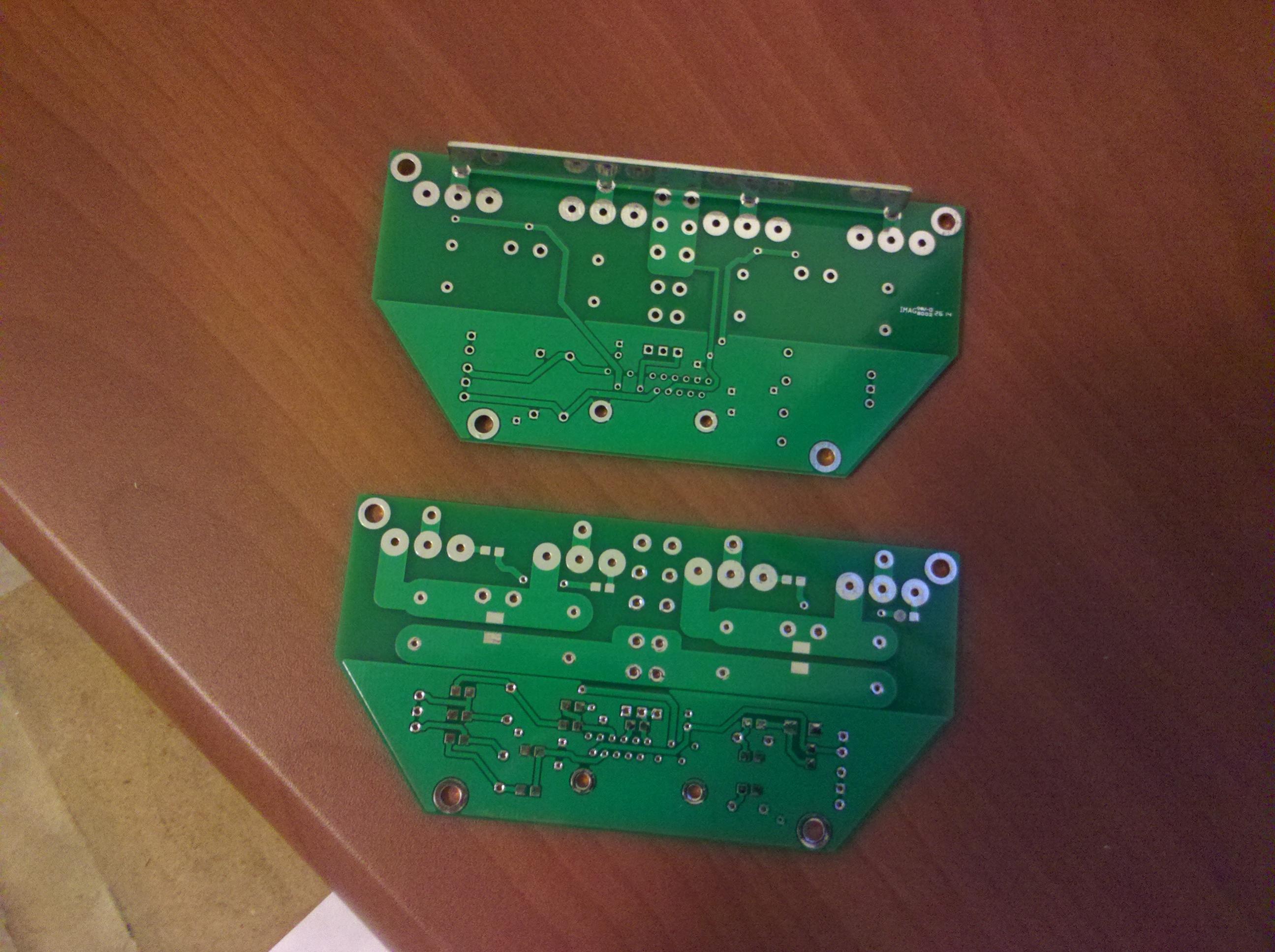

My boards came in. Same circuit (minus the DNPs) with option for a 2nd pair.

I like how the mute circuitry is taken to the chips power side. I actually like that very much!
The chips GND pin (nr 3) is the return for the mute pin (nr 2). If I see correctly, that is now taken to the opposite direction? I would like these two tracks to closely follow each other. But that is hardly any problem on your PCB if the mute input is kept clean from injecting interference to the board (ground plane)...
Supply bypass caps could be a bit closer to the chips power pins. You use Fischers SK145 as heatsink? There is room "inside" the heatsink for the negative rail cap.
You use also SMD on the board. These supply caps could be MLCCs. With SMD you can get ridiculously close to the chips power pins.
...Just a couple of ideas if you plan to make a v.2 of your board some day...
Anyways, excellent work! Congratulations! You could sell some of those on the sites Swap meet forum...
Will be waiting for your test results and most important of all; how does it sound!!!

Thank you. This is the first board I've done so I could use all the advice for the next version. There are a few vias connecting the gnd planes around lme pin2. The heatsink is here....
