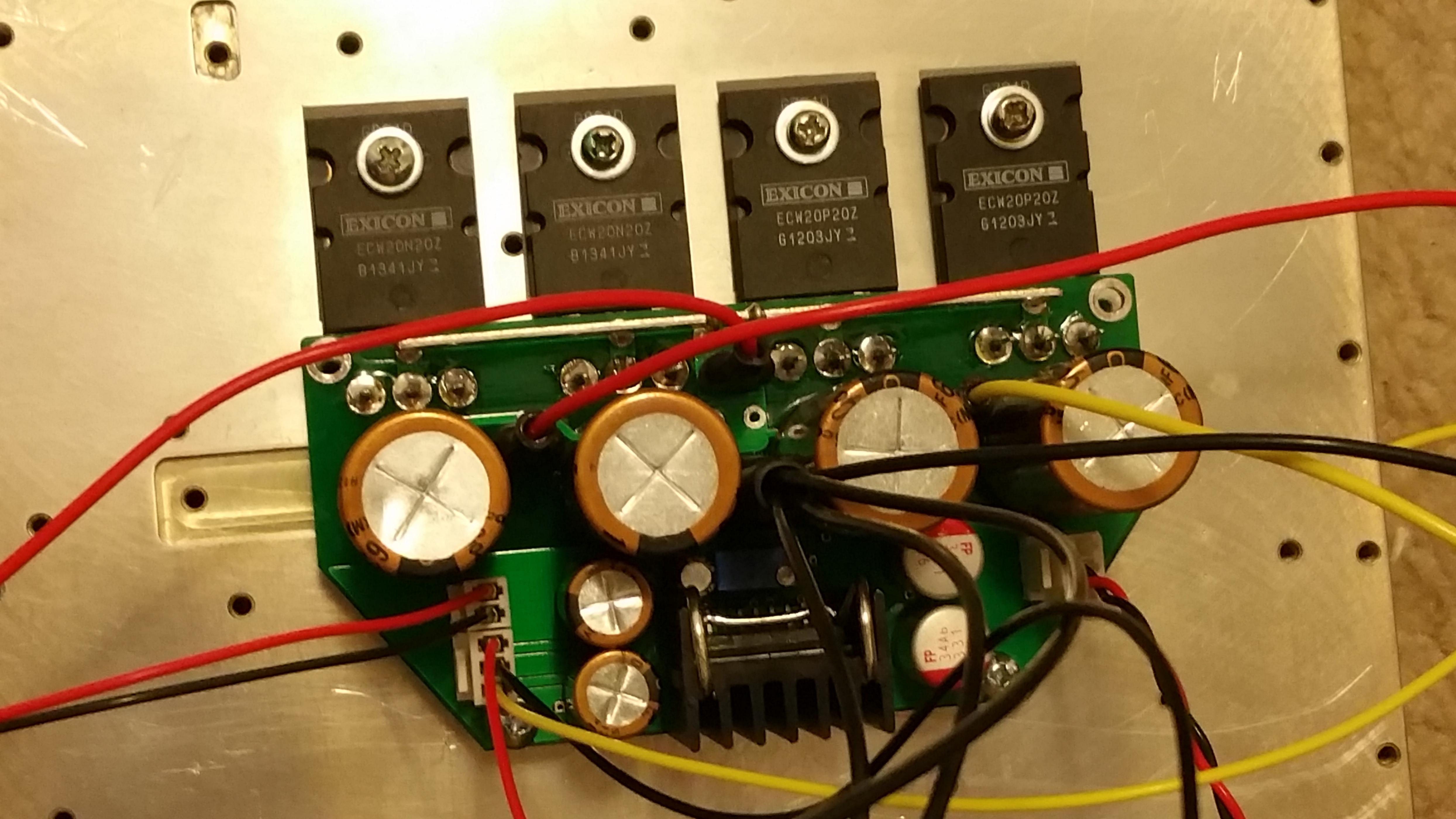

Where do I get a board like that one?
My lme rocking now. vfet+-45v vlme +-55v biased at 275 mA and holds steady. Sounds great!
Funny that you used the same HS a OPC did 🙂

OPC chose a good heat sink for the device.🙂 There is a worksheet on the first page of the thread showing 1 pair is good for 400WRMS, or at least that's how I read it. Now I'm no expert but that seems like it's pushing it for 1 pair. I just wanted a little wiggle room. Has anybody tested a single pair up to 400WRMS? I just ordered a 1.5kva transformer that will give me +/-62vdc for the fets. Should get me close to 400WRMS into 4.
BTW I'm in Ontario, California😎
My apologies. After reading OPC's assembly guide I see he put the upper limit at 300WRMS. I placed an order for 2 of his boards. Can't wait to try them out.🙂
I built a pair and used +/-75Vdc for the LME and +/- 65VDC for the outputs about 170 watts at 8ohms and just under 300 for 4 ohms

That sounds good. I'm shooting for 400 into 4 with 2 pair.
using the guide, 2pair of 250W devices gives a maximum power output of 250W
Asking for 400W moves you into the territory of not hot heatsinks and not severe reactance speaker. You as Designer and as User have to ensure both conditions can be met at all times. Otherwise you risk damage.
Define 'not hot' heatsinks?
Heatsink Ts = 50°C is not hot.
70°C is hot.
90°C is too hot. For a 150°C device. A 200°C device could and should survive running quite a bit hotter.
Then add on the deltaT between different locations on the heatsink.
Then add on the deltaT from Tc to Ts.
Then add on the deltaT from Tj to Tc.
Then add on tolerances.
Tc=90°C gives a power de-rating factor of 0.48
Tc=100°C, DF=0.4
Tc=110°C, DF=0.32
Each increment of 10Cdegrees for Tc massively reduces the remaining power available to take the stresses of the audio signal.
