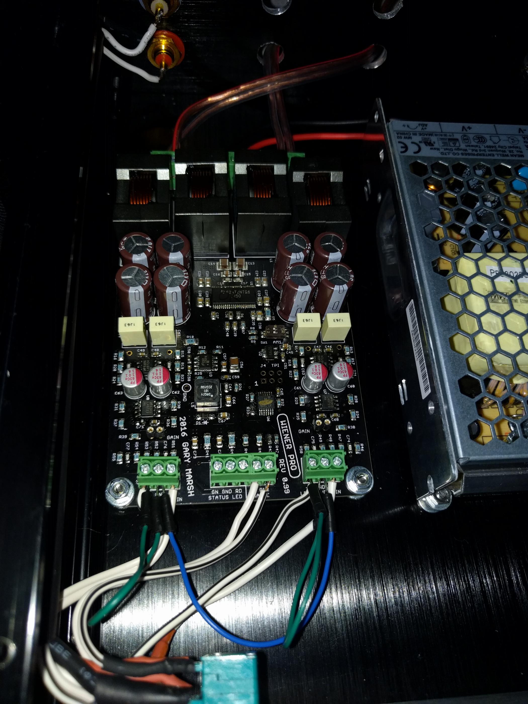

Is your audio source connected to the +/- inputs, or + and ground?
Make sure you do the former. If source and amp aren't grounded together by other means (AC power ground, etc) connect - and ground inputs together at the amp.
Found this helpful when wiring up my Pro. Had me scratch my head for a while.
Pro all wired up and sounds delicious!
I am getting a tiny tiny hiss at idle due to my input source (Chromecast audio) which disappears if I unplugged it from the RCA plugs. Is there any way I can adjust the idle threshold to eliminate my idle hiss?
Oops! Input negatives and grounds all connected and the tiny idle hiss is all gone.
