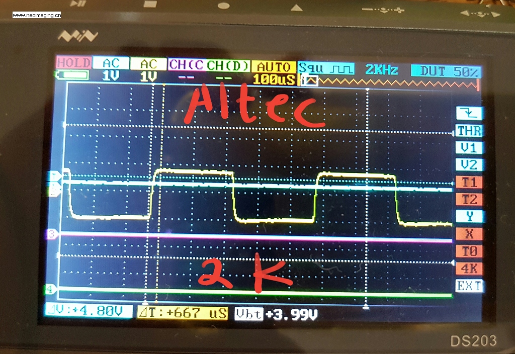

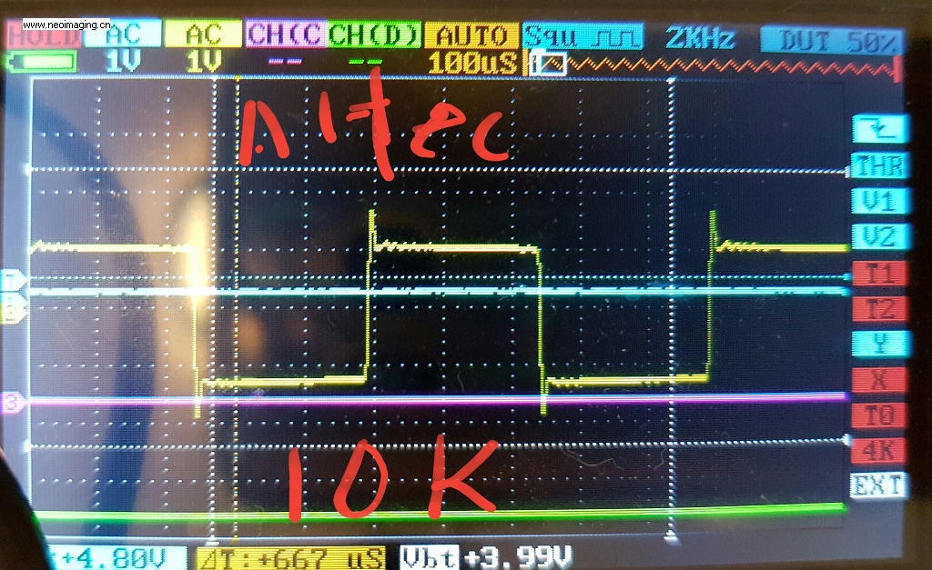

Thanks for sharing that. I am not sure of your methodology for measuring ringing with respect to impedance matching. I can definitely tell you that if there is ringing with the Altec/Peerless 15335A transformers, I do not hear it. My ARC LS7 line stage has a rated output impedance of 200 ohms and the Weiner's input impedance is in the neighborhood of 30kohms. This should be fine for using the input transformers without the RC damping network. There could be situations like what you've measured on your scope, and perhaps the damping network is required. For now, I will continue to enjoy the Weiner PBTL as I have it set-up.
I tried a simple 10k resistor load and there is a lot less ringing for the Altec, but I can still see a large spike with very minor ripple after. For 2k load, however, everything looks nice. But unfortunately, the Wiener load is a bit higher than 10k

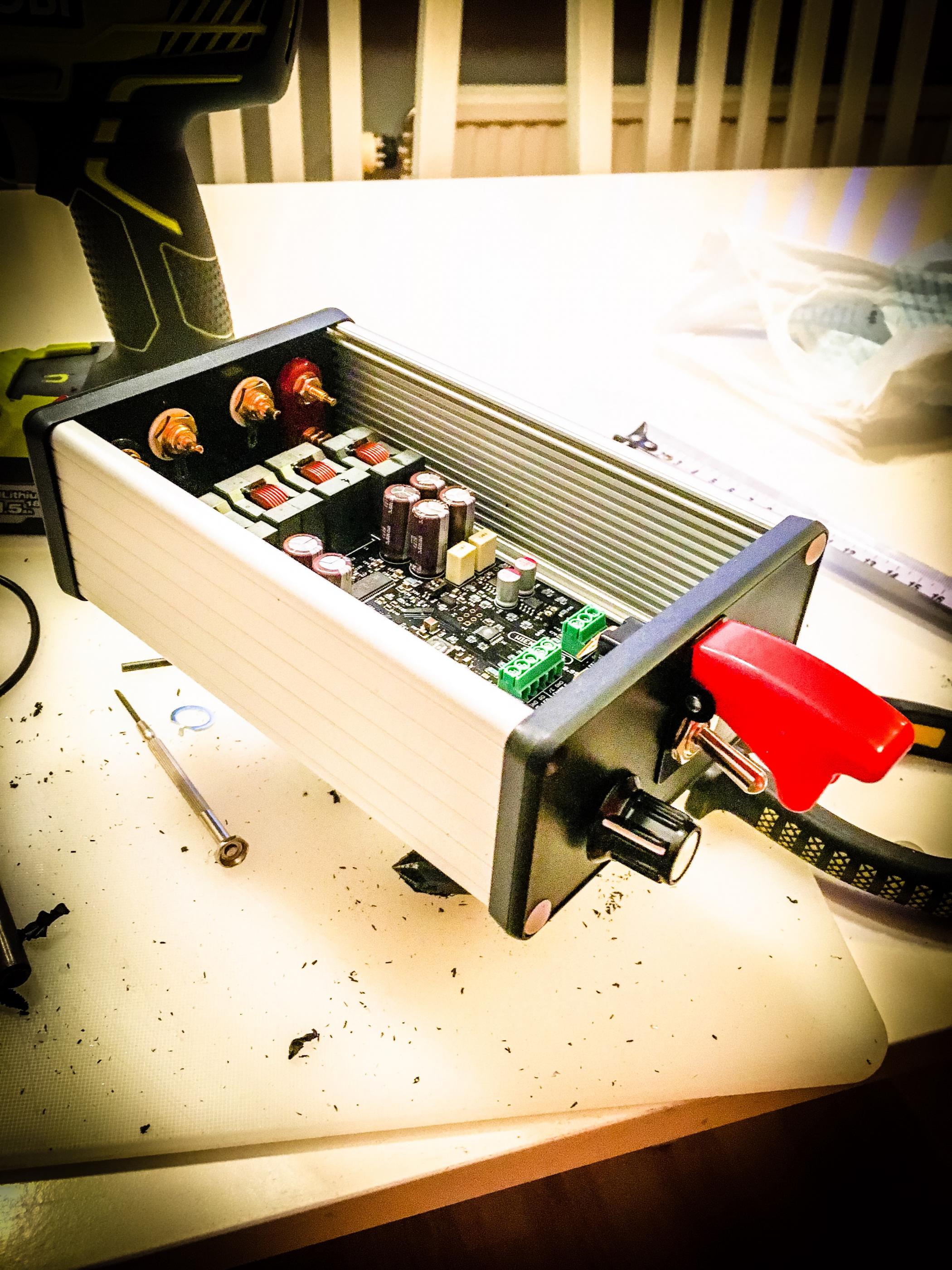

Thanks for the advice and well guessed. Thought the minus on source in was reserved for balanced inputs...and that a simple RCA connection as mine used ground.
Never mind the gain resistors. Found a nice shop in London for electronic stuff last week on a vacation trip, so the knob to the left will act as a 4-step gain selector using matched metal film resistors.
So..just a new soldering iron and a volume control away from completing the project.
