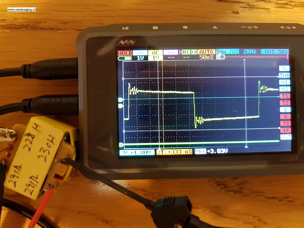

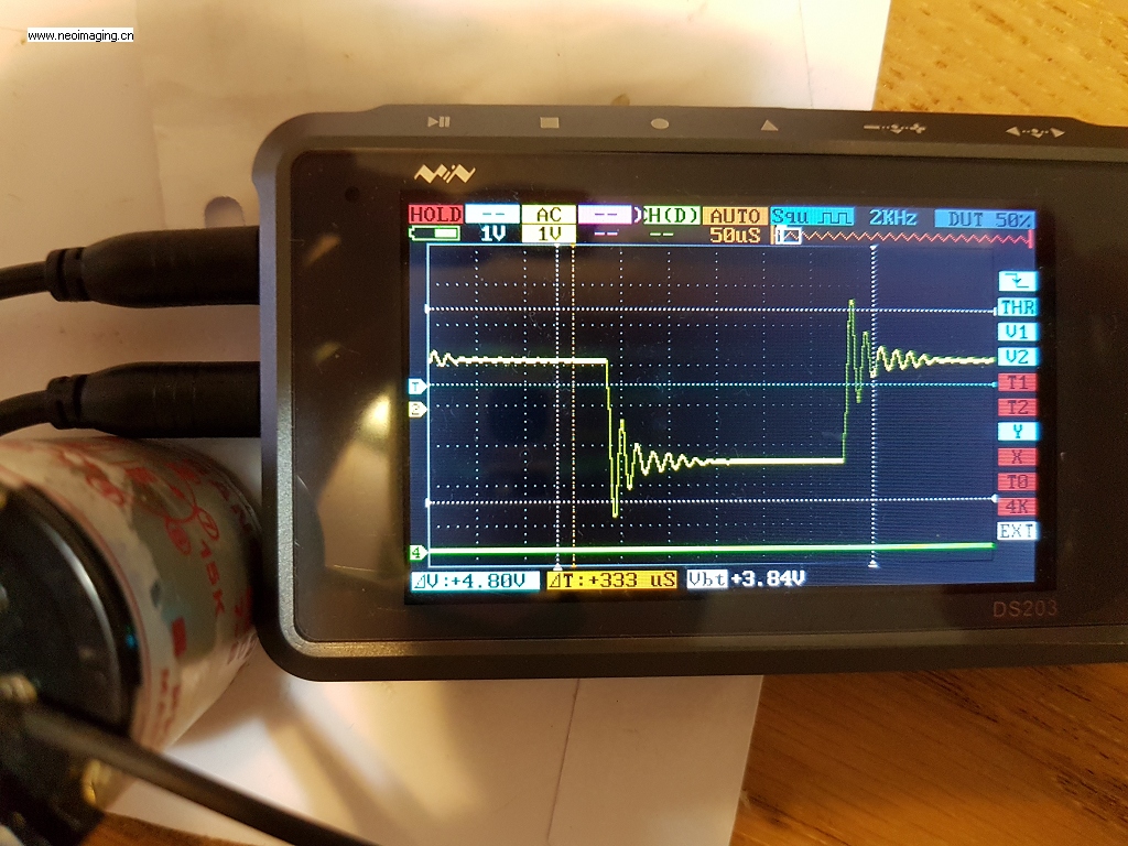

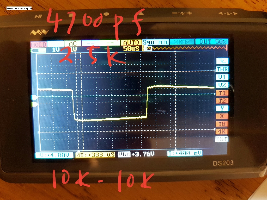

I did a quick test on the Altec and it rings pretty badly. I upload the image with a 2k square wave. The cheapo Chinese 10k:10K actually looks quite a bit better even without the snubber, the last image is the Chinese 10K with snubber 4700pf and 2.5k resistor which pretty much removes all the ringing produce a fairly good square wave.
No time yet to try out the snubber value for the Altec since it will take a while (I only know of trial and error with various value)

Hi ChuckT,
Thanks for sharing that. I am not sure of your methodology for measuring ringing with respect to impedance matching. I can definitely tell you that if there is ringing with the Altec/Peerless 15335A transformers, I do not hear it. My ARC LS7 line stage has a rated output impedance of 200 ohms and the Weiner's input impedance is in the neighborhood of 30kohms. This should be fine for using the input transformers without the RC damping network. There could be situations like what you've measured on your scope, and perhaps the damping network is required. For now, I will continue to enjoy the Weiner PBTL as I have it set-up.

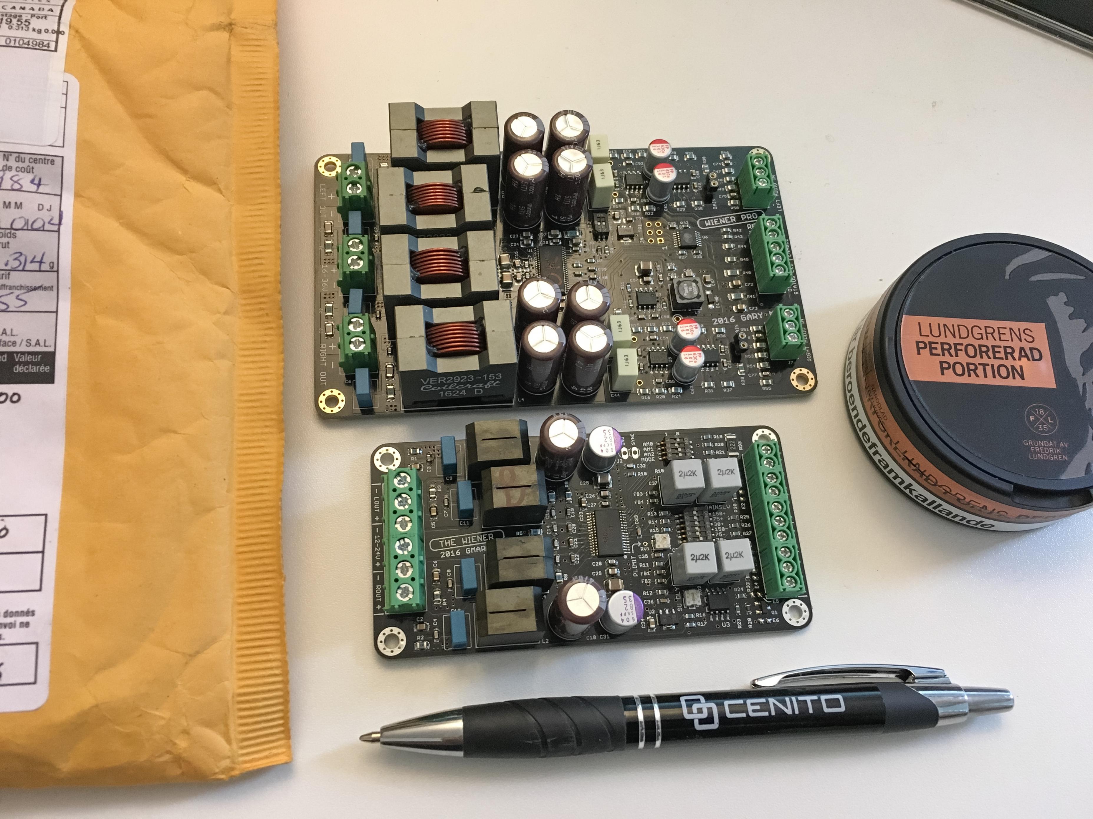

tigerfoo, shochu: your amps are built, almost ready to pack. Ran out of lockwashers for the mounting kits, will pick some up tomorrow and finish those.
wushuliu: your PBTL4's are built, I did them fully assembled for testing purposes, gotta haul the input caps etc back off then they'll be ready to mail.
Then onto ChuckT's massive order 🙂 Some amps are built for this, gotta bang out a bunch more.
