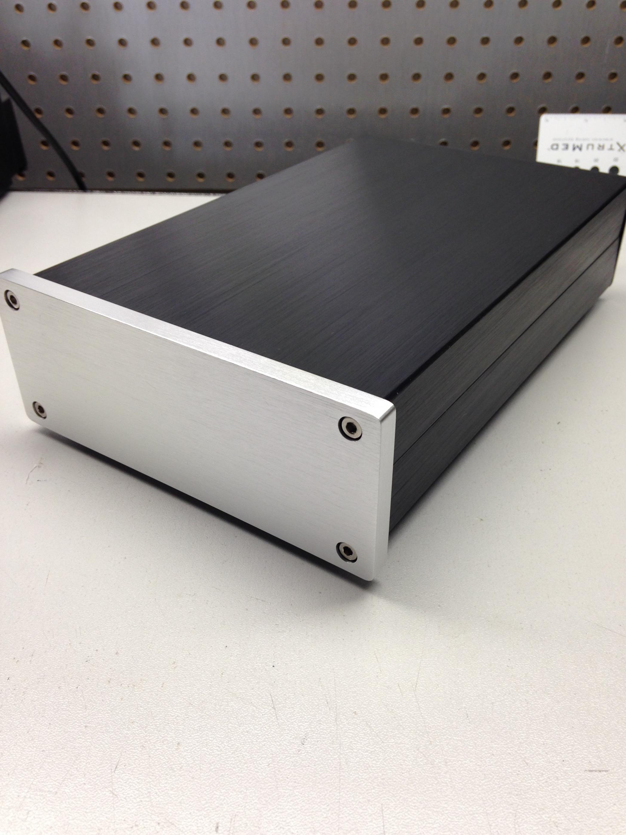

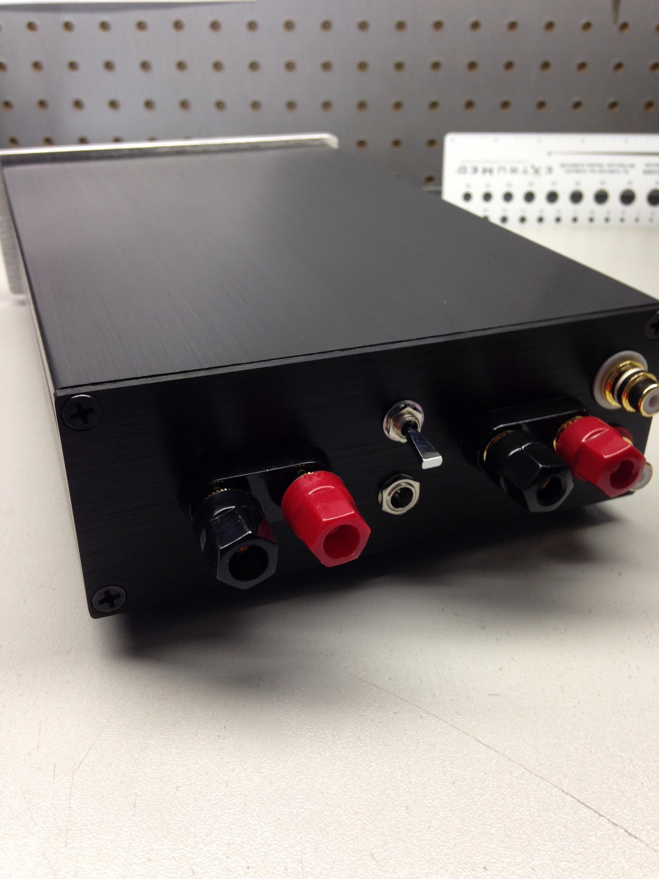

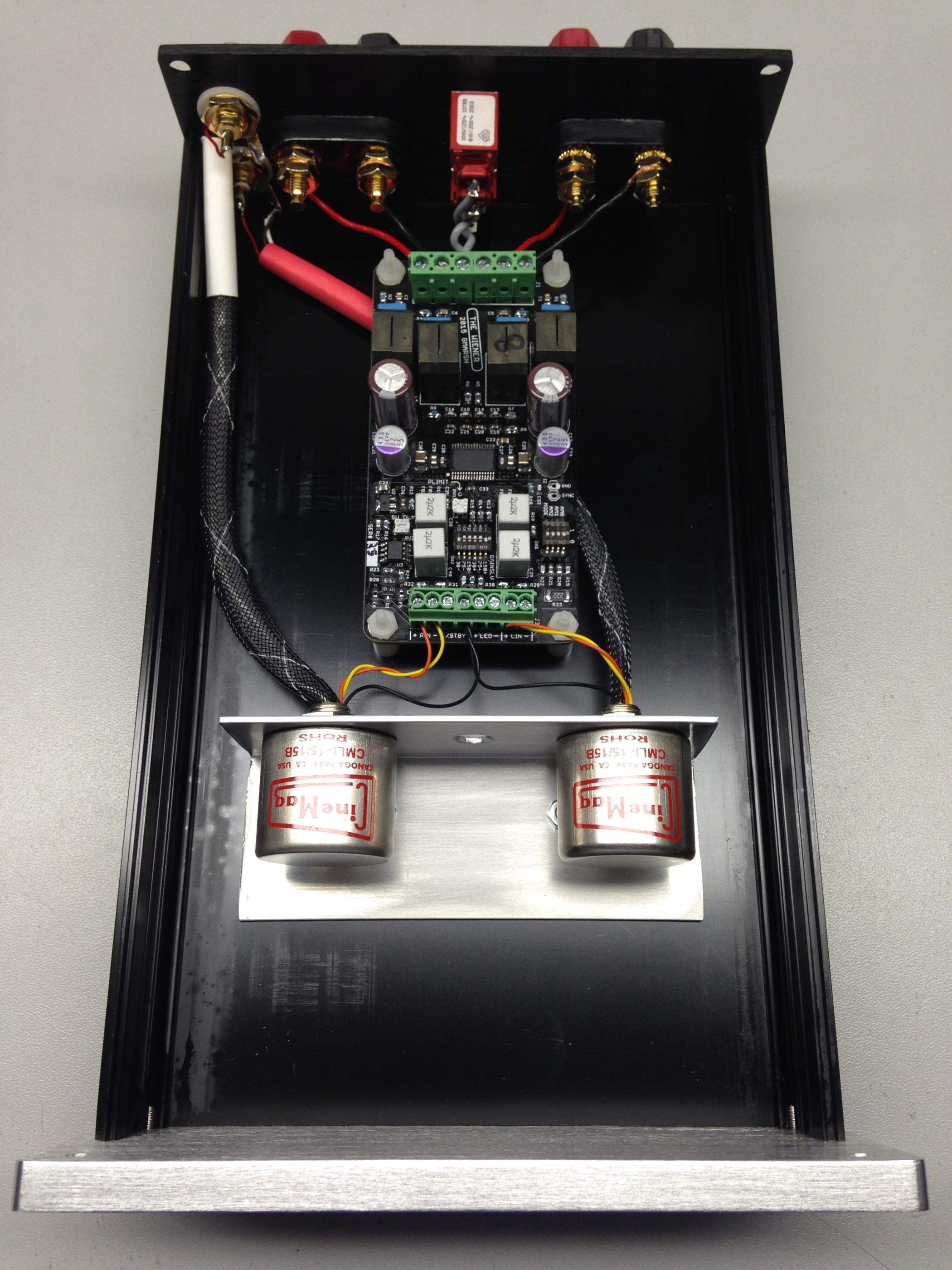

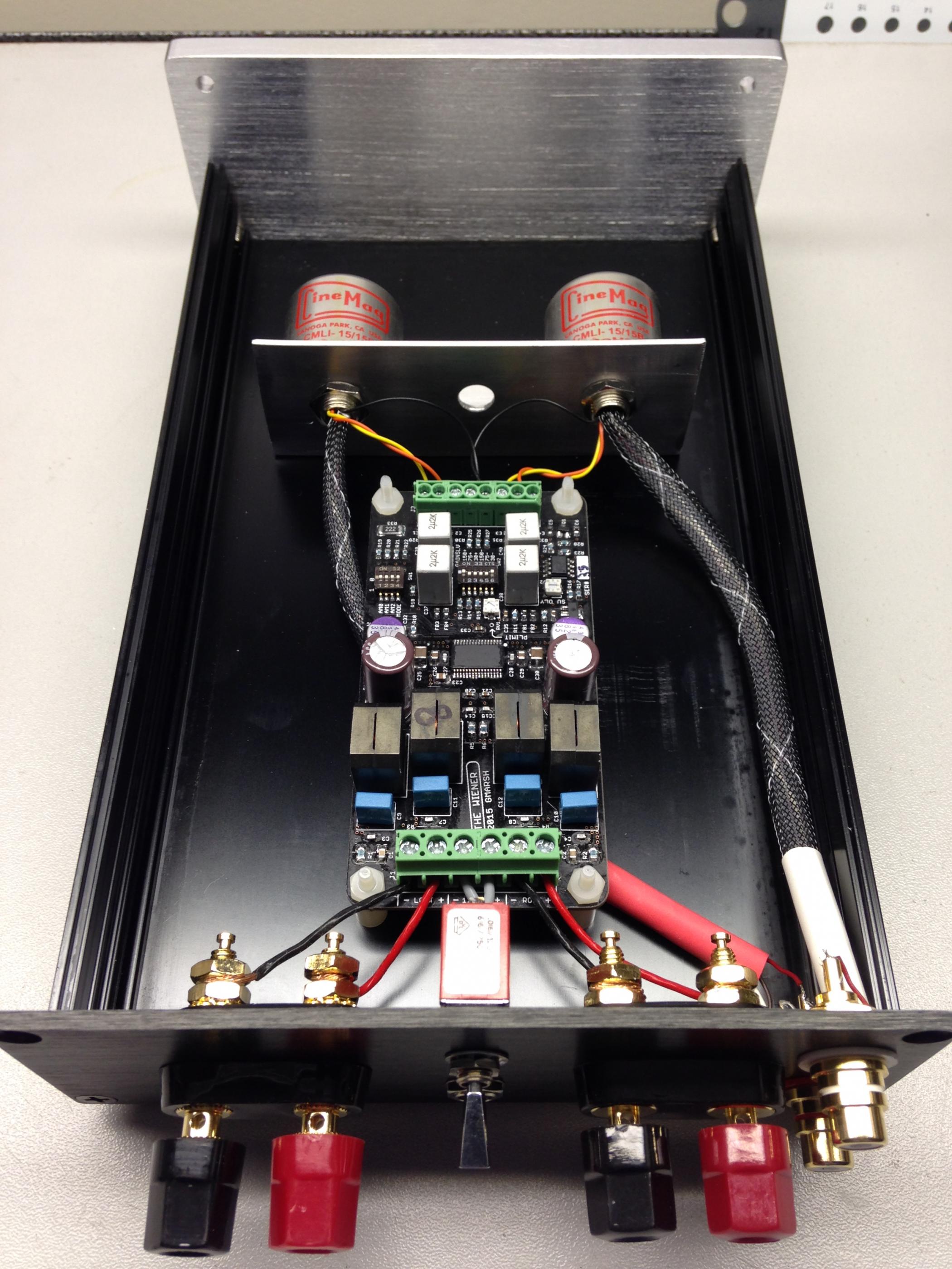

I finally installed The Wiener amp in a "1506" Aluminum enclosure I purchased from eBay. This is a really nice enclosure and the assembly was straight forward. I mounted the CineMag CMLI-15/15B input transformers on an angle bracket fastened to the bottom half of the split chassis and shortened the wires from the transformers to the amp.
I am going to mount a small green LED on the faceplate after I have it anodized to match my Audio Research line stage and phono stage preamps.
Rhing,
Impressive work. neat and tidy .
This must be the best sounding TPA amp of yours.
regards
kp93300
regards
kp93300
