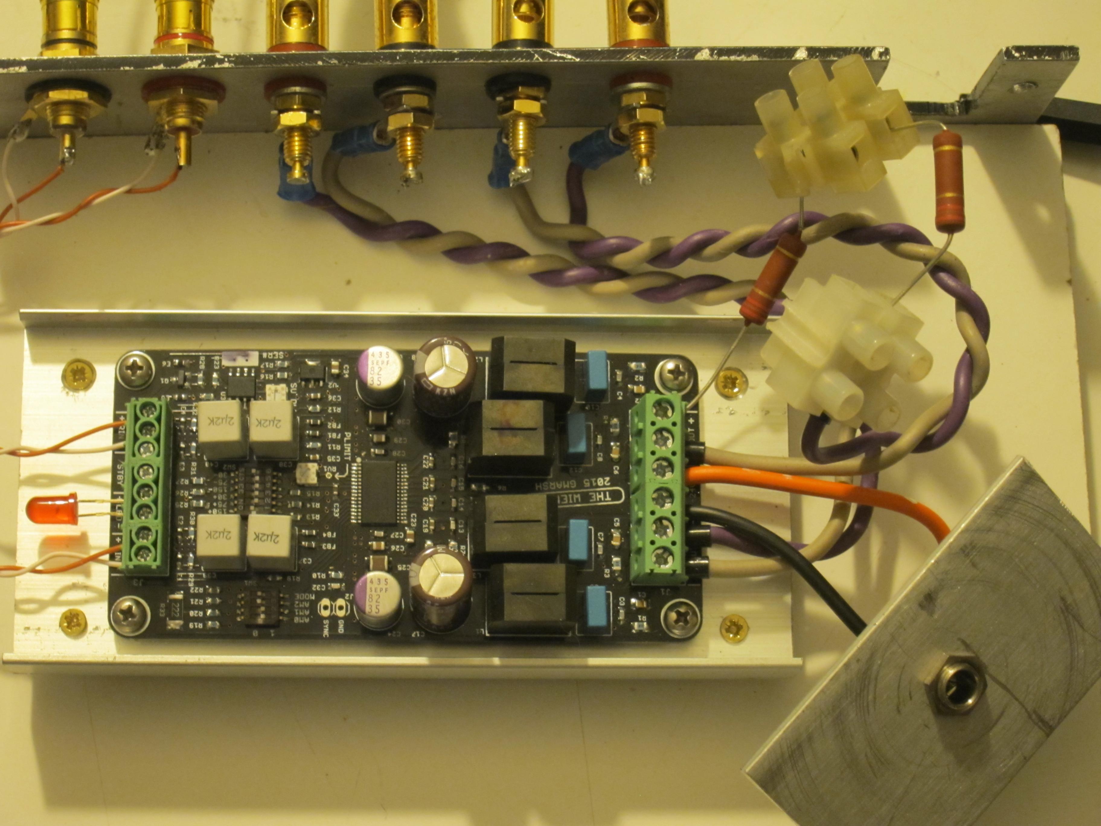

This is what I've at the moment.
Tomorrow I can try a serie resistor.
Thanks for you help.
Guglielmo
Capacitive load could have peak in treble, but I find very low volume music strange, it could be impedance below 1khz is very high, but FirstWatt is little amp too, so I wonder about something else too:
A bridged amp can't have speaker negative to gnd. Is speaker negative separate from gnd on speaker pcb ?
Got my suspicions that the panels basically look like a great big capacitor, and the Wiener for whatever reason isn't stable into the load. Try adding a small value resistor (2-4 ohms) in series with the outputs and see what happens.Hello,

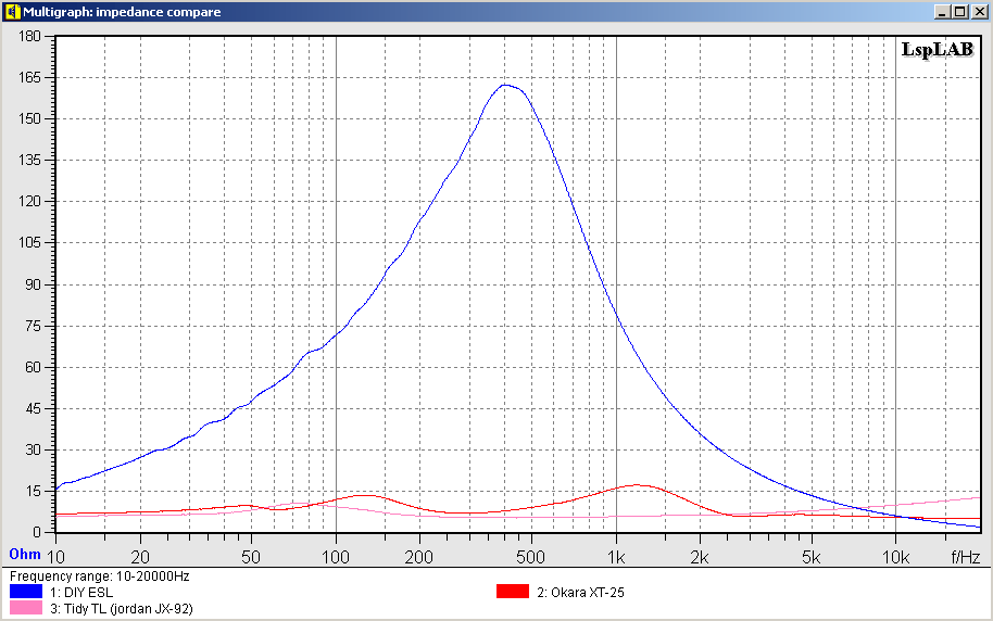

Found a diy esl impedance plot, could be informative, the series resistor(s) would raise entire curve

Hello,
I tryed with the resistors (2,2 and 4,4 ohm) but no difference,
but there is something strange:
-No inputs connected and electrostatic or dinamic speakers connected, non noise on out;
-Inputs connected and dinamic speaker, no noise out and music
-Inputs connected and electrostatic speakers connected, noise on out;
-Inputs connected and electrostatic and dinamic speakers connected (One for channel), noise on out on both;
-Inputs connected only on the channel of the dinamic speaker and electrostatic and dinamic speakers connected (One for channel), no noise on out on both;
-Inputs connected only on the channel of the electrostatic speaker and electrostatic and dinamic speakers connected (One for channel), noise on out on both;
I hope this help.
Ciao
Guglielmo

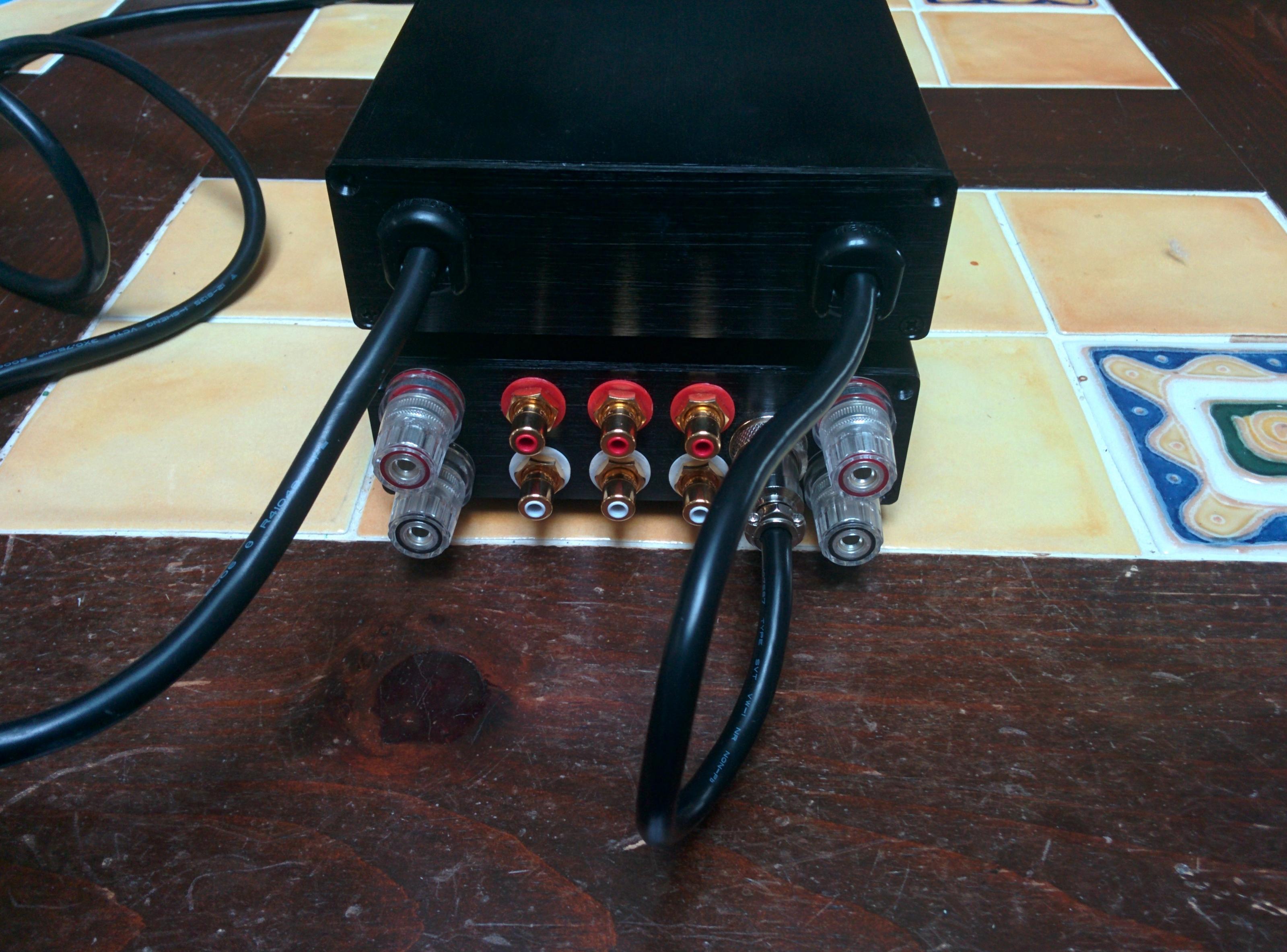

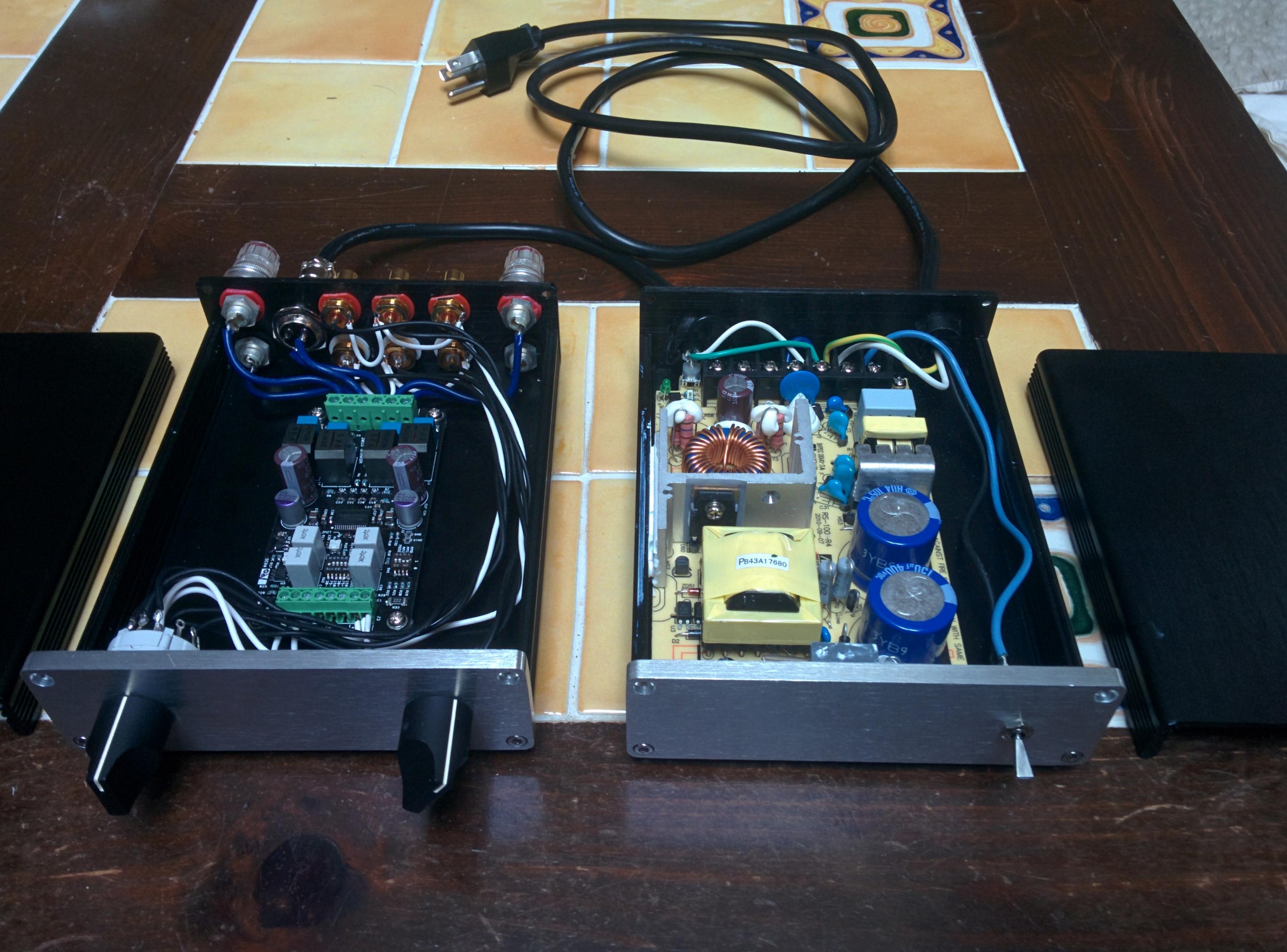

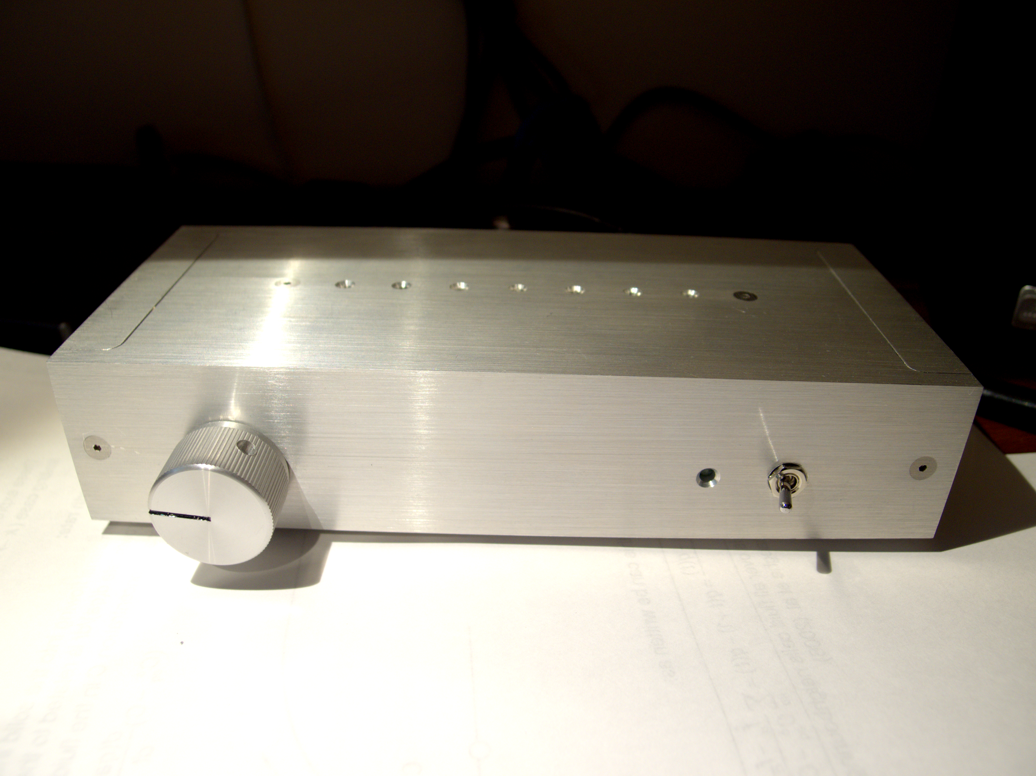

First wiener amplifier up and running.
Well, the first one is done. The box is custom made by Art Taylor, originally for the Charlize T-amp module. I gutted the Charlize out and put the Wiener to it.
yep it's here. but...
it makes some rhythmic pops (more like finger snaps) on turn on, without signal.
and, when I turn off the source CD player, there's a hum which isn't present if the CD player is on.
I've got two power bricks for use as PS. the Lenovo (three prong) makes worse noise than the generic two prong brick. Both have the rhythmic clicks but the generic PS makes music. BTW, either of the two power bricks are alright with my other TPA3116amps.
I'd rather not try it again until I hear from you.

Could be.
The negative inputs on the Wiener card are floating, on most other cards they're connected to the board ground - I did it this way as it allows the card to be fed from a differential source. Unfortunately the differential inputs on the TPA can't handle any significant common mode signal, eg. a big difference in power supply ground between the source and the amp. If you plug the amp in using a 2 pin power adapter, the amp/source won't be grounded together and problems can arise.
If your source is single ended, connect the input RCA grounds to the board ground (the power negative ground, or the four mounting holes in the corners).
If you're using a differential source (say XLR's) connect cable shield and XLR pin 1 to chassis ground as well as board ground, and the differential pair to the differential inputs.

!!hooray!!
Thanks, that did it. YaY!!!!
Now to connect to better speakers.
