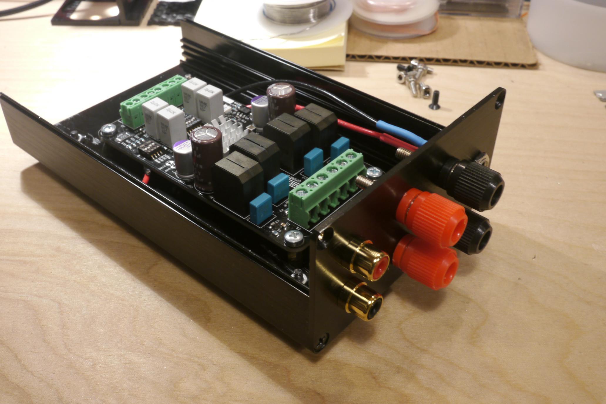

That's an awesome looking build, I really like that case and the price is right. Thanks for pointing it out.Here's some "amp porn" for those of you who are into it. I finished this up last weekend, haven't had a lot of time to do any detailed listening yet, but initial impressions are extremely good. I guess I do need to jumper one of the - inputs to ground, as I have some hum coming through. Interesting thing with the hum: I'm using a stepped attenuator for volume control. The hum is barely present with the pot at max resistance (50k), gets louder with increasing volume (i.e. decreasing resistance), then totally goes away when the pot is completely open. Initially I didn't notice the hum (see earlier post) because I didn't have the pot wired in, and was using my DAC for volume control.
Anyway, a rundown of the build details for anyone who's interested:
- PSU: Connex SMPS300RS, customized to 20V output
- Pot: Ebay "DACT Type 21 Stepped Attenuator Potentiometer 50K" from seller lasercollection (current link). Learned about this from the "lunch money amp" thread.
- Chassis: Ebay "1306A full Aluminum Enclosure case/Power amplifier box/DIY chassis -sn" from seller sep_store (current link). Came with all holes (except for the LED) pre-drilled, which was nice. Though the speaker binding post holes were a wacky size, either too big or too small. I had to grind on them a bit with my deburring tool.
- Shielded wire for inputs, I bought that years ago from "John's Wire Shop" on ebay.
- Rest of the hook-up wire, RCAs, binding posts, and on/off switch came from Apex Jr.
- LED and it's current limiting resistor, PCB standoffs, and thermal pad all came from Digi-Key.
Note my lovely glob of hot-melt glue on the attenuator. In my infinite wisdom, I neglected to consider how the pot is mated to the chassis when I soldered up the wires. So the wiring protrudes from the front of the pot, making it not sit nice and flush with the chassis. I had also applied a big blob of hot melt glue to the wiring before I realized this. So I spent time building up a "frame" with more hot melt to make the volume pot mate evenly to the chassis. It's ugly, I know. And after all that, the threaded part of the pot's shaft barely comes through the hole, so the nut holding it in place is probably one light tap away from falling off. Oh well.

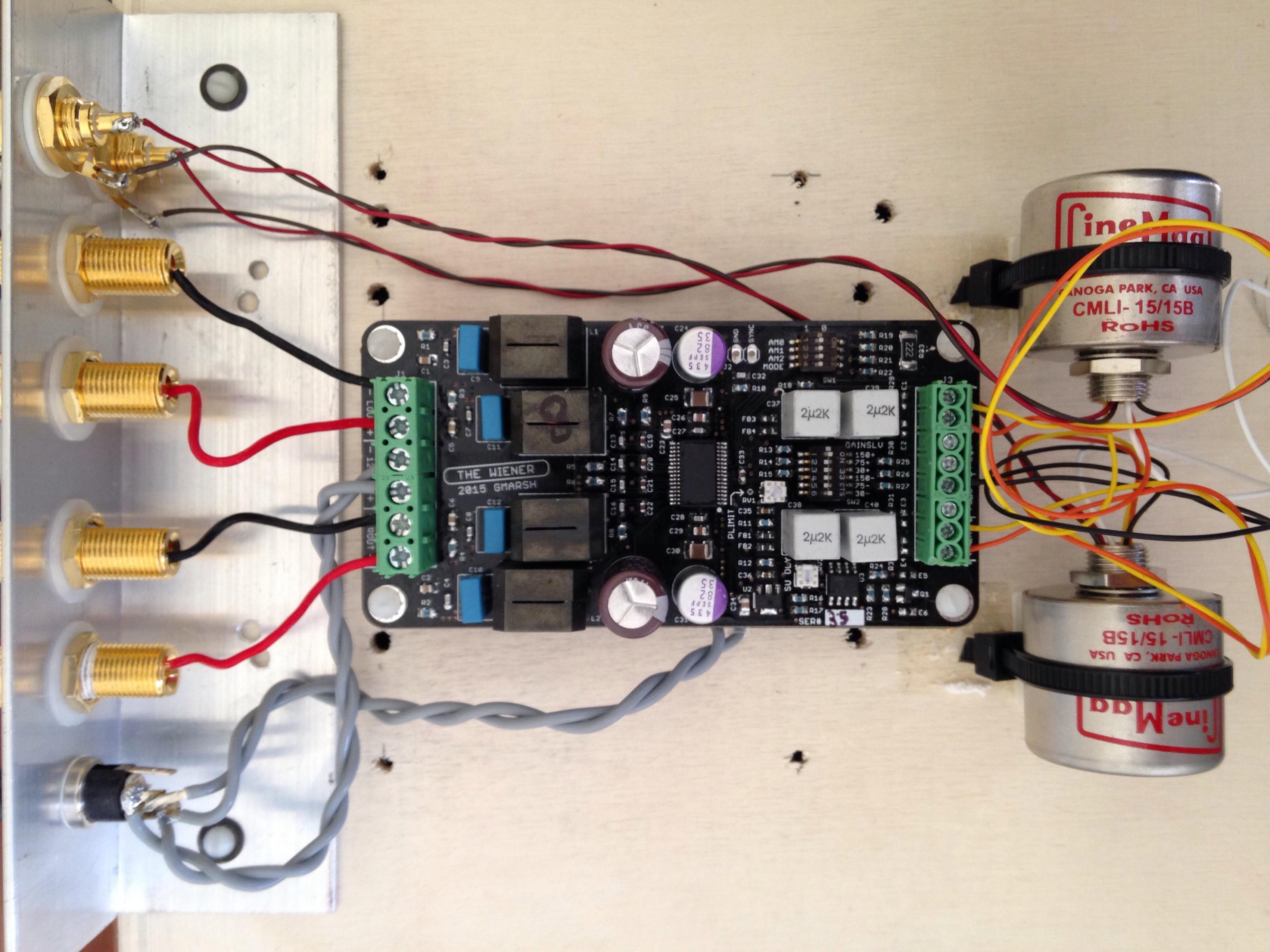

Finally got my "Weiner" amp connected. I am using the same prototype chassis that I used with the DUG PBTL amp, so I connected my CineMag CMLI-15/15B input transformers to the amp. It's still too early to draw any conclusions as to how this amp compares to the other TPA31xx amps I've tried, especially the DUG PBTL amps. I will say this: this amp sounds very nice and smooth. Gmarsh did a fantastic job building this plug and play amp set up for 8 ohm nominal speaker loads. I can't wait to play with switching frequencies. I will also try this amp without the CineMags at the inputs, but I just had to give them a try, right?
In the photo, the second pair of DC power wires are insulated at the ends and tucked underneath the amp. The ground wires from the transformers are connected to the ground terminal next to the Standby terminal. There is absolutely no hum. I have to have my ear next to the midrange and tweeter horns of my efficient Klipsch Forte II speakers (8 ohms) to hear a very faint buzz that I cannot hear from my listening position.

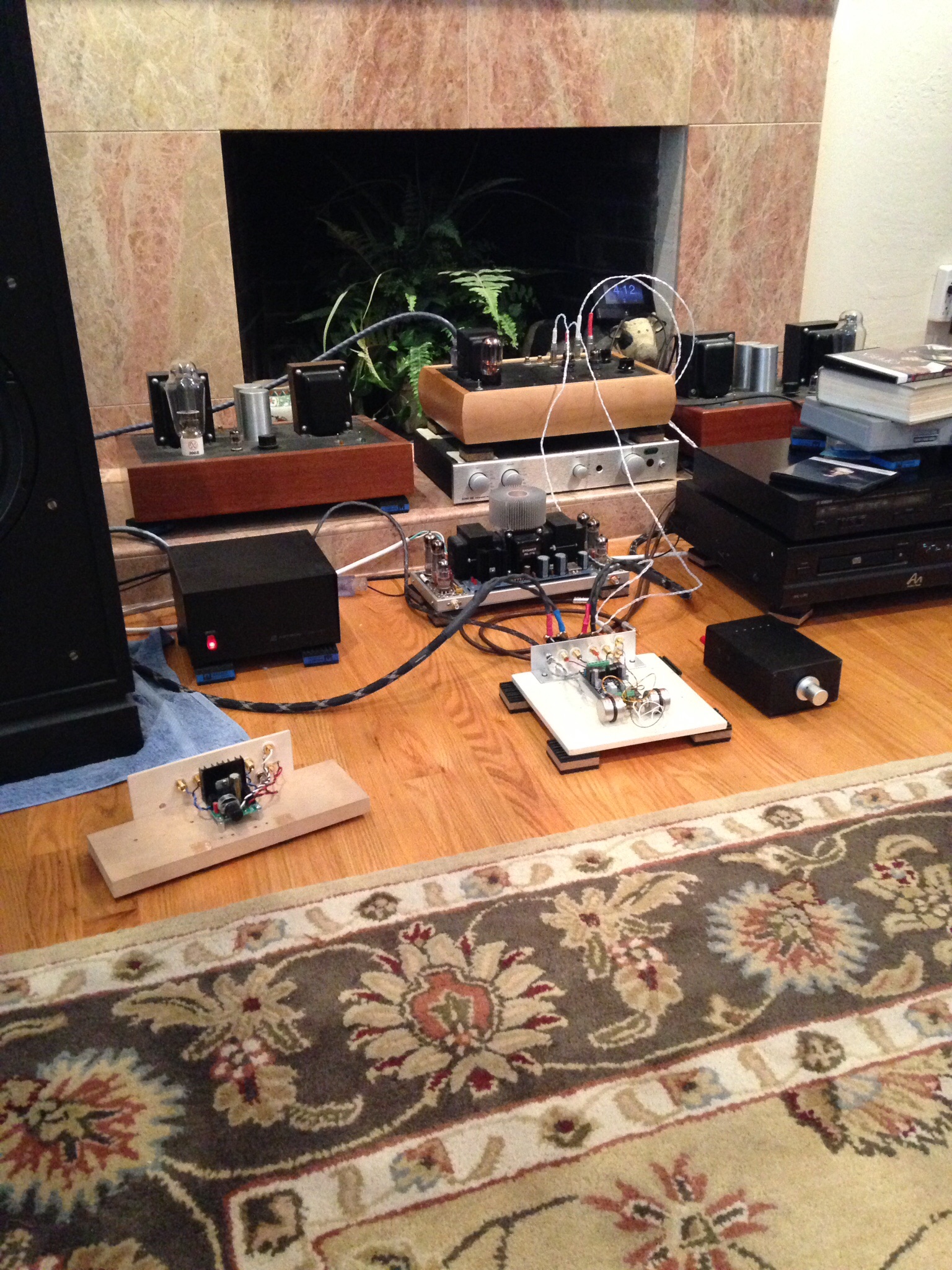

Yesterday, I went to a buddy's house across the Bay to listen to a few amps including a couple TDA7297 Class AB chip amps and the Weiner amp. My friend has a pair of modified Klipsch Forte II's similar to mine. He has a DIY EF86 tube line stage he built at a class at the Randall Museum in San Francisco several years ago. The TDA7297 amps we tried sounded very good, but when we stuck the Weiner amp in my friend's system, he fell in love with it. It just sounded so refined, and he felt it was in par with his more expensive tube amps. With the Weiner, the sound quality was really engaging and we listened to many challenging tracks. To my ears, the bass response is every bit as good as what I remember hearing from the DUG PBTL amps. What's impressive is the midrange tonality and extended highs without any annoying brightness. Now a few of my friends want to know when the next group buy for the Weiner will take place.
In my own system, the Weiner sounds great. I just made a 1.5m pair of interconnects using Belden 8402 microphone cable and Switchcraft 3502AAU RCA connectors to connect my ARC LS7 line stage to the Weiner. I've been enjoying this setup so much, I haven't been too motivated to try the amp without the CineMag input transformers. I agree with eric777 that this is one of the best sounding TPA311x amps I've tried to date.

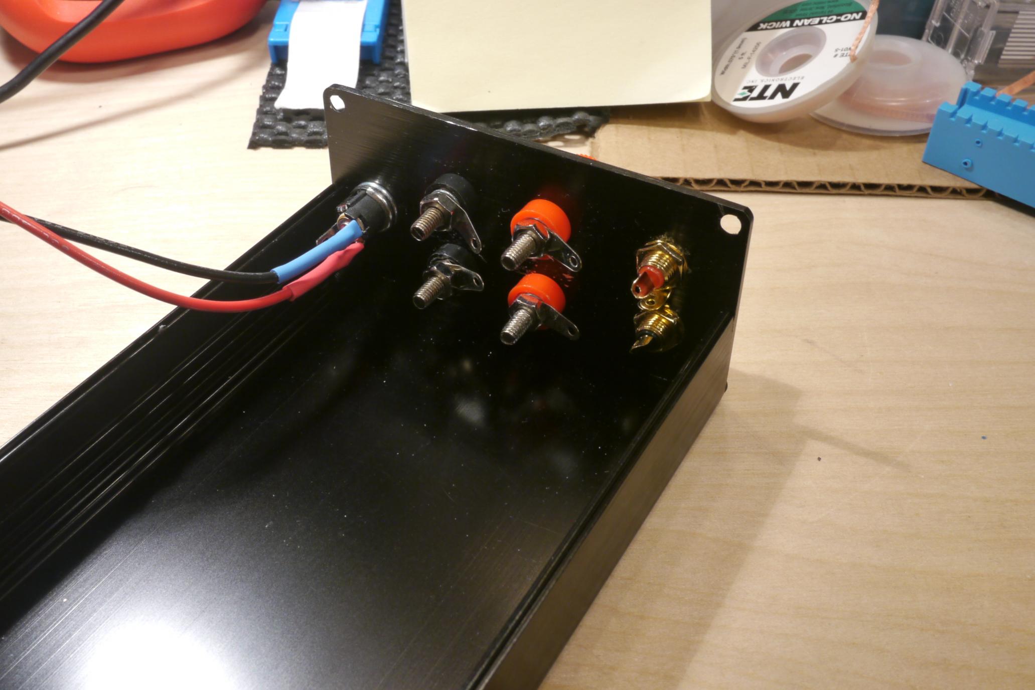

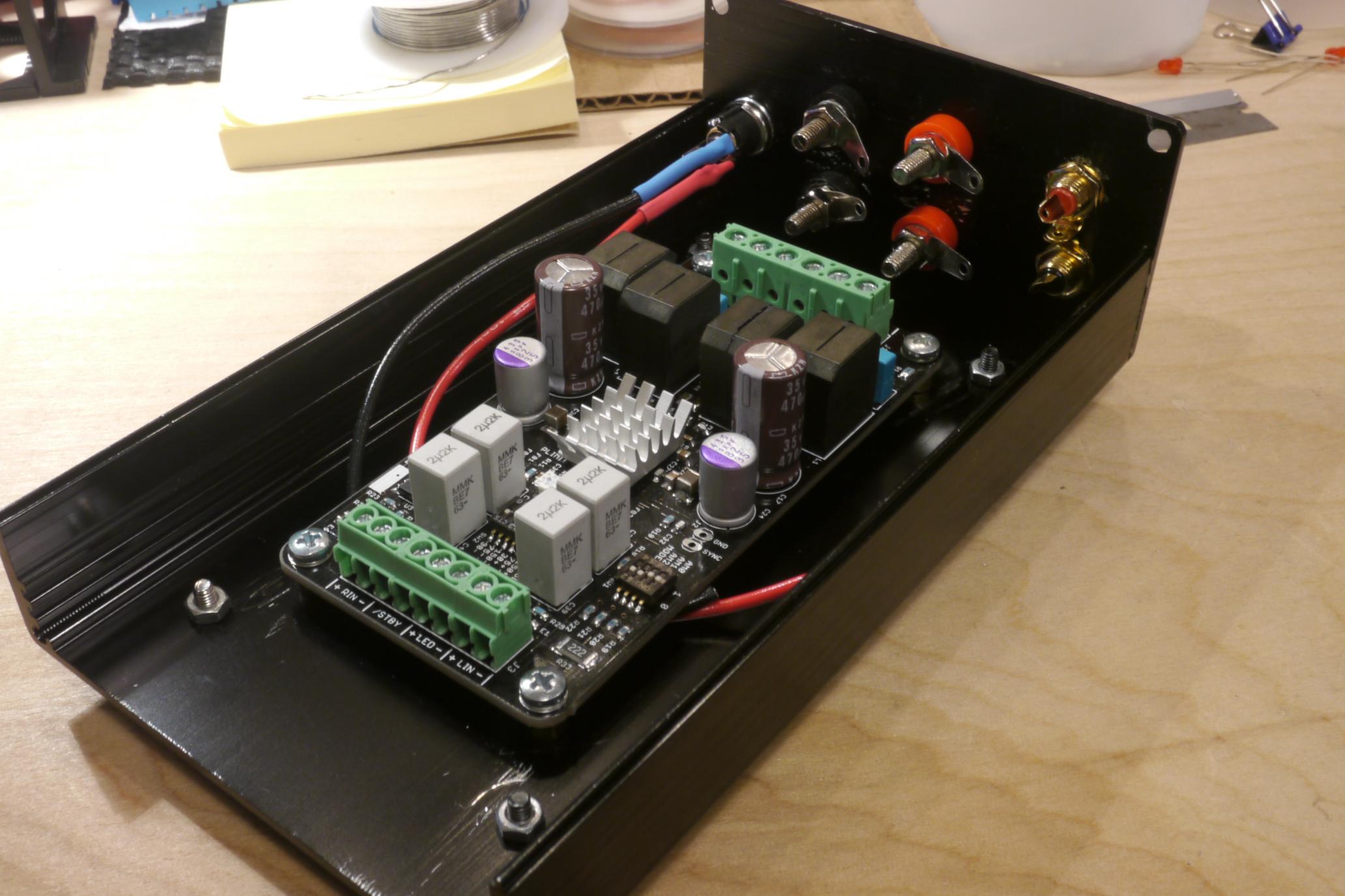

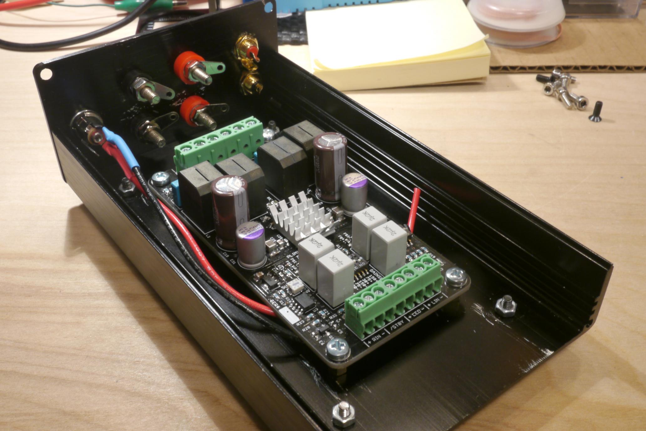

Here are a few pics of my 'Wiener' under construction. Nothings really special, just integrating everything. Will have a power switch and volume control on the front. I'll also be using a 19v power brick rated at 4.5amps. Will share more when it's done.
Rick
Rick
Thanks for mentioning that Gary. I've checked the continuity between the HS and all the nearby caps and TPs on the underside of the board. No shorts. There are a couple that are close to the HS, but they are not touching, so I should be okay. I haven't fired it up yet, but will check everything out before closing it up.Be very careful not to touch the decoupling caps around the TPA3118 with that heatsink.
