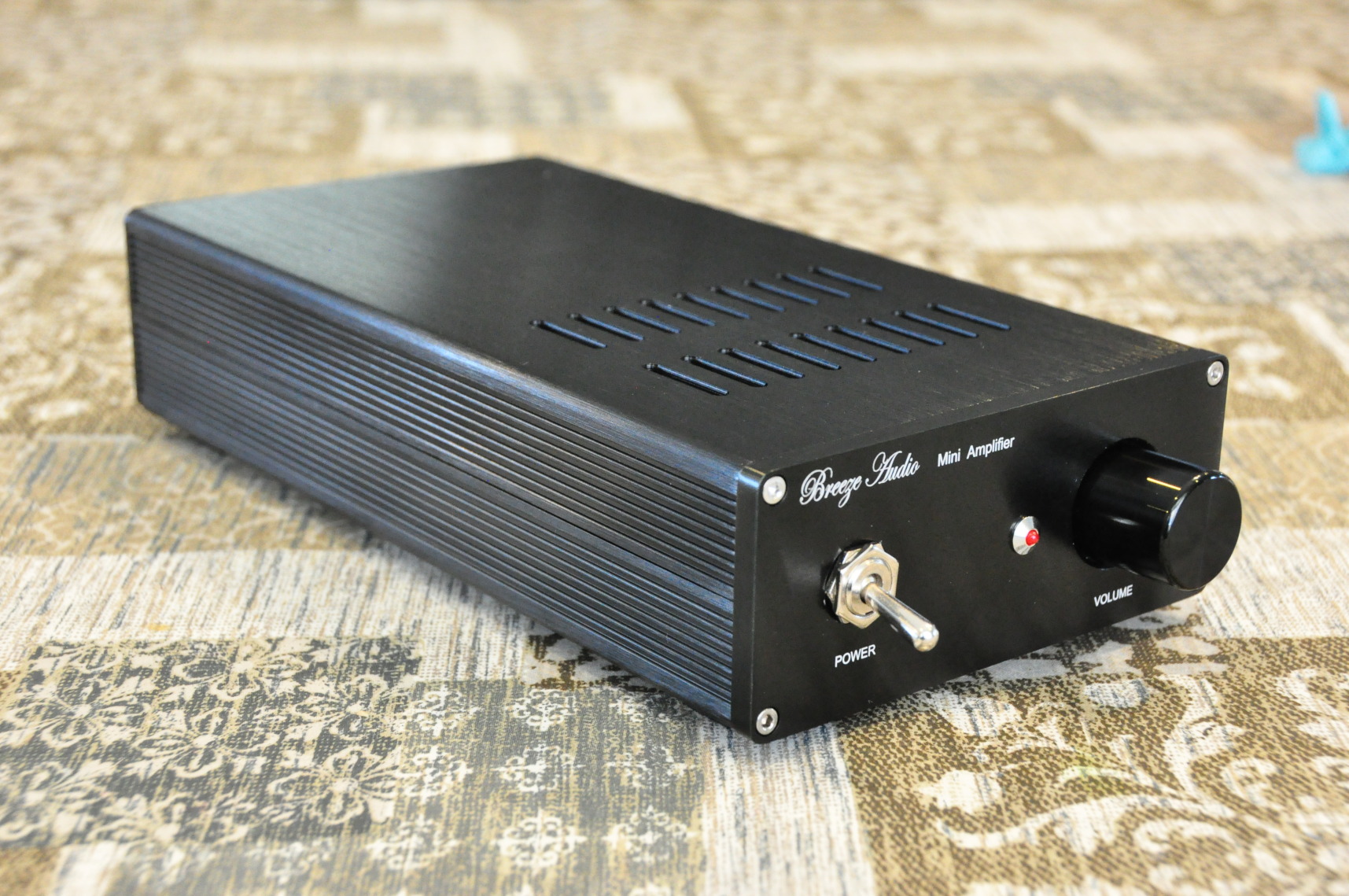

Here's some "amp porn" for those of you who are into it. I finished this up last weekend, haven't had a lot of time to do any detailed listening yet, but initial impressions are extremely good. I guess I do need to jumper one of the - inputs to ground, as I have some hum coming through. Interesting thing with the hum: I'm using a stepped attenuator for volume control. The hum is barely present with the pot at max resistance (50k), gets louder with increasing volume (i.e. decreasing resistance), then totally goes away when the pot is completely open. Initially I didn't notice the hum (see earlier post) because I didn't have the pot wired in, and was using my DAC for volume control.
Anyway, a rundown of the build details for anyone who's interested:
Note my lovely glob of hot-melt glue on the attenuator. In my infinite wisdom, I neglected to consider how the pot is mated to the chassis when I soldered up the wires. So the wiring protrudes from the front of the pot, making it not sit nice and flush with the chassis. I had also applied a big blob of hot melt glue to the wiring before I realized this. So I spent time building up a "frame" with more hot melt to make the volume pot mate evenly to the chassis. It's ugly, I know. And after all that, the threaded part of the pot's shaft barely comes through the hole, so the nut holding it in place is probably one light tap away from falling off. Oh well.
- PSU: Connex SMPS300RS, customized to 20V output
- Pot: Ebay "DACT Type 21 Stepped Attenuator Potentiometer 50K" from seller lasercollection (current link). Learned about this from the "lunch money amp" thread.
- Chassis: Ebay "1306A full Aluminum Enclosure case/Power amplifier box/DIY chassis -sn" from seller sep_store (current link). Came with all holes (except for the LED) pre-drilled, which was nice. Though the speaker binding post holes were a wacky size, either too big or too small. I had to grind on them a bit with my deburring tool.
- Shielded wire for inputs, I bought that years ago from "John's Wire Shop" on ebay.
- Rest of the hook-up wire, RCAs, binding posts, and on/off switch came from Apex Jr.
- LED and it's current limiting resistor, PCB standoffs, and thermal pad all came from Digi-Key.

Somehow I knew people would have noise issues cause of the - input signal not beeing connected to ground. Thats why I wrote such I detailed description on how I connected my system up. Besides, nobody want's to take any chances with their "golden" amp I would also STRONGLY recommend starting the amp in 500kHz mode since that sounds far better than the stock mode it comes in. Just my 2 cents..
I should have been paying more attention to your connection setup.
I agree about 500kHz.

matt_garman, i really miss proper case grounding for life saving reasons?!
I'm not sure I follow you, can you elaborate?
The case itself is common withe the mains ground. The mains input on the SMPS board has three pins (earth, live, neutral). The earth pin is electrically equivalent to the PCB standoffs, which are metal. (In fact the user manual for the SMPS300RS says to use metal standoffs for connecting to the case, presumably for this reason.)
So, for example, I can put my ohm meter on the case and the earth pin of the IEC and read virtually no resistance.
I believe this is correct, no?
