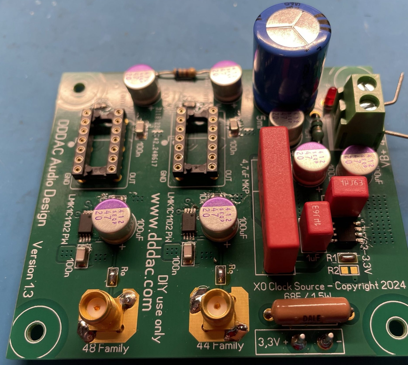

IIUC, Acko is using TP7A470x regulators for his clock oscillators. IMHO those sound better that LT104x even though they aren't as low noise.
I have also been using LT1763 and LP5907MFX-3.3 regulators, but with the performance somewhat tuned using load resistors to ground. For LT1763 there is a low noise mod for them that dddac mentioned in a post in the clock board thread. With both of these regulators I use MU caps for input and output. They aren't as low ESR as other caps, but IME they are more linear. IMHO the linearity can be more important in some cases than low ESR and ESL. Depends on the particular circuitry. For very high speed digital logic, or maybe even a dac clocked at 100MHz, it might turn out to be very different.
I agree with Mark - you can read the post on the LT1763 mod here:
http://blog.dddac.com/dddac1794-mk3-on-board-regulator/
@dddac, IIRC, I did try many years ago with increased bypass cap on the LT1073 (100n, I think) but load regulation or output accuracy @3.3V fixed type was poor. Contacted LT support and they advised the bypass cap was too large and when changed back to 10n , all good. Interesting to see yours all fine with even larger cap🤔
You are Right, i published the measurements…. I did not test accuracy, as it is not important for the application, output impedance has improved. Load regulation as in sharp load jumps are also not so relevant for a constant DC current application imo@dddac, IIRC, I did try many years ago with increased bypass cap on the LT1073 (100n, I think) but load regulation or output accuracy @3.3V fixed type was poor. Contacted LT support and they advised the bypass cap was too large and when changed back to 10n , all good. Interesting to see yours all fine with even larger cap🤔
With respect to ideal linearity, do you all have a view whether the Salas Ultrabibs would fit that profile vs. the low noise LT3045? Mark, you noted you compared your supplies against Tentlabs shunts in the past.
Shunt regulators can sound good and have useful Z-out vs frequency characteristics. However, the final regulators for some clock related circuitry should arguably be close to the load devices and on the same ground plane. IOW, a final regulator on a separate board probably would be too far away for best results. Whether or not a RF LDO (LDO with wide regulation bandwidth extending up into RF frequencies) is needed, IMHO depends on the overall power distribution system (PDS) design. Regulators don't necessarily have to be as fast as the circuitry they supply power to, and for very high speed circuitry that's impossible anyway. (There are no RF LDOs with regulation bandwidth extending up into high GHz frequencies. Therefore the PDS for those systems is designed to work well with slower regulators. IOW, it's all doable.) Also, bypass caps peppered around a board to lower power plane impedance sometimes can only be operated above self-resonance, but they still help keep PDS impedance low anyway. Power plane capacitance to adjacent ground plane layers also helps to control PDS impedance as seen by load devices. https://www.sigcon.com/Pubs/straight/resonance.htmWith respect to ideal linearity, do you all have a view whether the Salas Ultrabibs would fit that profile vs. the low noise LT3045? Mark, you noted you compared your supplies against Tentlabs shunts in the past.

I tried a few different approaches to power supply with Andres clocks and IMHO found it not all that impactful to sound quality. So in my opinion you would be hard pressed to find a difference in sound quality between LT3045 vs LT3042 in this application.
FWIW, I use a TPS7A4700 that I had on hand from another project with his 5MHz DRIXO.
^Agree about DRIXO oscillator relative insensitivity to PS. However, existing Andrea squaring circuits have issues with power, and with overall design. Same for the existing FIFO board clocking related stuff. Sorry, but that was determined by a series of experiments in the lab. Again, I already shared all the details with Andrea's colleague, Roberto. I'm pretty sure Andrea knows about too, despite his extended illness.
However, other clock modules such as Crystek and Iancanada clocks do show sensitivity to PDS design. Same for clock buffers and reclocking flip-flops.
That said, the above do not appear to be especially sensitive to phase of PDS bypass caps. IOW, they are not analog filters that need precision phase response in the filter sections (also to be clear, phase response is not the same thing at all as oscillator phase noise).
