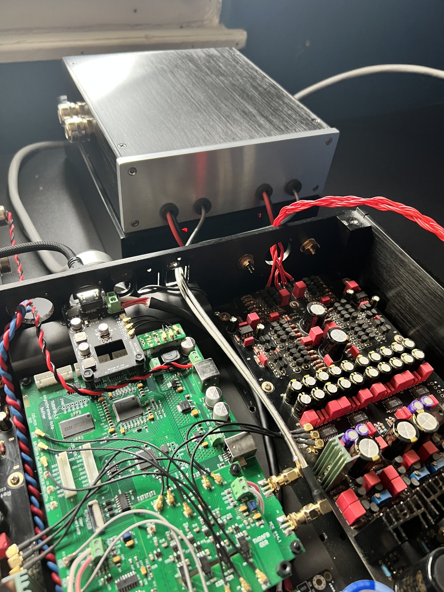

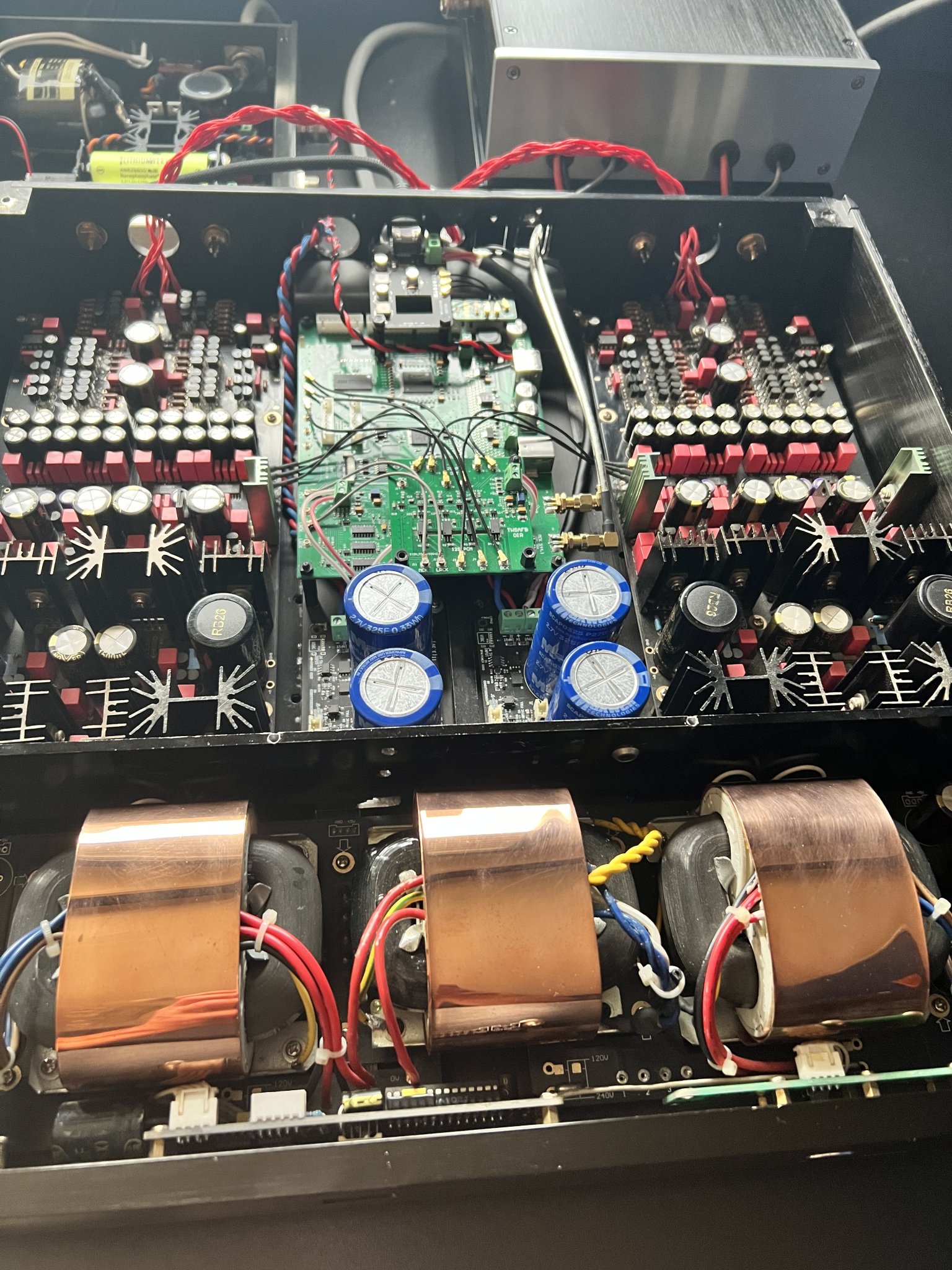

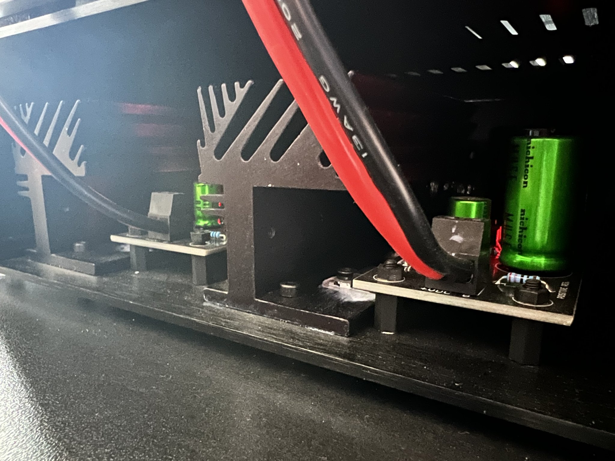

sebbyp to answer your question here is the rest of my system,
Dac Audio GD with FIFO Lite/DRIXO 5Mhz-6Mhz feed by Salas BIB3,the streamer is composed of a Raspi4 with PcP/Lms - Q7-DRIXO 11 and 12Mhz/SinePi/HdmiPiPro,the streamer has just been started,I plan to place the 2 DRIXO on a few centimeters of sand in closed a aluminium box,separation by copper and aluminum plates between the board,Pream Bryston BH1,Amp Modulus 286,DIY Speaker (http://francois.h.pagesperso-orange.fr/) Dynaudio Esotar 330/SEAS W21EX0018 with Mundorf L300 and Duelund cast Cu/Ag.
The last modification was to feed the HDMIpiReceiver with UcConditioner,it is worth it,good upgrade.

Wow, thank you for taking the time to post that. Great implementation of Andrea's FIFO into a retail product. I'm sure that made a huge difference 🙂 13 AWG wires and matched veneer on the speakers! It's the little details 🙂 I'm sure that's giving you visual and audio satisfaction
