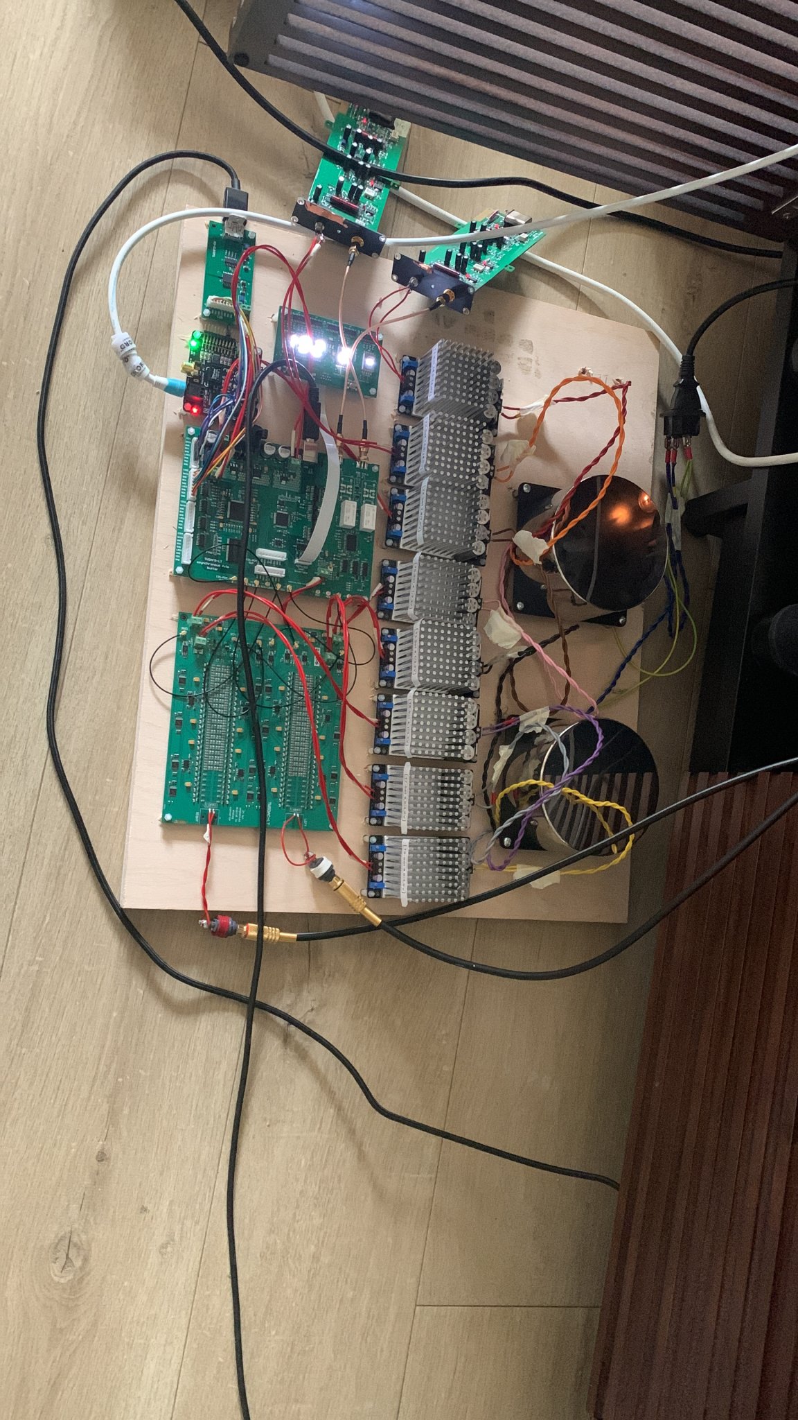

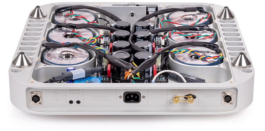

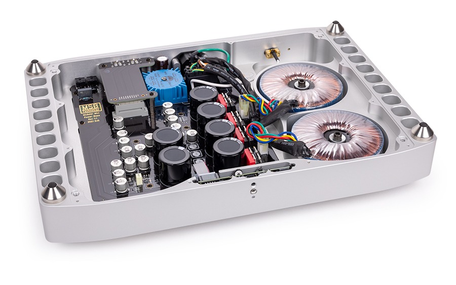

Hi pinnocchio,
See a possible audible problem or two in the pics. Be interested to read your listening impressions. Also would suggest to try a DSD dac board at some point. Should be able to plug into what you already have, for the most part anyway. IME RTZ DSD dac boards have a lot to offer.
Hi Mark,
So far the DAC is totally silent but I have not forgotten about the possibility to add the output filter, but not really needed so far. Also, if I have any EMI/RFI, I made it so I can easily add a steel plate/copper in between the DAC and the FIFO.
