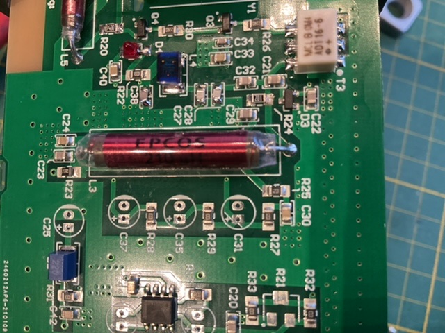

I had a problem with my first build. After consulting Andrea, he was so kind to help me finding the fault, I found one of the pre soldered smd resistors (r23 on the detailed picture) not to be soldered on one side blocking power supply. A drop of solder solved the problem and now it is working.
So, am I the first user with a working clock unit?
Happy soldering everybody!

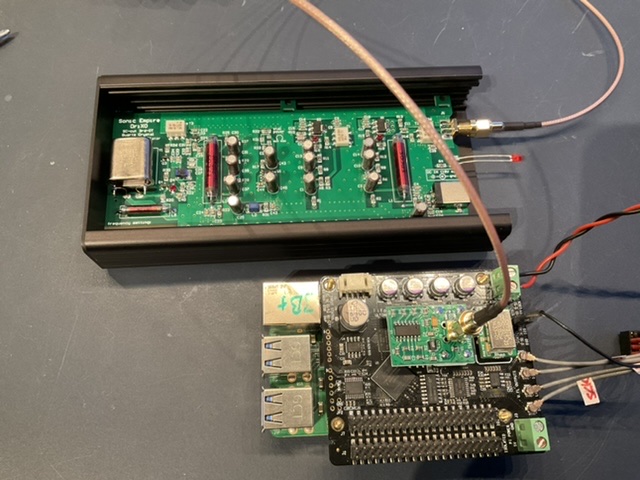

Andrea informed me not to use the oscon capacitors I had used, for it is not a digital circuit, it’s high frequency analog. So I changed them for Elna Silmic I had in stock.
The oscillator is placed on a foam pad for vibration dampening.

Hi Stefan,
thanks for your feedback.
I apologize for the pre soldering issue, I will inform the manufacturer to be more careful for the next batches.
This batch I ask those who have got the semi-finished boards to inspect them in order to understand if there are faulty solderings.

We have chosen the Nichicon UKL series because of its very low leakage current.
They have been used as filters on the base of the bjts so a low leakage current is needed.
The polymer type is very good for decoupling in digital circuits but they typically have much more leakage current, so they are not the best in an oscillator which is an analog circuit (indeed its output is sine wave).
I recommend again to use exactly the parts listed in the BOM (type, brand, size and especially tolerance).
