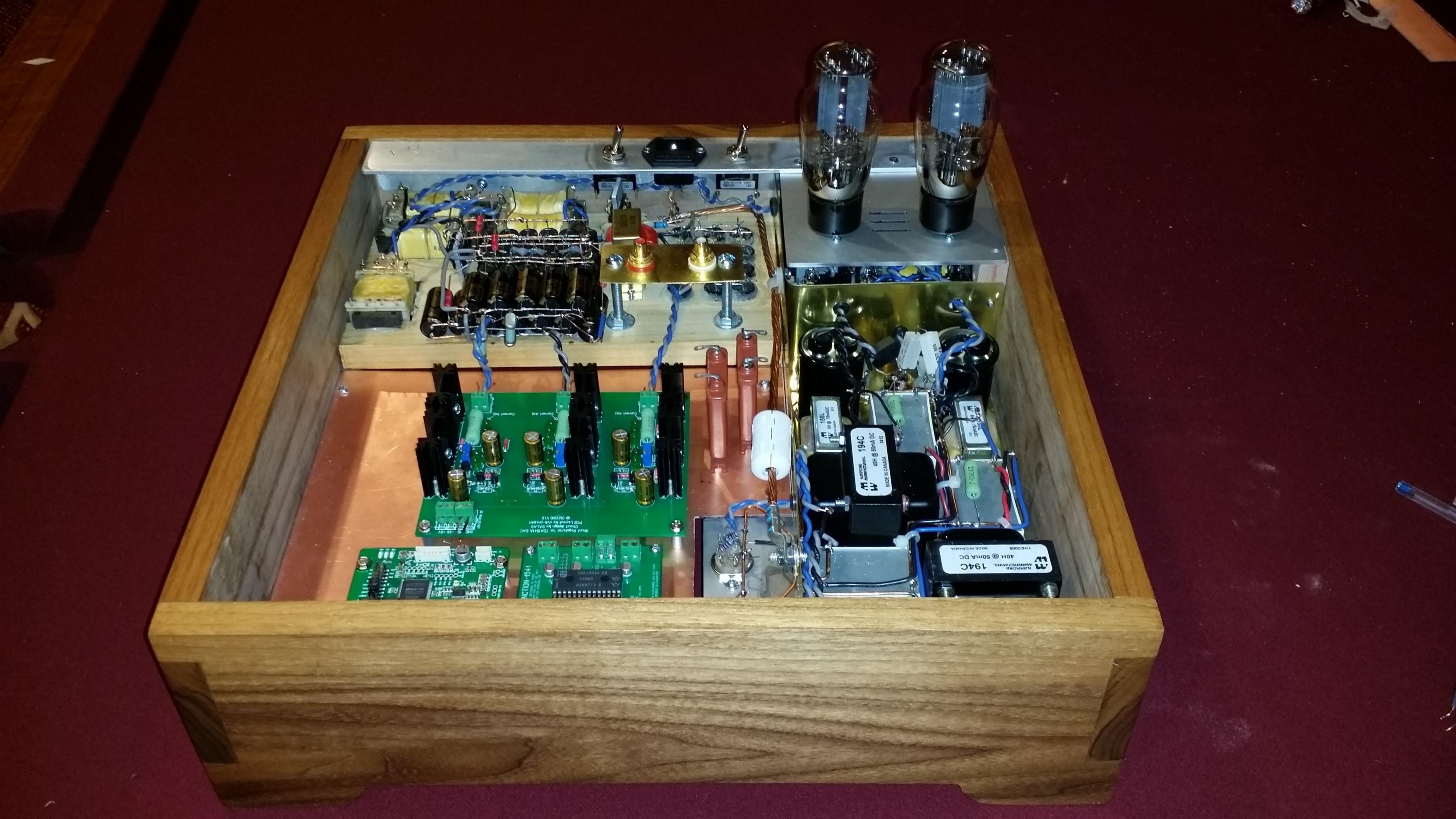

We continue to have similar approach. I did a tube output (6n2p point to point Lampizator design) with dual mono tube rectified(5u4g) with film cap CLCLC filter. I/V was simple resistor hand made from manganin. I think the square caps look cool🙂.

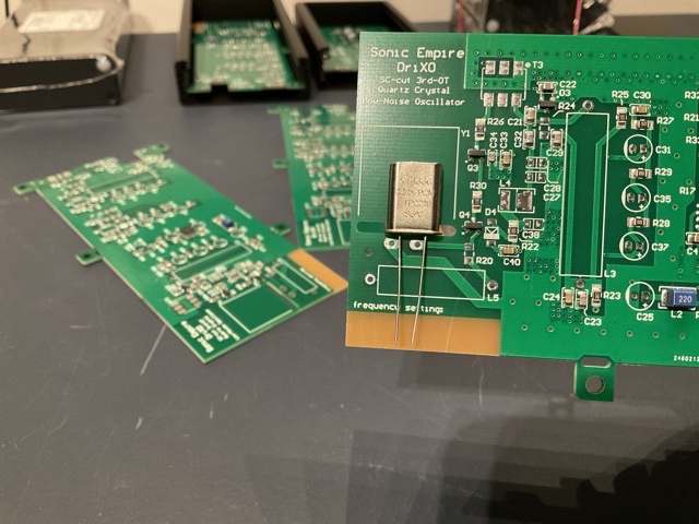

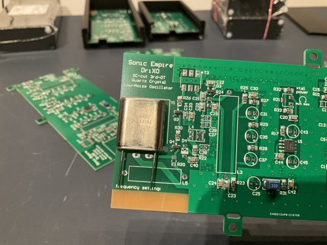

The semi-finished boards are arrived.
The finished boards should be delivered within the next week, the manufacturer notified a delay on sourcing some parts to build the TWTMC-STS and the TWTSTS-FSDO.
The transformer kits are arrived.
Crystals should arrive within the end of March except for the Sc-Cut at 6.144 MHz, Laptech has just notified a delay (at least a pair of weeks).
I apologize for the delay, I will ship as soon as I receive the items.

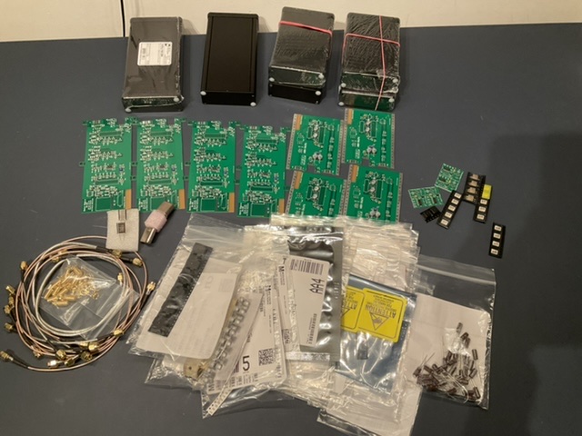

Yes! I received the clock boards and small size oscillators (I already had the big ones) from Andrea today!
The pcb’s look very nice, thick quality plates and should be easy to solder.
The soldering can start!

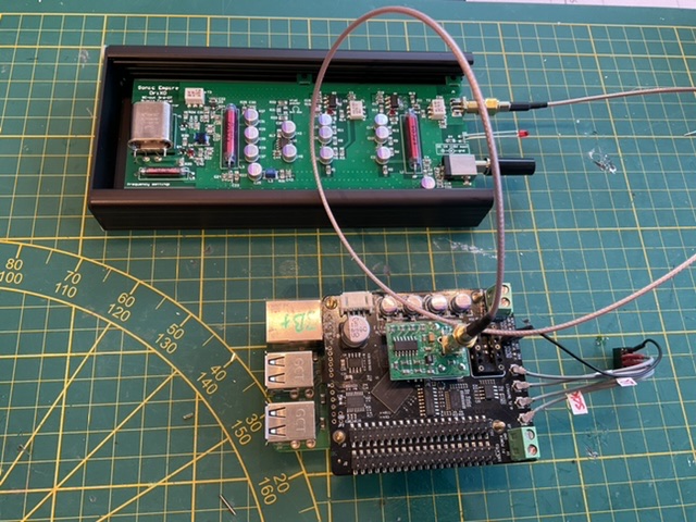

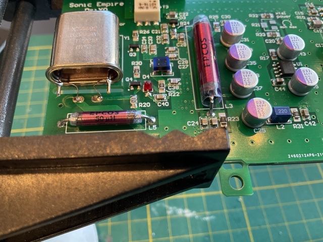

I soldered the first board this afternoon. I used Oscon caps for the ps lines.
Lets see if I can manage to bring it to life 😉
