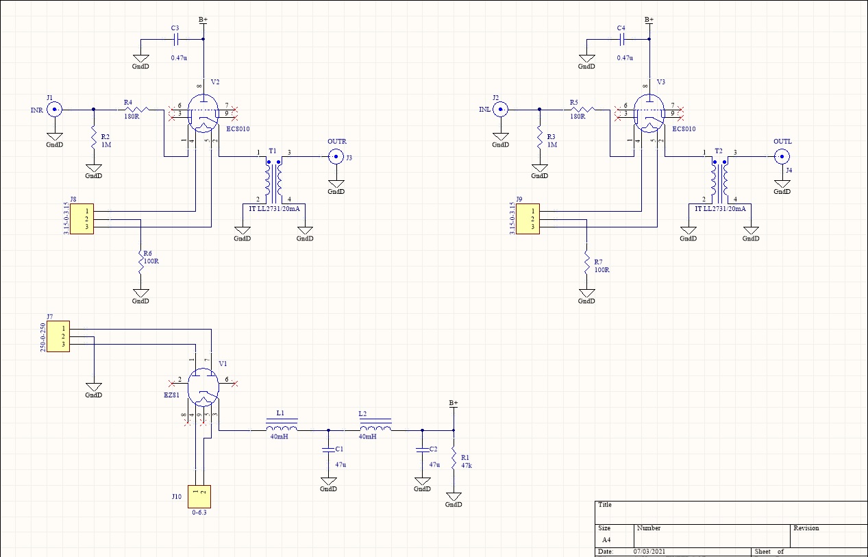

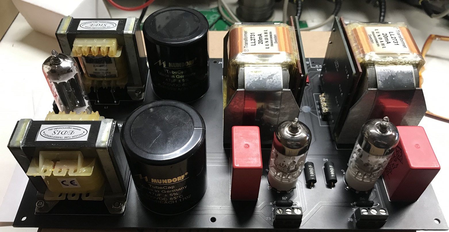

I attach a picture of the tube buffer I'm using.
Uh looking nice and clean with the transformer pcbs.
Looking very nice! Nice choke loaded tube rectified ps.
What tube and topology are you using?

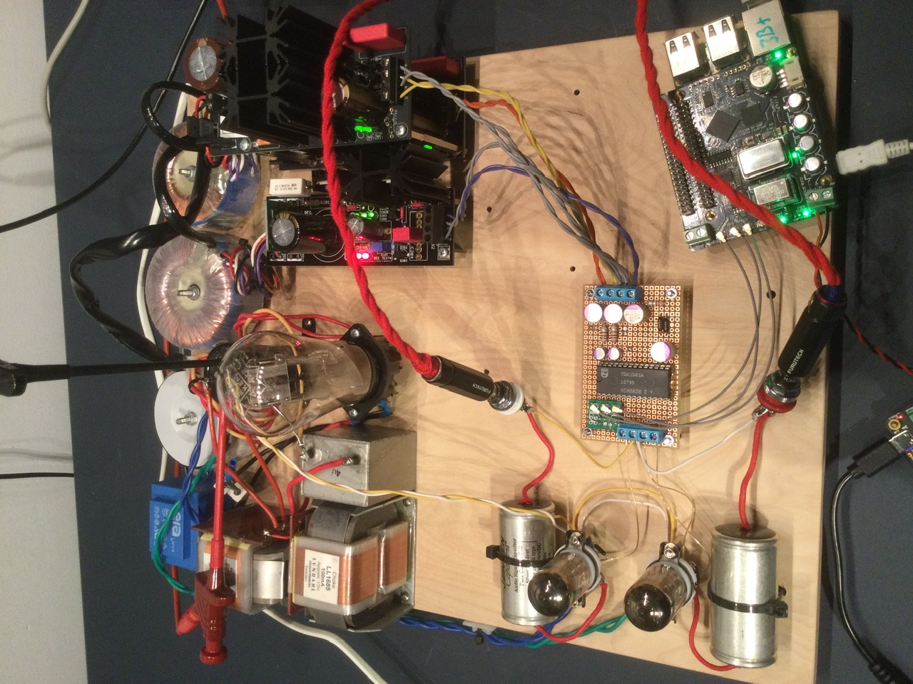

I just build this IV stage with 6n2p tube in srpp.
Hi Anrea,
is the output impedance of the discrete DAC that high you need an output buffer?
I ask, as a tube amplifier (even at gain = 1x) is a complex and expensive element in the whole audio chain and the sound of tube amplifiers can have very different characters.
That is why I like DACs with high output voltage with a passive I/V - it leaves it open after that to the user what follows (Transformer TVC, discrete or tube amplifier). An the user can decide what kind Parts he will use.
Hi Doede,
the output impedance of the DAC Lite is around 400 ohm so it can be used directly without any buffer.
The user can decide whether to use a buffer or not, and if so he can use any type of buffer (vacuum tube, bjt, jfet and so on).
I prefere vacuum tubes so I have built such kind of buffer.
Moreover it's a cathode follower so it should not add anything since there is no voltage gain.
