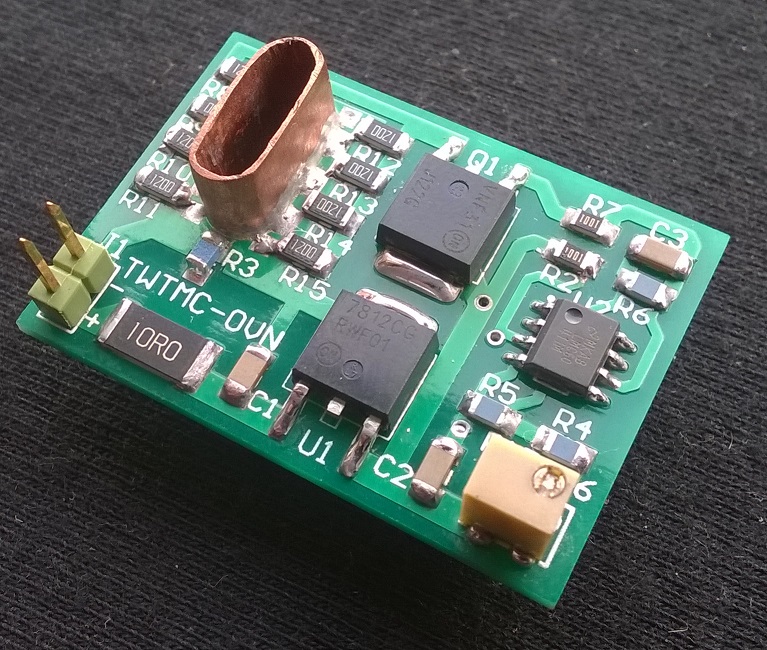

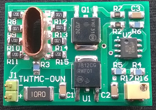

Waiting for SC-Cut crystals, the oven is ready.
It keeps the crystal at a constant temp around 82°C.

Nice one Andrea, expect a more refined finish of the copper tube for better thermal conduction.
The tube that fits the crystal is made starting from a round copper pipe for conditioning and pressing it using a vise.
To get better refined result it should be made by a milling machine starting from a copper solid bar.
I have asked some manufacturers, but they ask high MOQ and high price.
I attach the drawing of the copper tube, all dimensions are in mm.
Maybe someone could ask his local manufacturer to get a quote.

The tube that fits the Crystal is made starting from a round copper pipe for conditioning and pressing it using a vise.
To get better refining result it should be made by a milling machine starting from a copper solid bar.
I may be able to help on this.
Andrea please check PM

Now this gets complex-
The SC crystals flat temp-freq response range is around 80c. At room temperature it changes frequency more than an AT cut.
Crystal ovens are really much more complex and involved than this implementation. There is a whole art to temperature stability and they get better than .1c stability, sometimes much better with double ovens and very carefully controlled "leaks" etc. This will get the crystal to a good enough temperature.
If the goal is low close in noise the frequency shifts from small temperature shifts are exactly what you need to avoid. Absolute accuracy is not needed for audio, just short term stability (ppb per hour).
The higher Q of an SC crystal should have lower phase noise which is the justification of this effort.
Why should you? The absolute frequency is not important at all!!!! A frequency deviation of even 1000 ppm is not detectable for the human ear.
SC-Cut crystals are calibrated to operate at high temp, since their inflection point is around 80-90°C. Although in audio we don't care about absolute frequency and long term stability, I don't know if using an SC-Cut crystal at lower temp (say ambient temp) affects the short term stability and the phase noise of the oscillator.
BTW, everyone is free to use SC-Cut crystal with or without the oven. The oven is a separate board that fits the crystal of the Driscoll oscillator.
