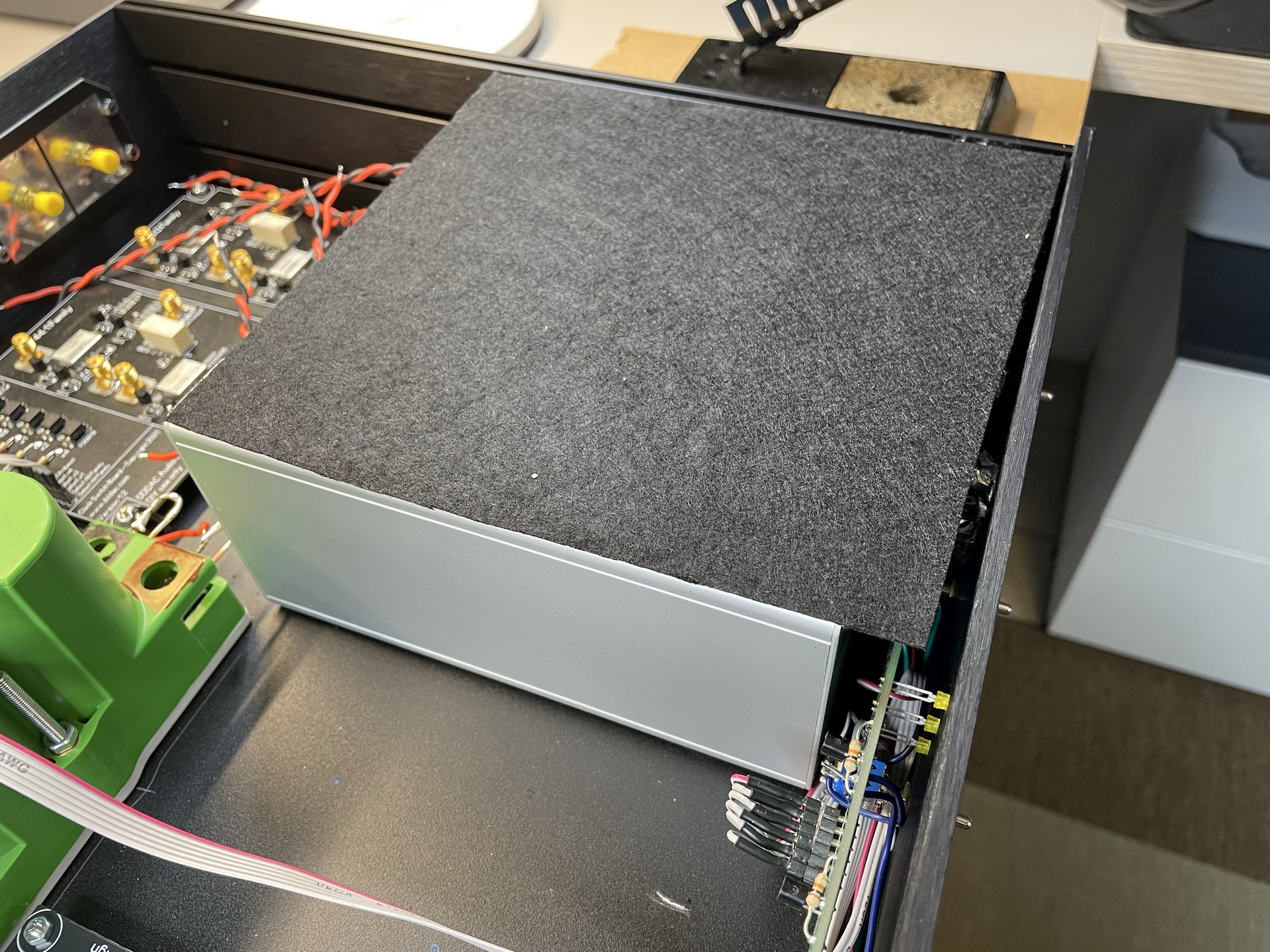

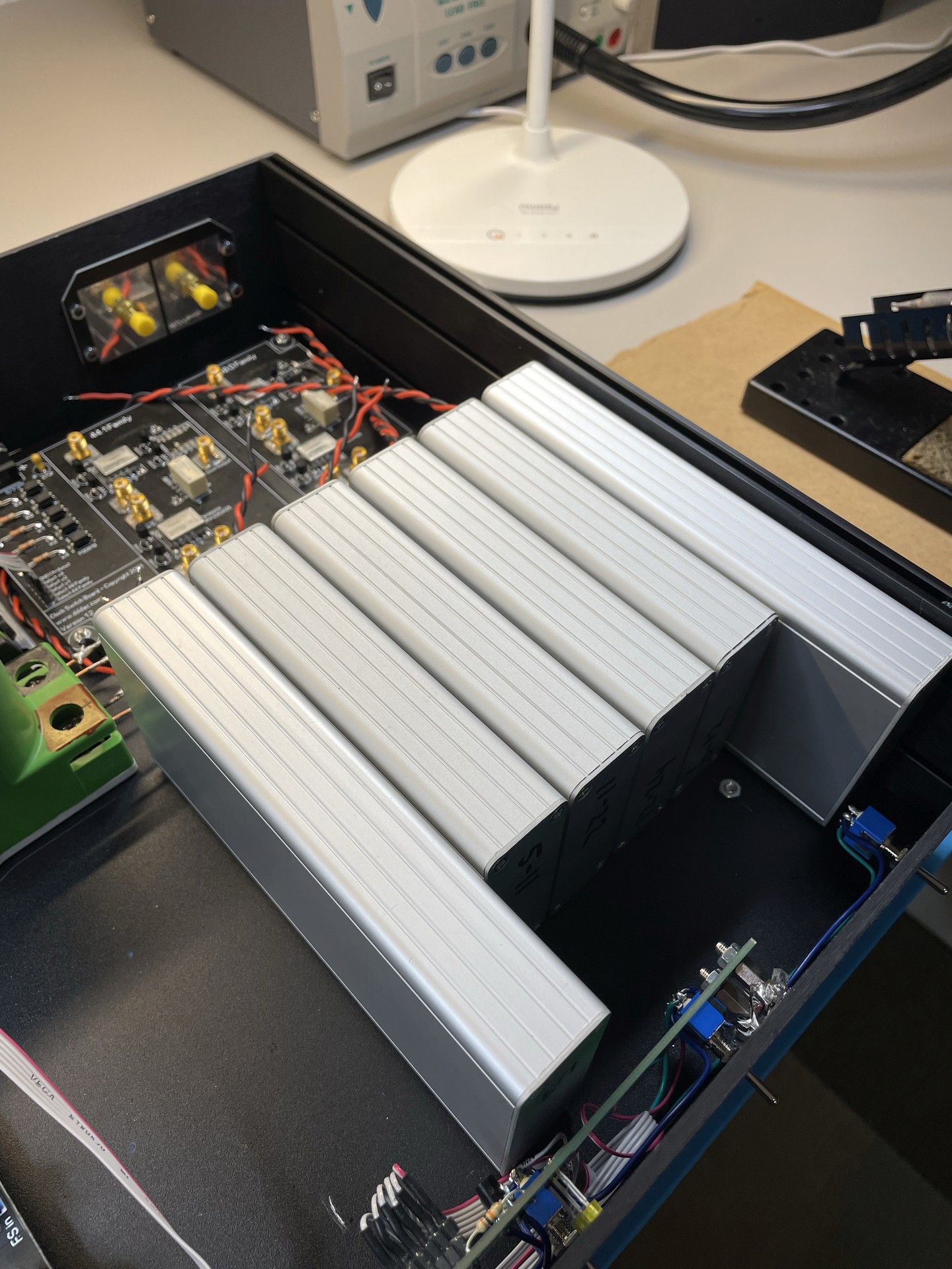

Just a few pictures of my progress on the Clock Switch.

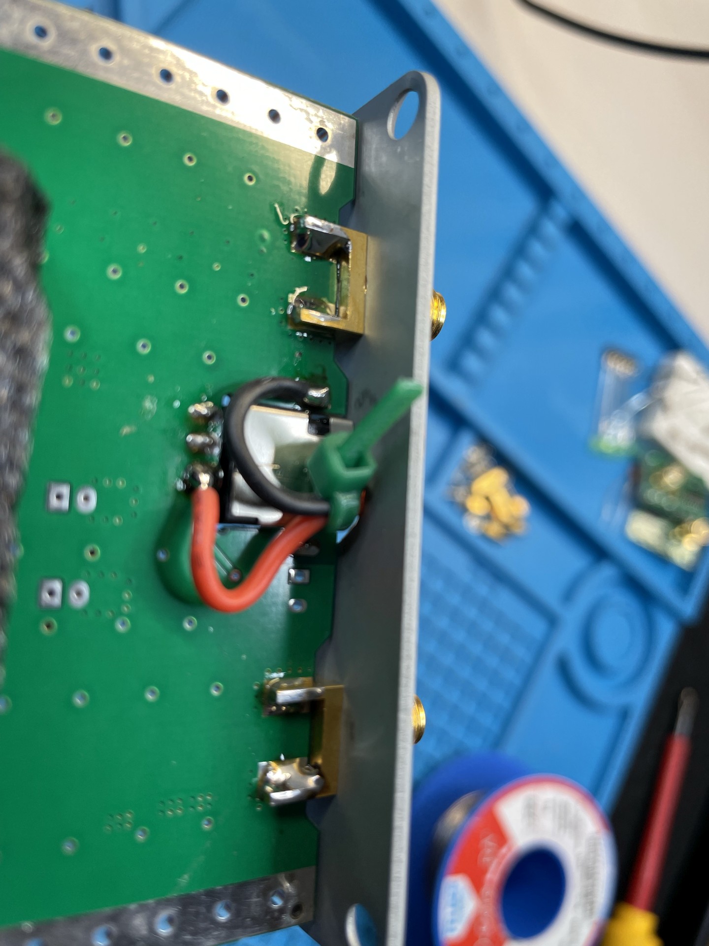

I have now put the clock and doubler boxes in the chassis. I decided against using the power plugs. It is all so close and fragile, i was afraid if anything makes a short the whole fury of batteries and Ultracap will discharge through that point. So I decide to make a solid soldered power connection. In the pictures you see what I mean.... also feels better to have a solid connection than with a small plug anyway.
Final steps are the FS cable connection and making the connections in my DAC where the Sine-PI will sit on the FiFoPi...
I had some feedback in the meantime from other clock owners, that indeed it is positively audible when playing Redbook (44.1) and the doublers are not in series with the clock.
Absolutely right if you see the terminal on the Eaton cap and compare it to the tiny plug on the Italian circuit it looks a bit strange. This tiny plug is nice for an external hard disk.
It is true once it is inserted and hidden inside a chassis it will never just disconnect but the way Doede connected it will remain a good contact forever and will be a better one right from the start.
Of course using a tie rap as a kind of strain relief is a bit so so.
I am sure there is a better solution. There is enough space to add a real kind of strain relief by just adding one extra hole close to the original plug.
