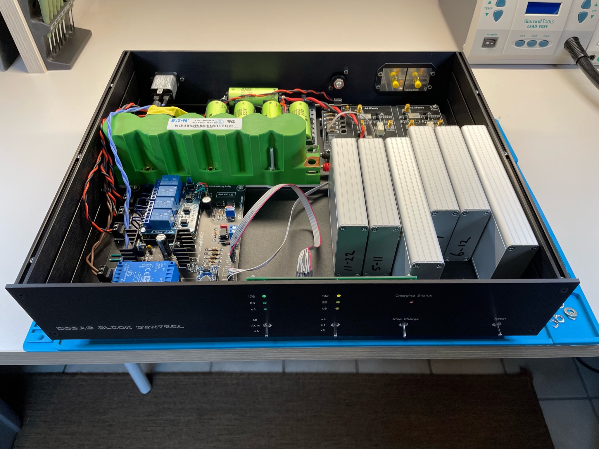

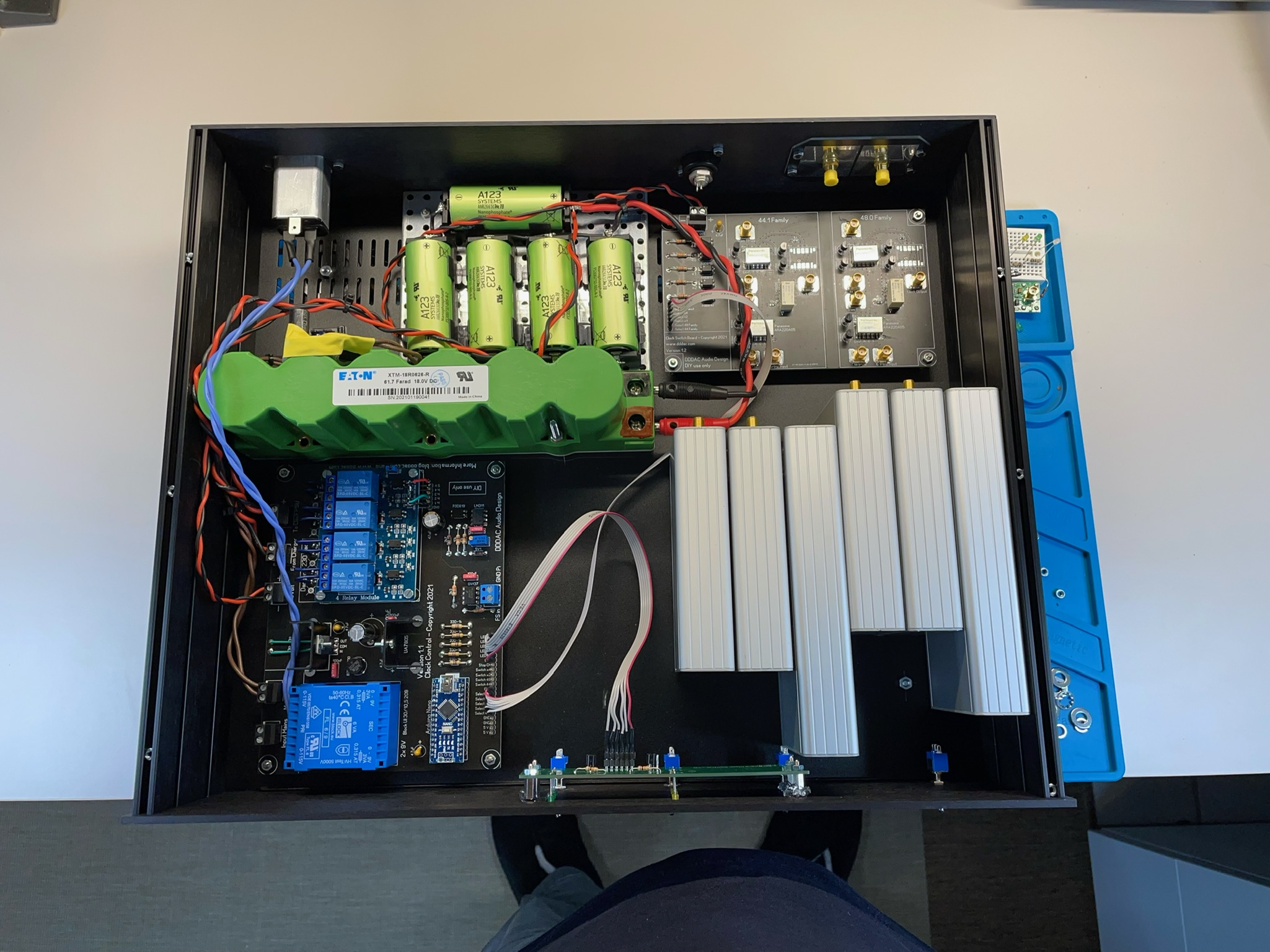

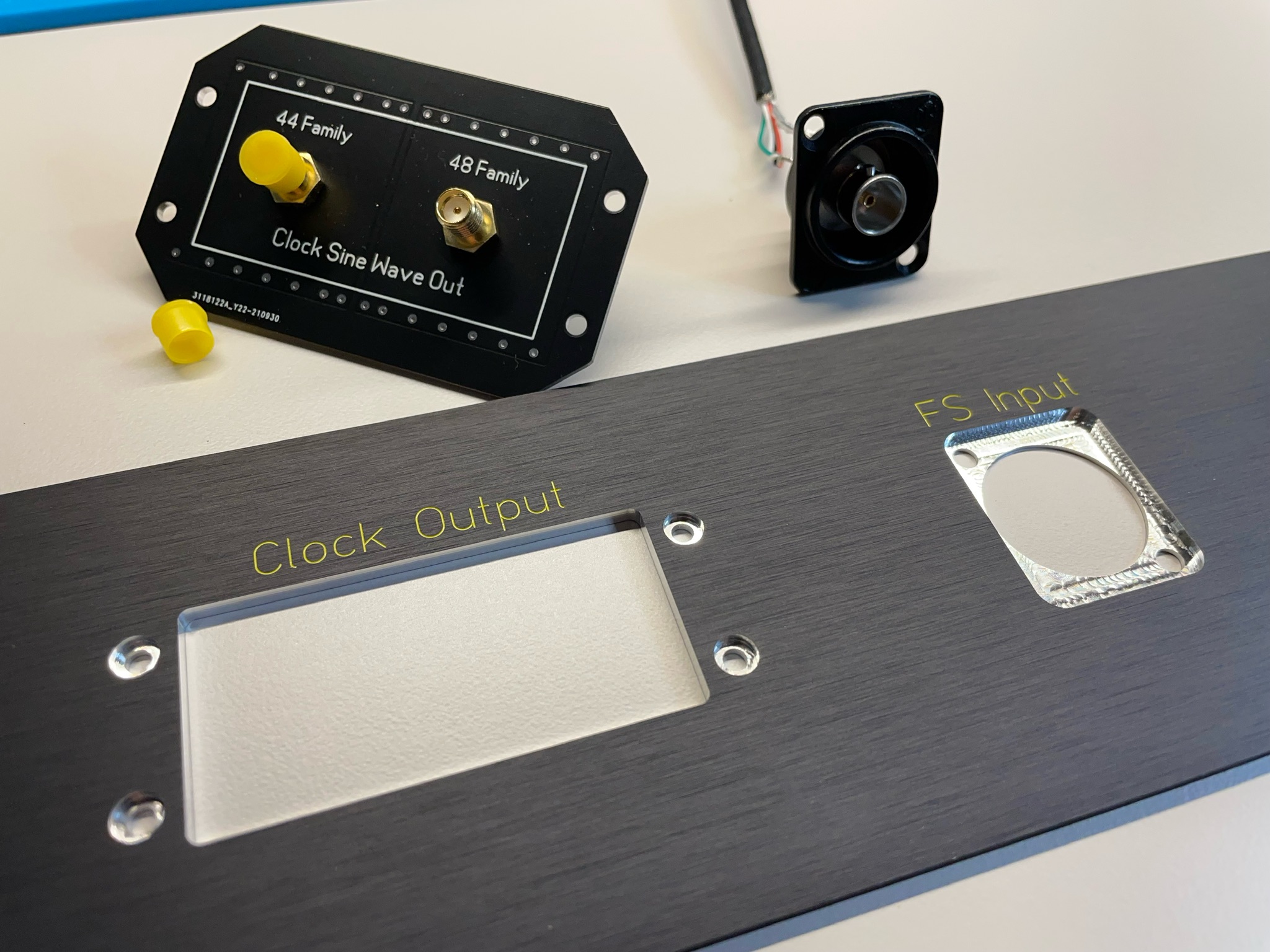

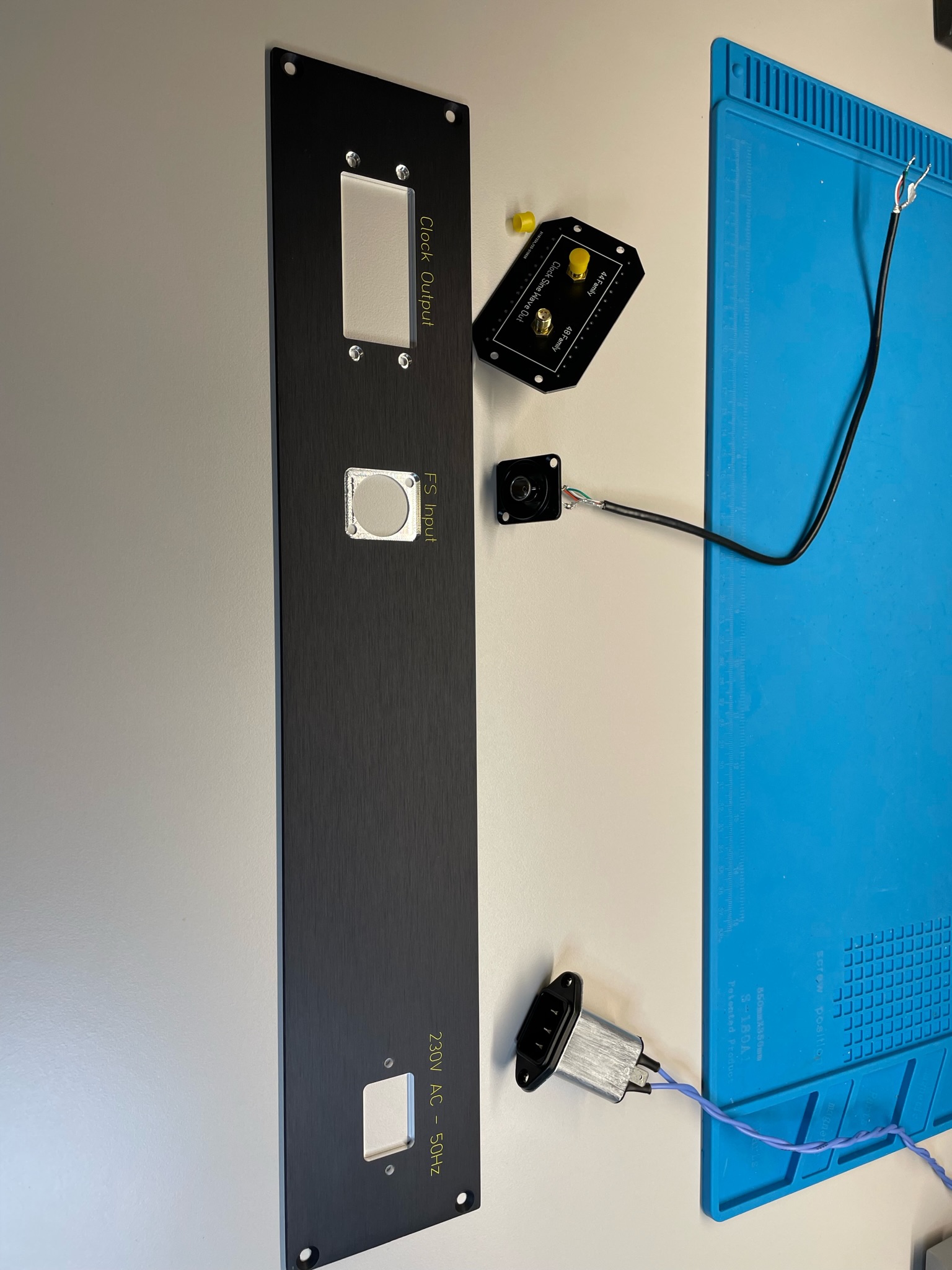

I thought it might be good to show again what this post was about. The Andrea Clock and our nice hobby of creating something individual just for us to enjoy 😎
The panels came back from Schaeffer and I constructed the base setup. Only thing left is the cabling and making an entry at my DAC…
With this, when playing for example 44.1 tracks, I would be able to tell if I hear the difference between straight 5,6MHz clock or with the doublers in series.
Just wanted to share this to make the thread again what it should be, talking about audio DIY 😀

Hello,
True diy is also about deciding which things to be done by professionals like you have done for the '' metalwork ''. This not only for the looks but MAINLY for creating things that can be moved around without having to check if all the connections are still ok after doing so.
With coke can seized ultracaps you dont want a short circuit. Even the 300F ones are able to destroy some surrounding parts.
Usually when these things happen people wont tell us because they have been warned to pay attention to make a kind of '' sturdy '' construction .
Greetings, Eduard
P.s Your camera even did capture your belly.

Nice work, looking forward to hearing more about this.
I have my clocks, doublers and switching board closed up in a case now with Supercaps supply and no going back.
Brought it to several Group meets here in Ireland and jaws drop as soon as it is heard when connected into an SD player switching over from NDK clocks.
Would be great to bring one of these units to HI END Munich next year and have a room where you could switch quickly from so called good clocks to Andrea's clocks while playing tracks from a stand alone SD Player.
The results of a button voting system on the door on the way out would be hard to argue against 🙂 🙂 🙂
Haha, nice idea… I will be of course at the Munich show next year. Renting a room will be probably beyond my budget. But still like the idea !
May be something for the Dutch hifi days …. When they will happen. If so it is normally February….
Nice work @DDDAC! I think there is an added sense of accomplishment when you pack your DIY project into a nice case to become part of the main sound system. Nothing wrong with it looking as good as it sounds and you have achieved that in spades.
